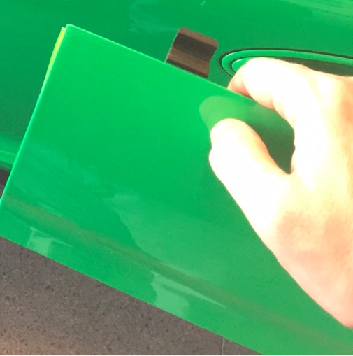

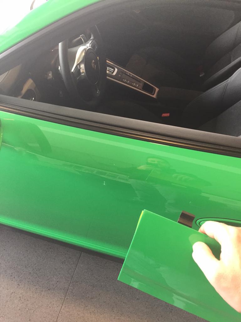

Here's a comparison between green (on the car) and signal green (sample). Too close to call IMHO.

Hmmm; looks like I need to get a spray can of signal green also. The two you show look very close. If anything, the signal seems to have a little more yellow in it.
