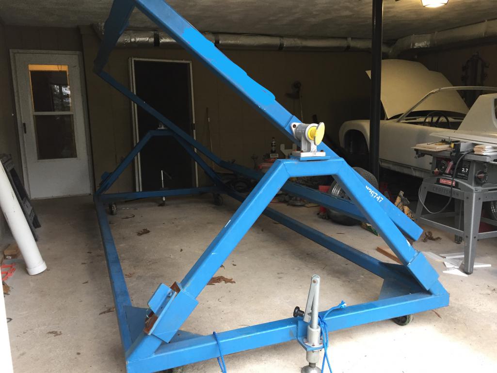

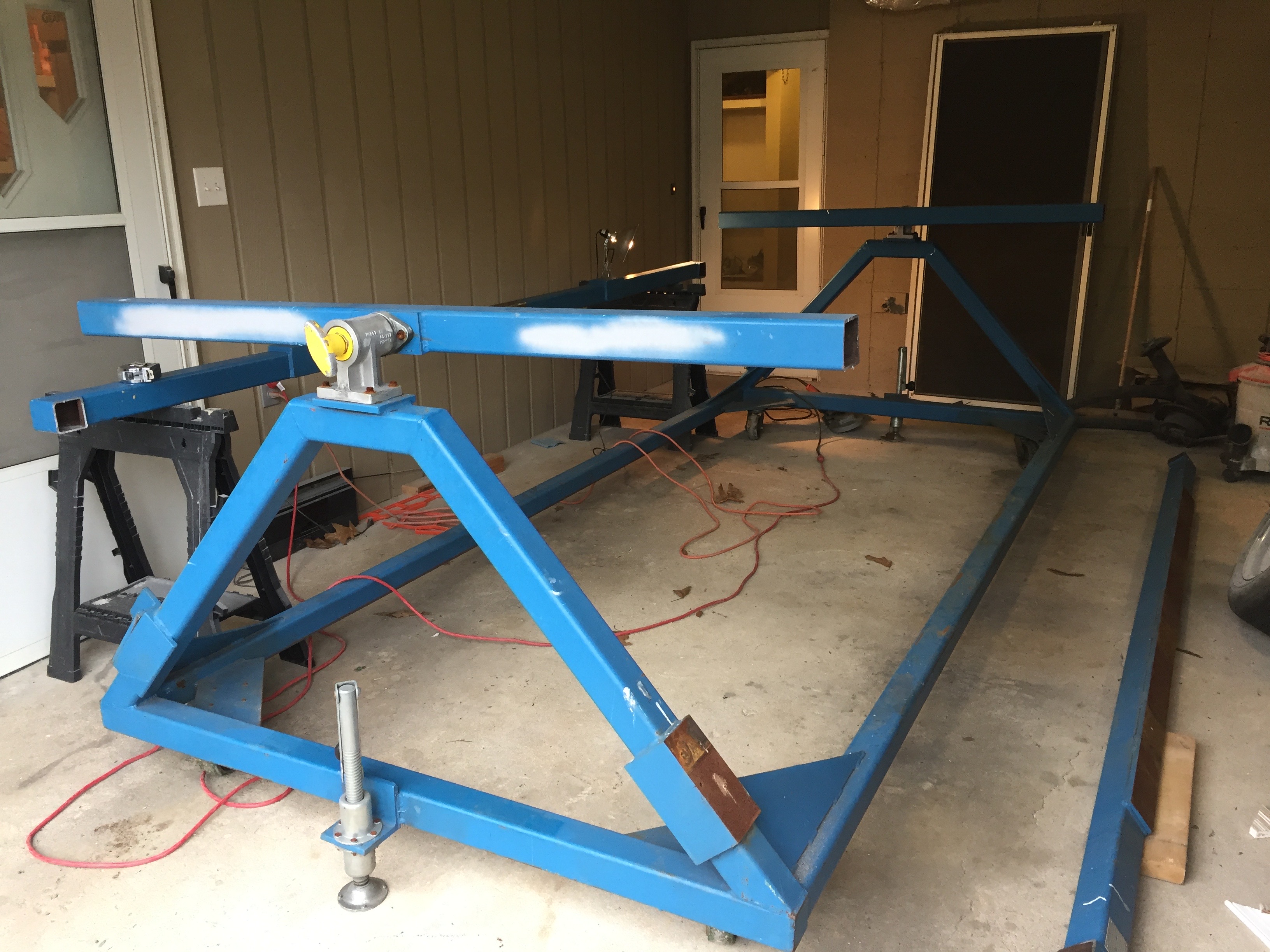

Time to build the rotisserie. I have a great starting point; it's a rotisserie built to assist with assembling aircraft landing gear doors - big aircraft.
So far I have cut the sides off of the rotating section. I plan to cut the sides off of the bottom also, and add a third leg and wheel to each end. Off to find a couple casters, and start welding. (IMG:style_emoticons/default/welder.gif)

Mitox   So, I've made some progress on the rotisserie....   Mar 2 2017, 08:54 PM

Mitox   I've made some progress in the rotisserie. I e...   Apr 16 2017, 05:32 PM

t collins   Keep up the good work neighbor :beer2:   Apr 16 2017, 07:38 PM
Cracker   Nice job on the rotisserie...I would be interested...   Apr 17 2017, 05:50 AM
Mitox   Nice job on the rotisserie...I would be intereste...   Apr 17 2017, 09:09 PM
