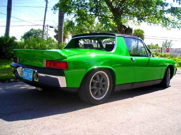

Cal   Have you considered Irish Green?   Feb 4 2017, 03:05 PM
Mitox   Have you considered Irish Green? I like the Ir...   Feb 4 2017, 06:51 PM
jmill   Here's a comparison between green (on the car)...   Feb 5 2017, 11:17 AM
Mitox   Here's a comparison between green (on the car...   Feb 5 2017, 12:29 PM

horizontally-opposed   Irish is tough to argue with, but if you're af...   Feb 11 2017, 02:32 PM

Spoke   There's always Ravenna green as well.   Aug 20 2017, 06:46 PM
