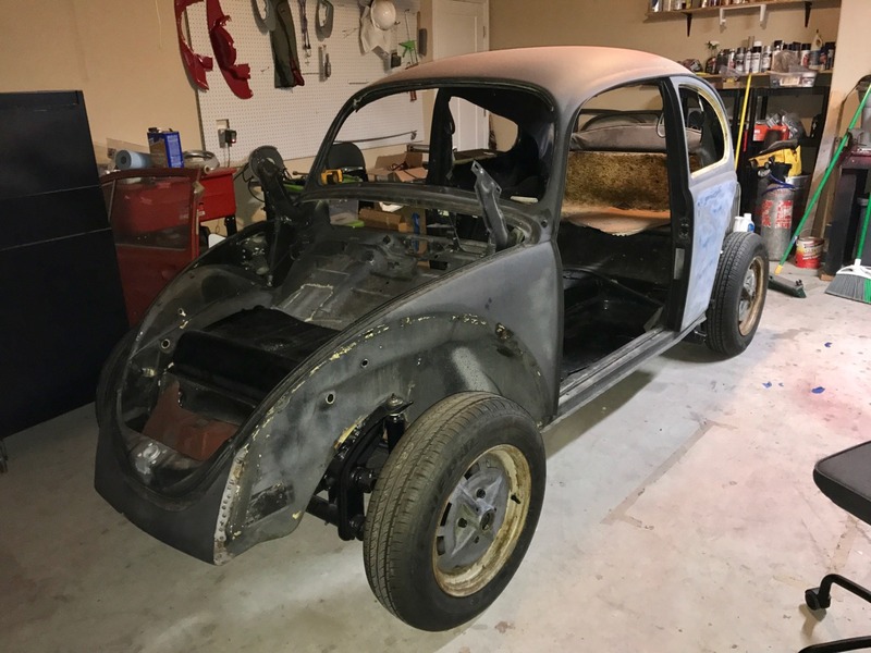

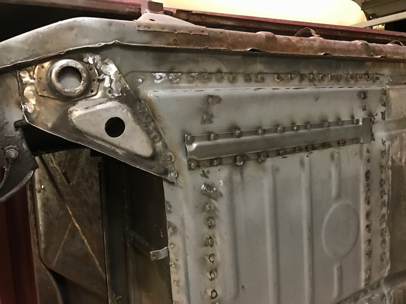

Small update, but here goes. I ended up spending all of last weekend with my other project ('70 Cal Look) that is stowed away for now. I had it before I bought my teener but, long story short, it's on hold and stored in my old college roommate's house for now.
(IMG:http://www.914world.com/bbs2/uploads_offsite/i120.photobucket.com-19557-1488343249.1.jpg)
(IMG:http://www.914world.com/bbs2/uploads_offsite/i120.photobucket.com-19557-1488343249.2.jpg)

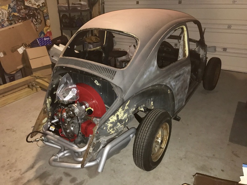

So, after a weekend of cleaning out / placing the bug body back onto the rebuilt chassis / bringing some tools back, I was pretty pooped. But, I had a little spare time & energy today so I was able to knock out a few quickies on the teener. The new seat support frames / rails from RD are now welded in place. I also cleaned up the jack points / mounts and Dad helped to straighten them out as they were pretty bent up from years of abuse. The backsides were coated with master series and then welded into place. I also took a few minutes after to grind down the high spots of all my rosette welds from the new floors.
(IMG:http://i120.photobucket.com/albums/o198/cameraman123_photos/IMG_1816_1.jpg)
(IMG:http://www.914world.com/bbs2/uploads_offsite/i120.photobucket.com-19557-1488343260.3.jpg)
I think that's everything I need to do on the underside of the car, so it looks like I may be flipping her back over soon to look at the remaining patches!
