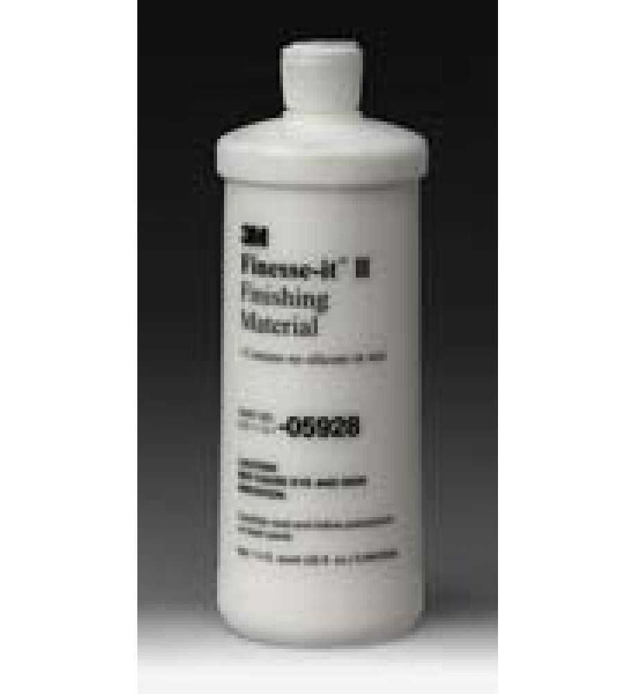

I am curious...what polish did you use?
600, Automotive finishing polish, with silcone.
But wax is a good idea after.
