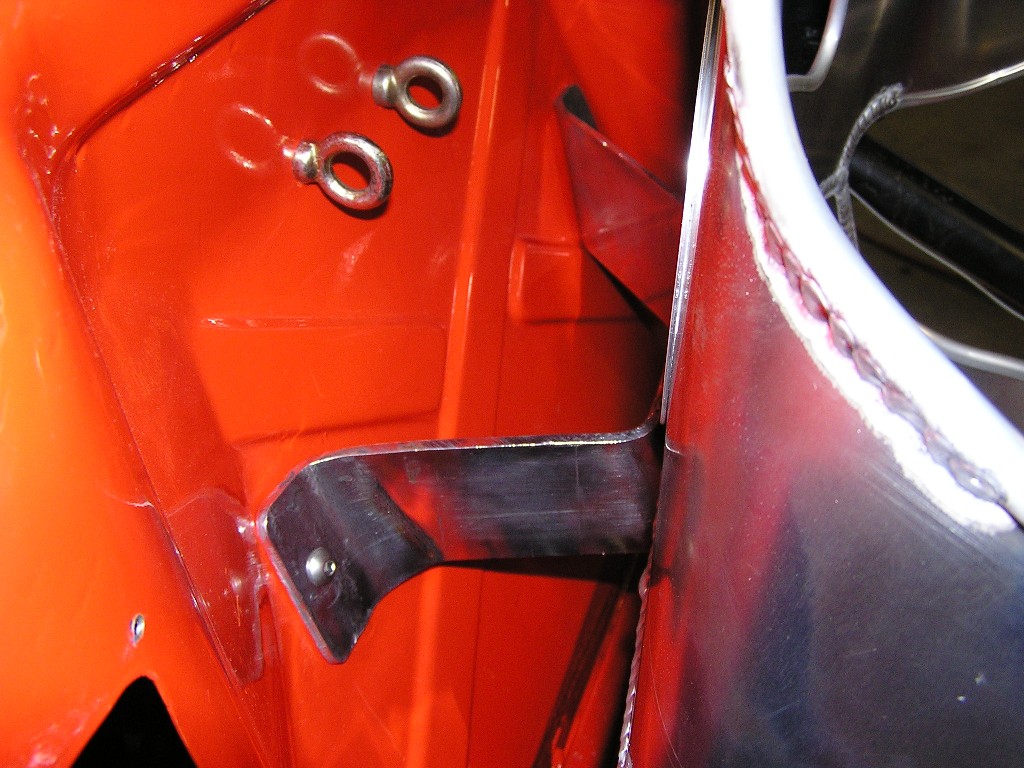

brant
post Mar 1 2017, 03:58 PM
Posts: 12,008
From: Colorado
Member No.: 47
Here is the seat back brace we made 12 years ago
it passed pca club racing tech back in the day
