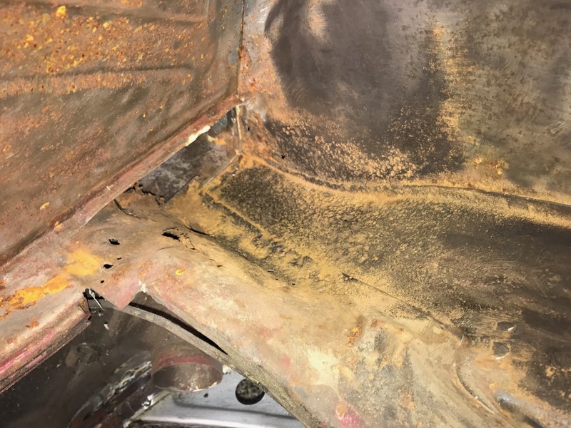

Ok, so the fun continues tonight... It is officially time to tear into the hell hole and see what lurks ahead....
Firewall, engine shelf, inner fender, and top of long all rusted with pinholes. In this pic, the lower corner of the firewall has been cut out.
(IMG:http://www.914world.com/bbs2/uploads_offsite/i120.photobucket.com-19557-1488429129.1.jpg)

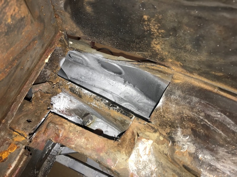

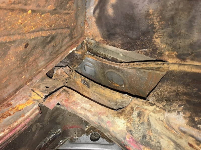

So, I started dissecting... Here is everything all opened up with just a little bit of the engine shelf left to cut out. Also appears that a PO hacked off part of the engine tin seal channel and folded it down? Need to confirm but doesn't look original to me.
(IMG:http://www.914world.com/bbs2/uploads_offsite/i120.photobucket.com-19557-1488429129.2.jpg)

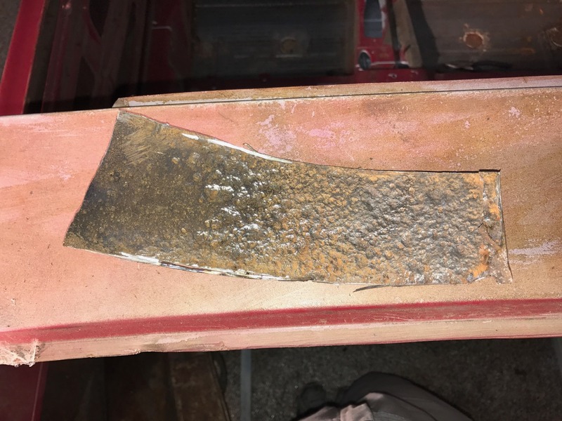

This is the section of the top of the long I cut out and will have to re-create. I did not realize there was a doubler underneath, so I'll have to get creative to weld something back in to retain that original strength.
(IMG:http://www.914world.com/bbs2/uploads_offsite/i120.photobucket.com-19557-1488429130.3.jpg)
But, still glad I cut it out because the top of the long was pretty pitted with a few pinholes:
(IMG:http://www.914world.com/bbs2/uploads_offsite/i120.photobucket.com-19557-1488429130.4.jpg)

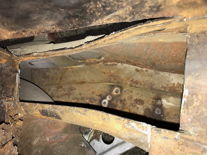

Pretty clean down inside there:
(IMG:http://www.914world.com/bbs2/uploads_offsite/i120.photobucket.com-19557-1488429130.5.jpg)

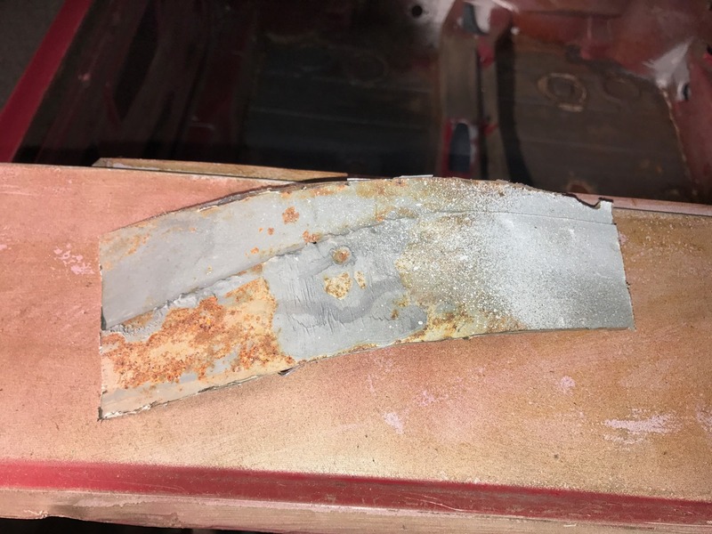

Before stopping for the night, I coated the inside of the long with Master Series:
(IMG:http://www.914world.com/bbs2/uploads_offsite/i120.photobucket.com-19557-1488429130.6.jpg)
