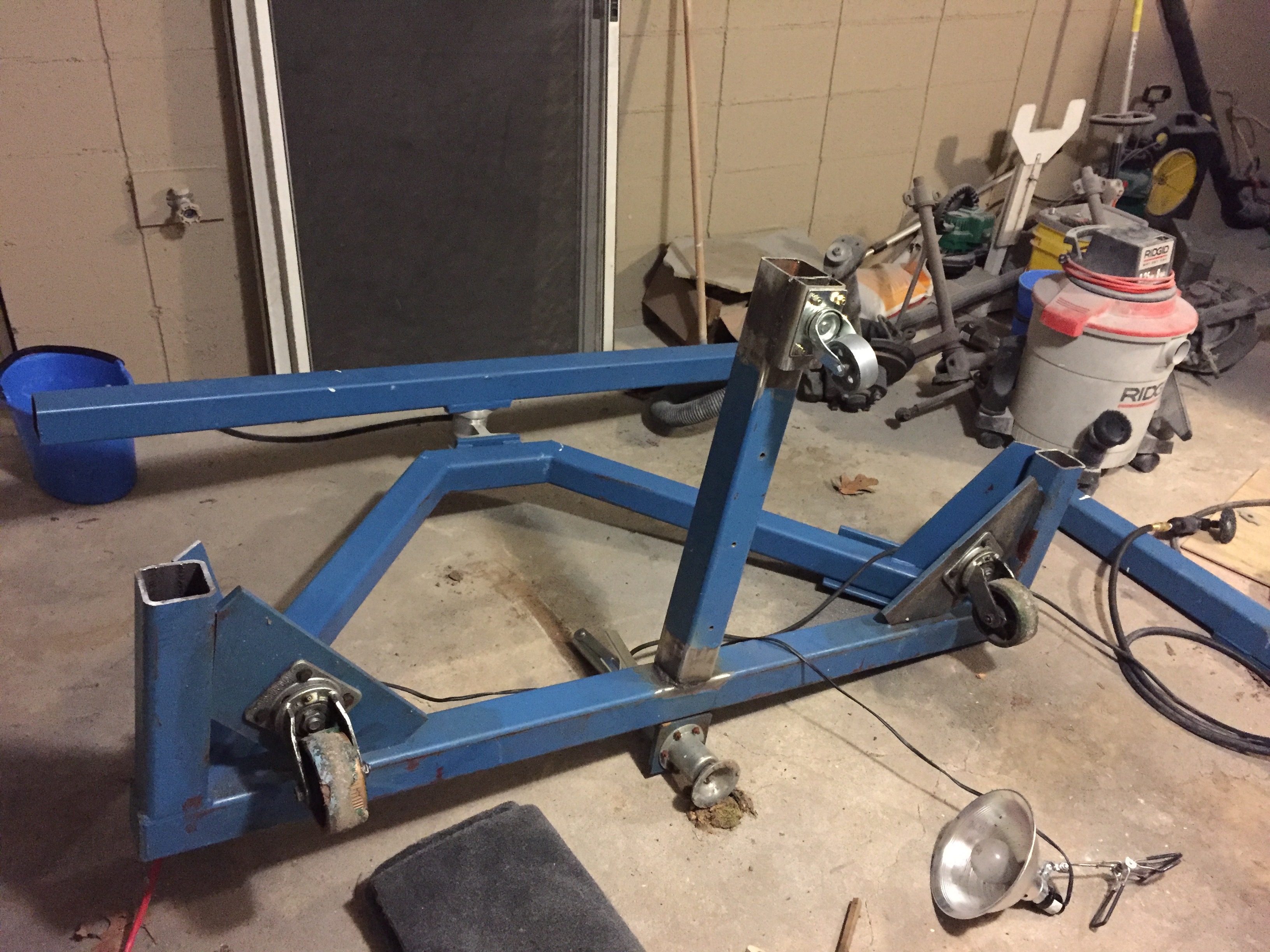

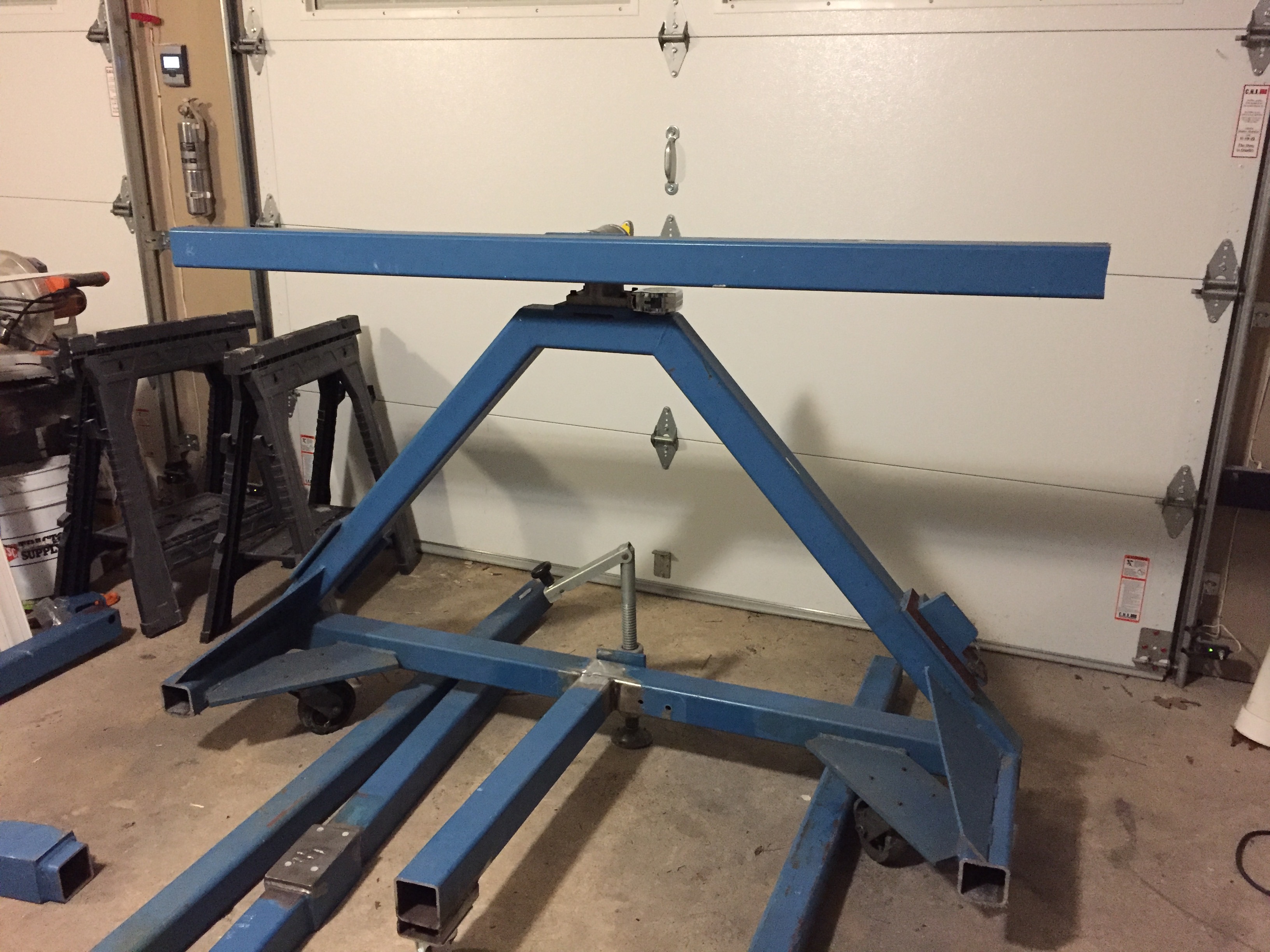

So, I've made some progress on the rotisserie. I've added a third leg and caster on each end, and removed the steel connecting the ends to each other. During March I need to make the mounting sections to connect to the 914 bumper locations, and get the car on the rotisserie.
I'd like to have the car as balanced as possible. Does anyone know the center of gravity vertically at the bumper mount locations?
