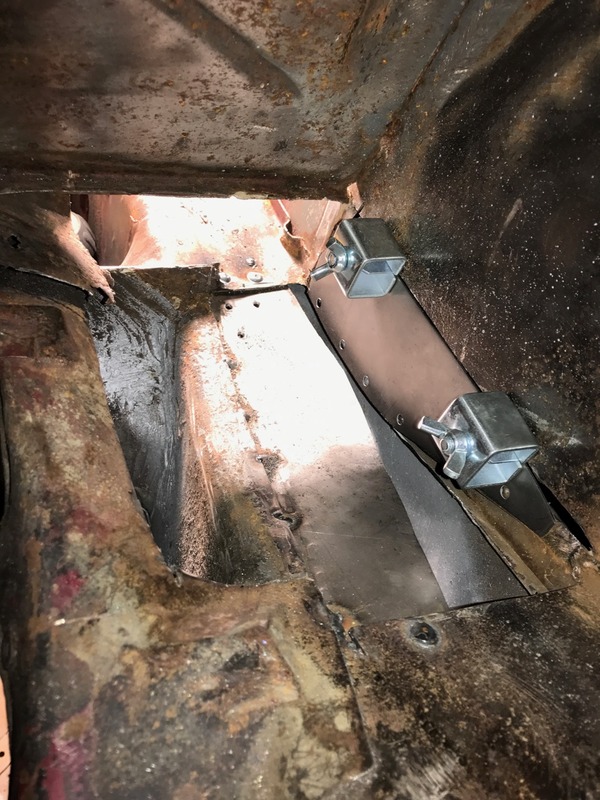

The repair saga continues... doubler is in and so is inner fender patch. These two tiny patches were four hours of work... not fun (IMG:style_emoticons/default/chair.gif) Next will be the long patch and engine shelf. I can't wait to close this back up.
(IMG:http://www.914world.com/bbs2/uploads_offsite/i120.photobucket.com-19557-1488517848.1.jpg)

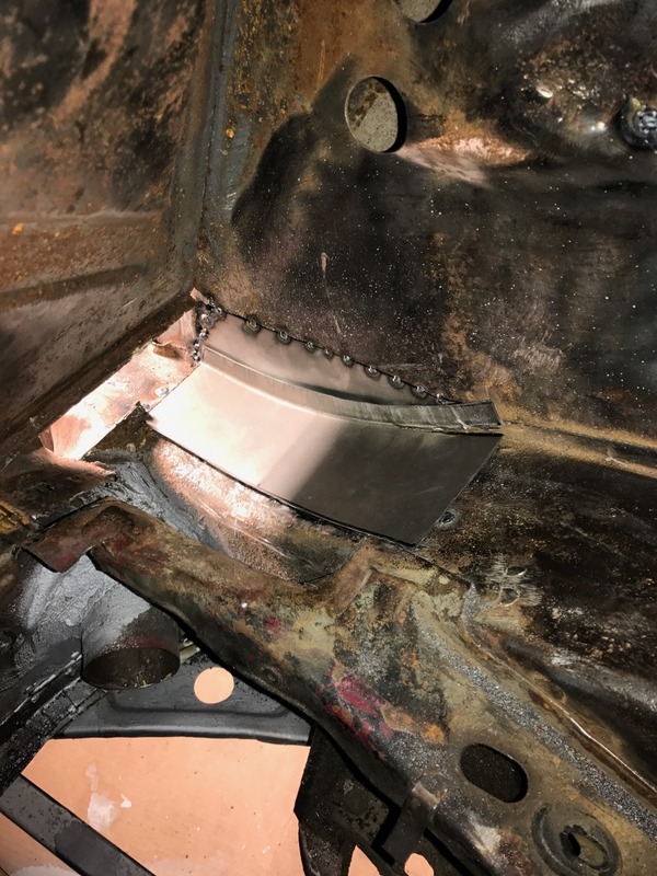

Repair patch for top of long is cut and sitting on top here, but will need final trimming and adjustment.
(IMG:http://www.914world.com/bbs2/uploads_offsite/i120.photobucket.com-19557-1488517848.2.jpg)
