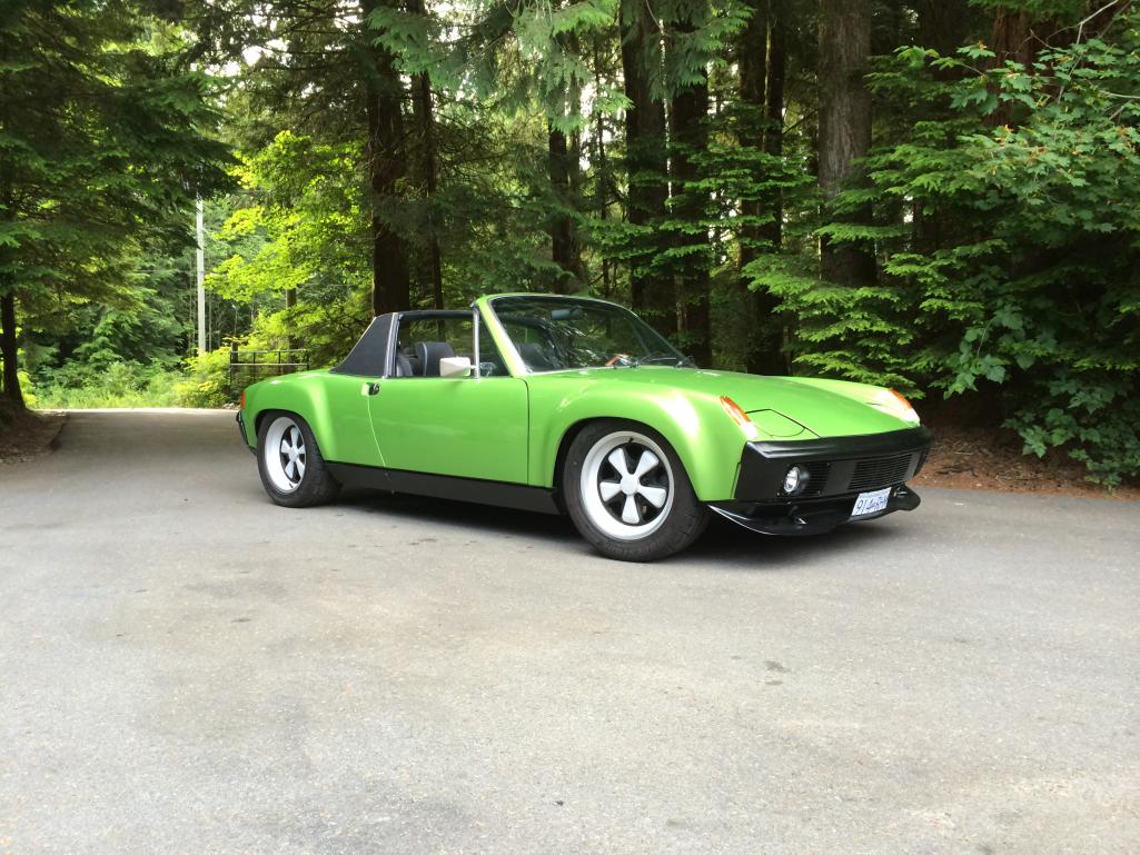

L98B is nice (IMG:style_emoticons/default/shades.gif)
That's a burly roto! NIce stuff.

QUOTE(speed metal army @ Mar 3 2017, 12:00 AM) *
Love the Lime Green. Love the wheels also; I plan to have mine done the same way.
