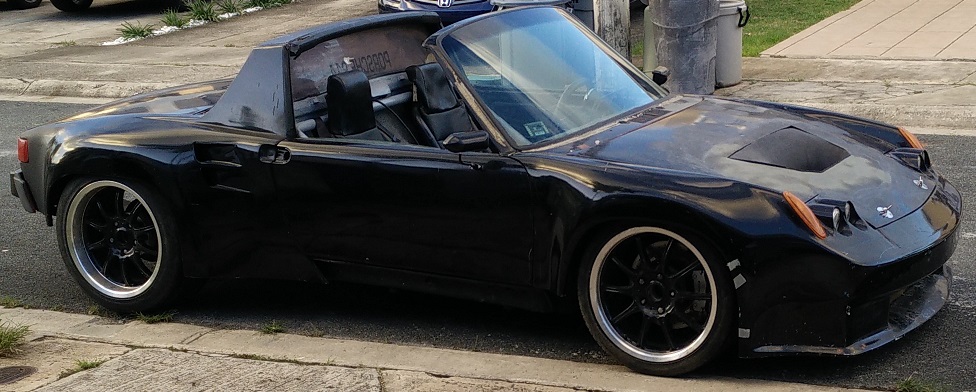

I bought this as a stripped down rolling chassis. The sller put wheels on it to get it on the trailer. That was 4 long years ago. I also had a son at the same time so working on the car has been a second priority. Now the engine is in and the brakes are on, I should be able to get some work done more quickly. I plan on firing this up within the next couple of weeks and taking on a drve by the end of July. I got the 3m adhesive today to get the fenders bonded on and then the fun stuff begins. Hope to get it completed in time for next years West Coast Ramble. Thanks to the support and motivation of the 914World. (IMG:style_emoticons/default/biggrin.gif)

I see you are doing the 240sx conversion. I was working on mine today and maybe you can use it as a reference.
I hate to do bodywork but that's what I was doing today. The downside of my installation it is if you hit hard the ground with your bumper....it will crack.
Here is the car with them.
Today bodywork....slow progress toooo...
Keep going, looking good!!!
(IMG:style_emoticons/default/aktion035.gif)

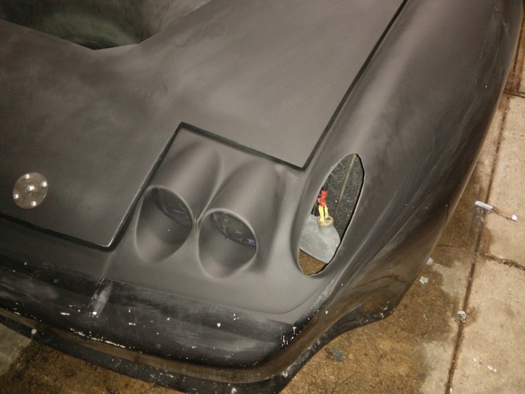

raw1298   Starting to fabricate flares into the bumpers. Usi...   Nov 14 2015, 03:22 PM
raw1298   After forming the foam and coating with bondo its ...   Apr 6 2016, 01:26 PM
raw1298   Starting rear bumper mods.   Apr 6 2016, 01:28 PM
raw1298   Rockers are next.   Apr 6 2016, 01:29 PM

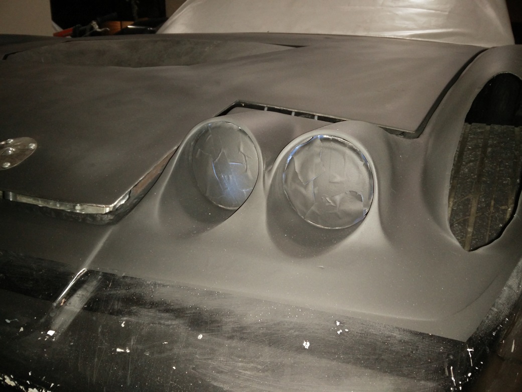

raw1298   Started on rear bumper today. Two step process. Fi...   Apr 7 2016, 03:15 PM
raw1298   A little filler....   Apr 7 2016, 03:18 PM
raw1298   Few rough patches, but not bad for a rookie like m...   Apr 7 2016, 03:48 PM
raw1298   Ran somE 40 grit over it to smooth out. I have som...   Apr 7 2016, 04:14 PM
raw1298   Side view.   Apr 7 2016, 04:21 PM
raw1298   I am really liking the way this is heading. Time f...   Apr 7 2016, 04:35 PM
raw1298   One more. :D   Apr 7 2016, 04:40 PM
