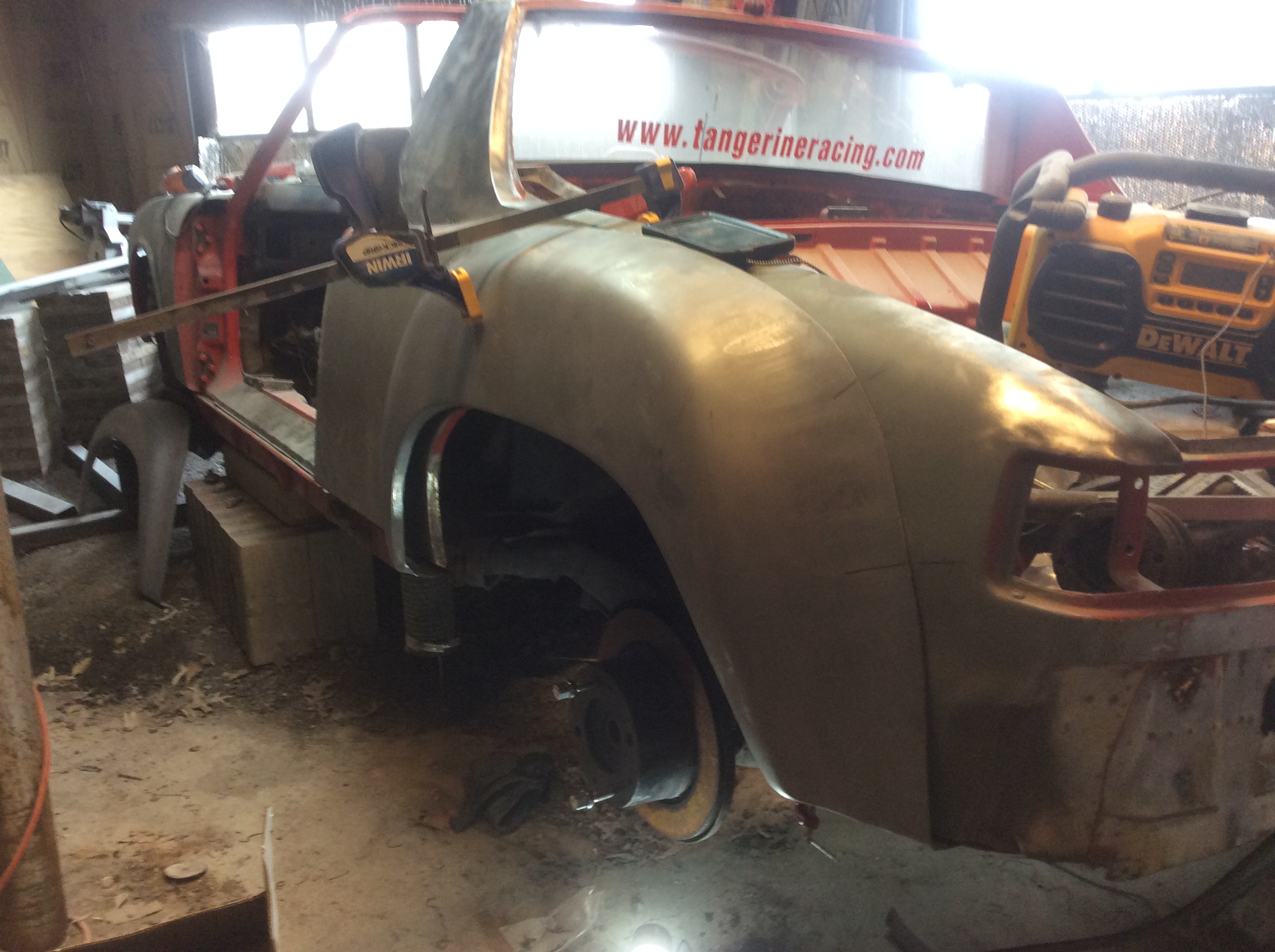

AndyB   Ok so I see time has once again eluded me. I am tr...   Mar 25 2017, 01:15 PM
AndyB   I was given the all clear to start cutting so it...   Mar 25 2017, 01:16 PM
AndyB   Just cut my first fender :sick: no turning back n...   Mar 25 2017, 03:18 PM
injunmort   burn em in   Mar 25 2017, 05:12 PM
Tom_T   Hmmmm..... :idea: I don't see anything askew...   Mar 28 2017, 09:23 AM
AndyB   Thanks TomT. However here are the pictures that ma...   Mar 28 2017, 12:20 PM
Tom_T   There is some body work that I need to take care...   Mar 28 2017, 12:37 PM
Tom_T   Hey! .... I just noticed that you got you...   Mar 28 2017, 12:39 PM
AndyB   Hey! .... I just noticed that you got yo...   Mar 28 2017, 12:48 PM
Tom_T   Andy .... you had gravel in the barn - most of it ...   Mar 28 2017, 12:55 PM
AndyB   Ok so here is the rear corner piece in question. I...   Mar 28 2017, 01:00 PM
Tom_T   Ok so here is the rear corner piece in question. ...   Mar 28 2017, 01:55 PM
AndyB   PMB suspension on the way. Can't wait for it t...   Mar 28 2017, 01:23 PM
