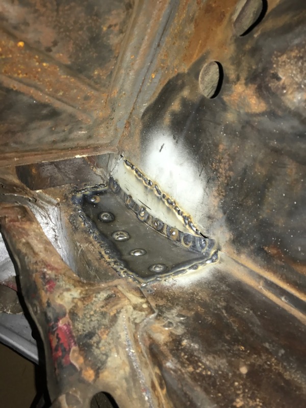

Finally got a chance to get in the garage and play last night. Doesn't look like much, but was a few hours worth of fitting and welding.
Hell hole / Top of Long patch fitted to size:
(IMG:http://www.914world.com/bbs2/uploads_offsite/i120.photobucket.com-19557-1490282442.1.jpg)
Welded in place (still need to grind and fill holes)
(IMG:http://www.914world.com/bbs2/uploads_offsite/i120.photobucket.com-19557-1490282442.2.jpg)

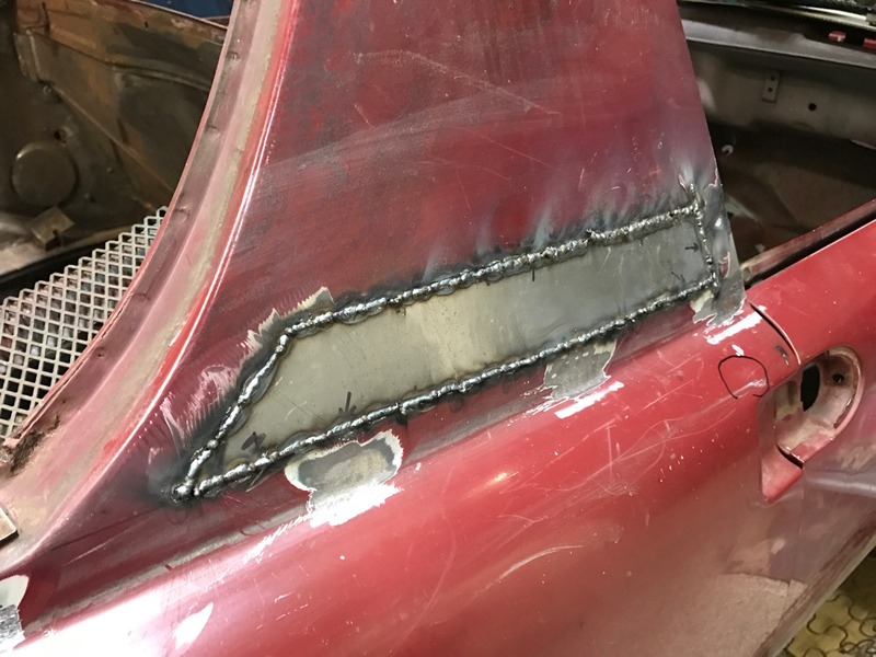

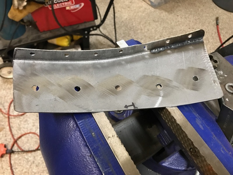

Also made a new piece for the passenger side sail panel and got this welded in. I was way down on the welder (A-1.5) and used compressed air after each weld to try and prevent and warpage. I think we did ok, but will have to grind and block to see if there is anything serious.
