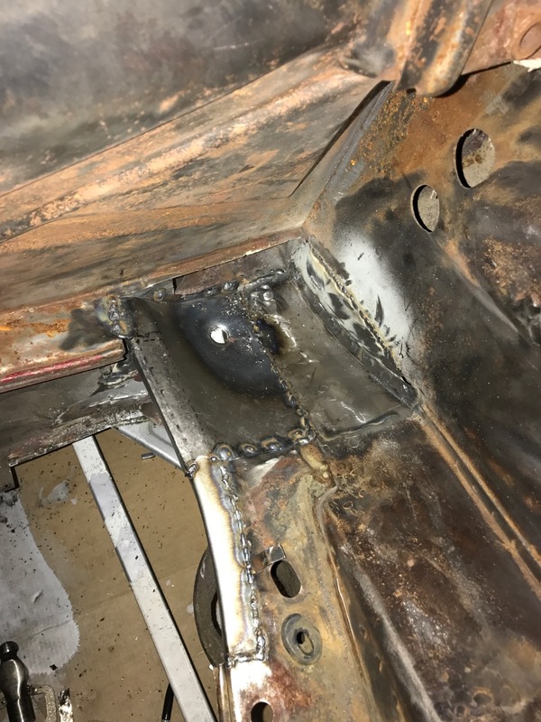

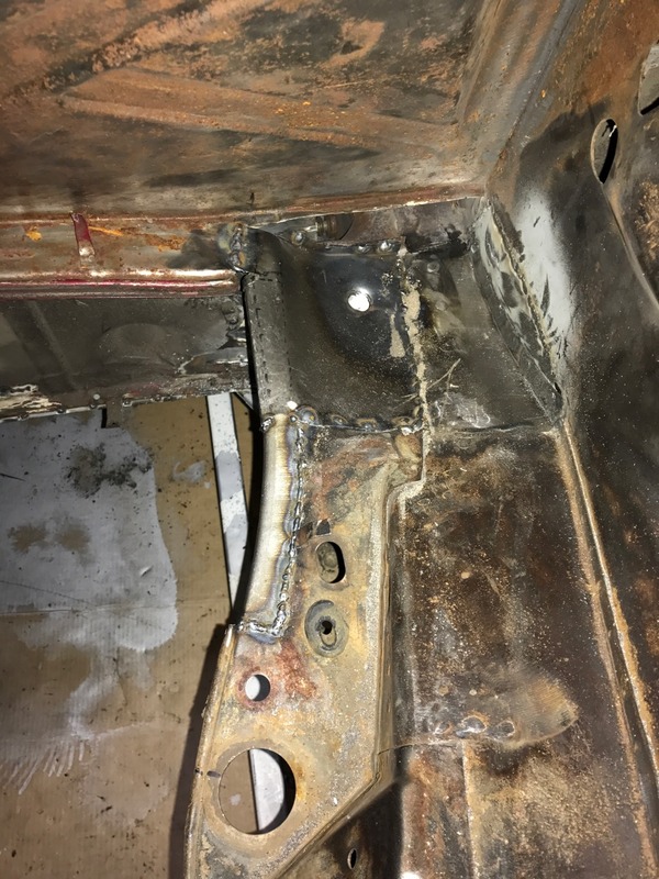

Time for another update! Today we finished up the engine shelf, creating the patch from scratch. Man, that was a chore. We stared with a gaping hole to fill:
(IMG:http://www.914world.com/bbs2/uploads_offsite/i120.photobucket.com-19557-1490505168.1.jpg)
Dad took charge shaping the patch:
(IMG:http://www.914world.com/bbs2/uploads_offsite/i120.photobucket.com-19557-1490505168.2.jpg)

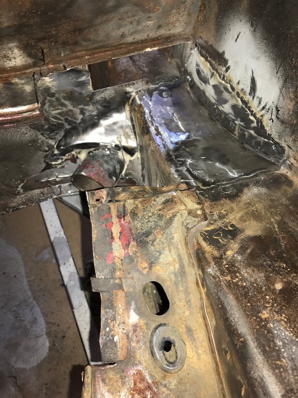

The PO had cut out part of the engine seal channel and folded down that portion of the engine shelf out of the way. I decided to cut out some more of the what was left of the original shelf and build out to where the seal channel should go with new steel. We made a template of the driver's side seal channel shape and mirrored it to use on the passenger side.
The main patch of the engine shelf took quite a bit of creative shaping, as neither one of us are skilled sheet metal workers and we certainly don't have all of the typical tools. But, we were able to create a patch that is pretty darn close to the original shape. We used a torch and ball-peen hammer to dimple the metal patch and create a low spot to re-create the original drain hole.
I think it turned out pretty good, but these aren't the best pictures:

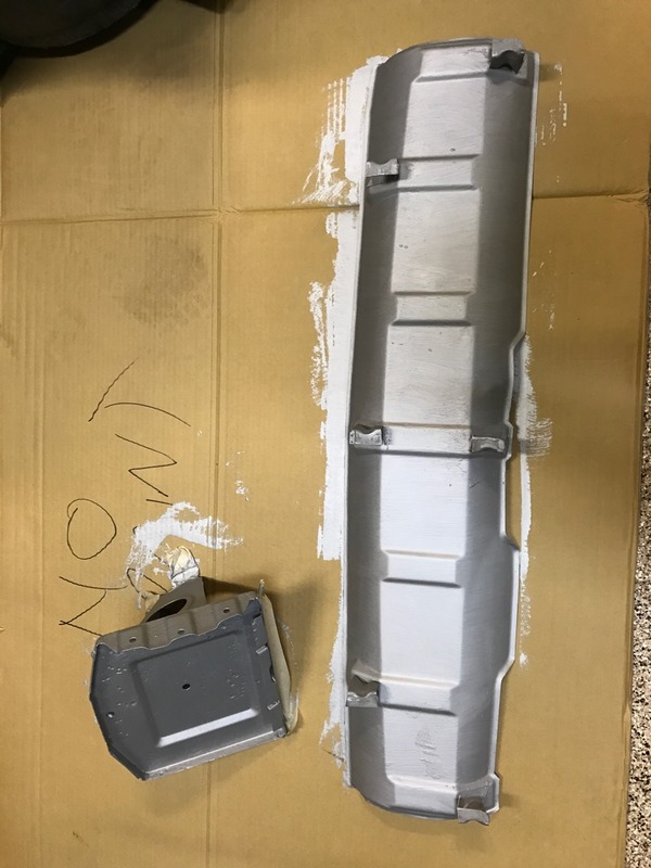

Also managed to blast & paint the exhaust shield and battery box with Master Series. Will be looking to tack these parts in soon:
