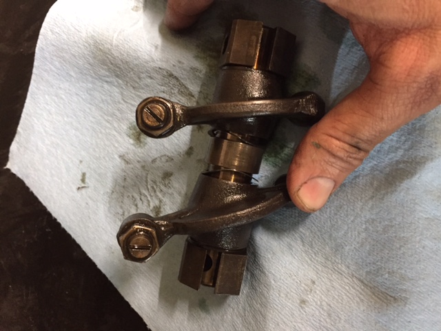

Just checked the #2 exhaust lifter with the boroscope (cause I have every tool known to man. My garage looks like China.) it's also hydraulic.
The pushrods are magnetic,so I assume they're chromoly. But they look normal sized. I thought hydraulic rods were fatter? Could this be another episode in the adventures of DAPO???
Here's a pic of the #2 rocker assembly, but the rest look like this too. My yellow car had a McMark-built 2056, which had some pretty big differences...so I don't know what's "normal" for a "stock" 2.0. But I have read that spring rings like the ones on this rocker assembly are usually paired with hydraulic lifters...is that correct?
Now that the hydraulic cat is out of the bag, I def want to switch back over to solid. Problem is I don't know if the cam was changed and/or if it will work with solid.
Any suggestions on how to change it are appreciated... Will start another thread with specifics.
Thanks!Attached Image

QUOTE(cuddyk @ Mar 26 2017, 05:46 PM) *
Previous owner had no interest in hitting redline.....and less interest in regular
valve adjustments. Hydraulics ! Voila !
Ian, as an aside I have a '89 VW Westy that has hydraulics.
If it sits for a few weeks they leak down and then take a while (1/2 hr) to pump up.
This is especially true in warmer weather. I'll renew them this summer.
Until you decide what course to take replace the oil w/ Shell Rotella 20w50 or similar.
You can also bleed the lifter before re-installing it. Immerse it in oil and pump it with the pushrod until it becomes harder....er stiffer...er.... less springy.
Never did it myself but heard of it.
