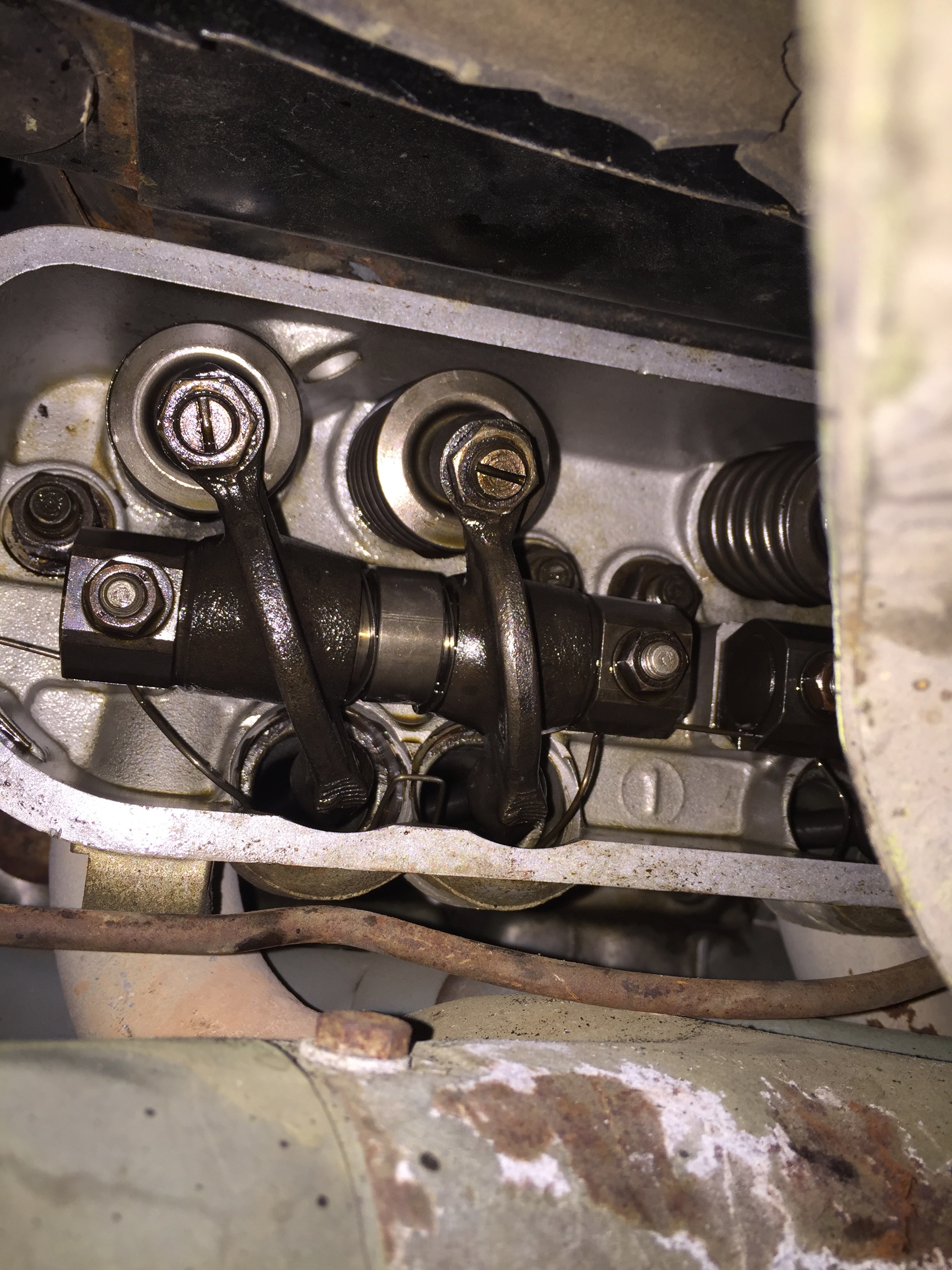

Pulled the valve covers to see if that's where the racket was coming from and figured it was a good idea to make sure everything was properly adjusted anyway. Nothing LOOKS weird, but if I pull backwards on the #2 intake rocker, it will move about 1/4" towards me. Let it go and it returns back to contacting the valve stem. I know it isn't normal, but before I tear into things, I thought I'd check with the brain trust.Bent rod? Beginnings of dropped valve?

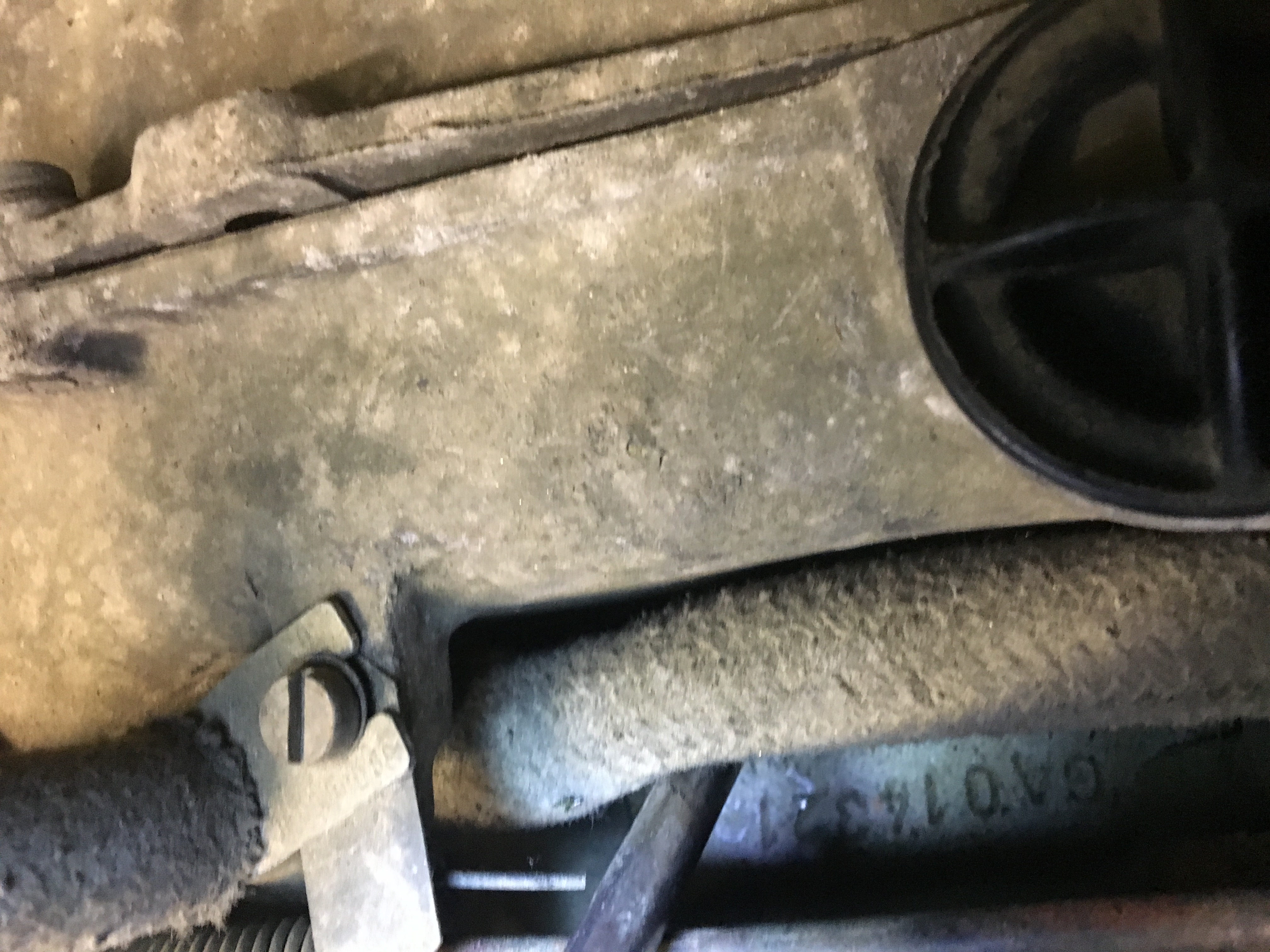

Do the engine VIN numbers have the same font and appearance as other GA engines ?

Engine code stamp looks normal. And it appears the motor hasn't been dropped or worked on in a very long time.
I pulled the rocker assembly and the seat and setup looks perfect. Although the adjuster nuts were incredibly tight. I mean like insanely. Had to put the assembly in a vice to crack the nuts. Clearance was zero lash before removal, which leads me to believe there may be chromoly pushrods in here?

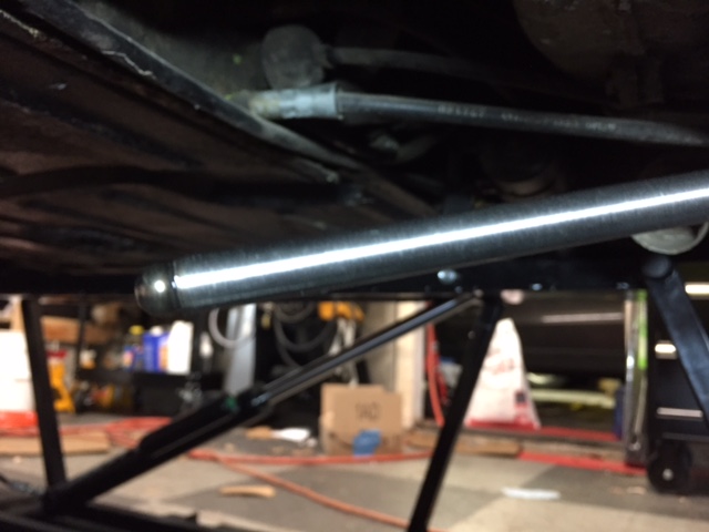

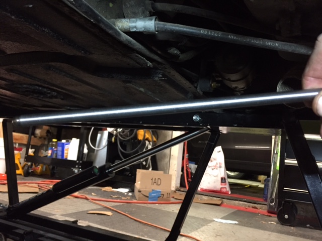

I pulled the #2 intake pushrod (pic below) and it appears fine and true. Any way to tell if it's chromoly?
When I put the rod back in, I feel it sitting in the cup as it should. Pushing on it definitely feels "springy". If I have to pull the tube and lifter I will...but I'd like to make that a last resort since there are no leaks now, and with things being undisturbed for so long, I'm not sure what might become dislodged. Also I don't know if there's any sealant in there that would be a b***h to clean without dropping the engine. But like I said...I will if I have to.

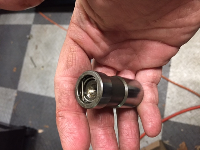

Of course you're right...It's always better to just rip the bandaid off and get it over with...
A picture says a thousand words. The question is...now what? switch to solid?

Just checked the #2 exhaust lifter with the boroscope (cause I have every tool known to man. My garage looks like China.) it's also hydraulic.
The pushrods are magnetic,so I assume they're chromoly. But they look normal sized. I thought hydraulic rods were fatter? Could this be another episode in the adventures of DAPO???

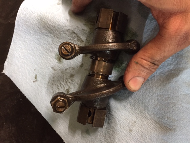

Here's a pic of the #2 rocker assembly, but the rest look like this too. My yellow car had a McMark-built 2056, which had some pretty big differences...so I don't know what's "normal" for a "stock" 2.0. But I have read that spring rings like the ones on this rocker assembly are usually paired with hydraulic lifters...is that correct?
