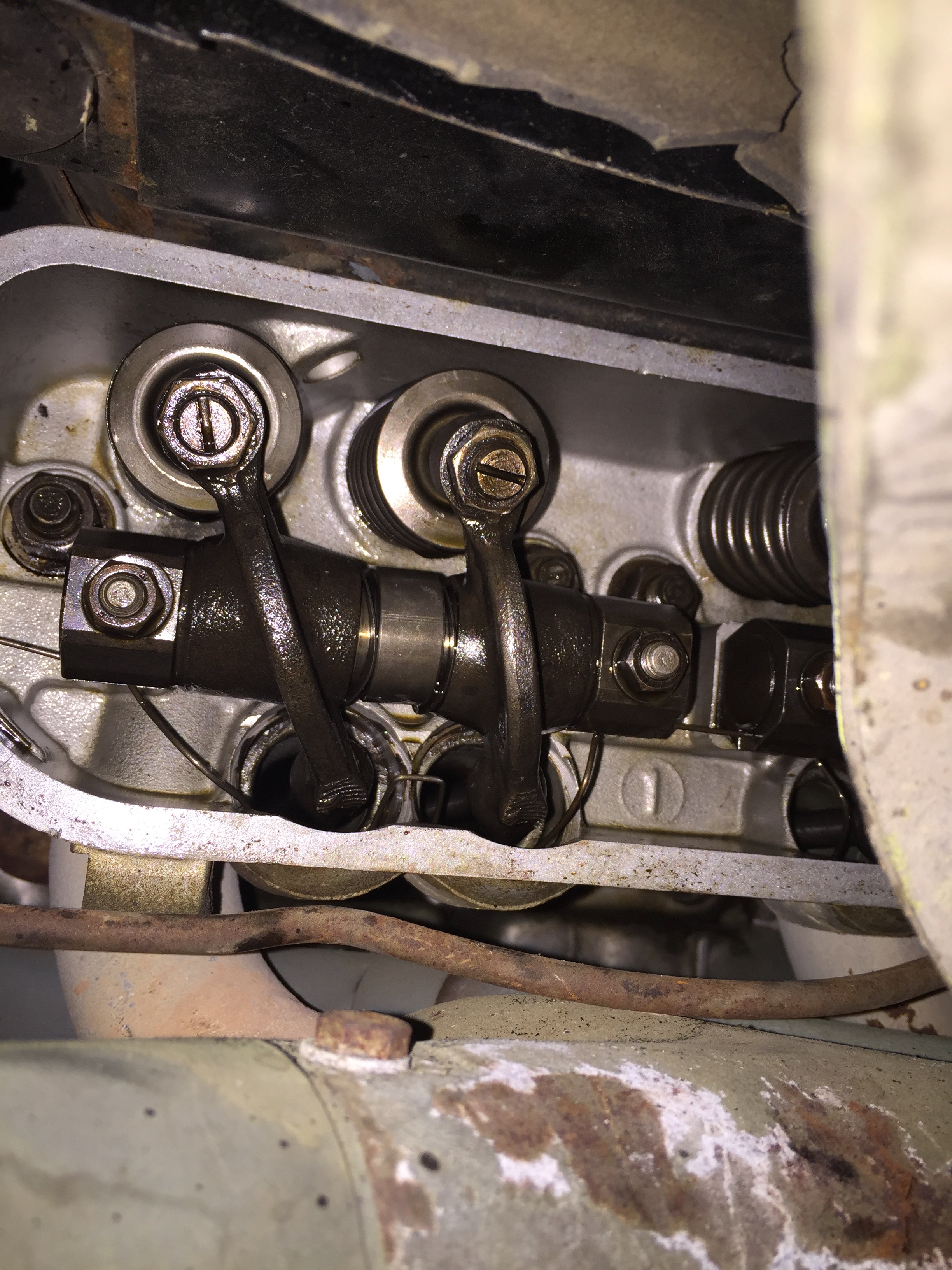

Hi Guys,
So...my (new to me) 74 2.0 FI was idling great and running pretty well, except after warm it would occasionally experience a loss of power at about 3000K. Last weekend I took the dizzy out to clean and lube the plates. Also installed a pertronix and flame thrower coil. Started it up and ran like crap and uber rich. Then realized I forgot to connect the MPS hose. duh. Did that and it started up ok. It was late, so I left the car till this weekend to get the timing dialed in.
OK, so I start it today and hear this tapping racket and the engine feels like it's only running on 3 cylinders. Pulled plug wires one at a time, and it seems all are contributing.
Pulled the valve covers to see if that's where the racket was coming from and figured it was a good idea to make sure everything was properly adjusted anyway. Nothing LOOKS weird, but if I pull backwards on the #2 intake rocker, it will move about 1/4" towards me. Let it go and it returns back to contacting the valve stem. I know it isn't normal, but before I tear into things, I thought I'd check with the brain trust.Bent rod? Beginnings of dropped valve?

Which direction are you pulling it? Are you sliding it sideways on the pivot shaft, or are you rocking it away from the valve?
If the seat is receding, the clearance goes away. If the valve is bent the clearance increases (a lot).
If the seat falls out, it would probably hit the piston and could bend a rod. All guesses. Pictures would help of course.

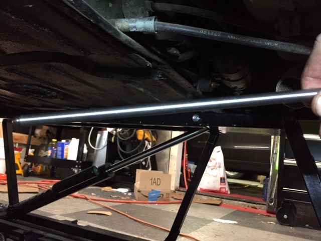

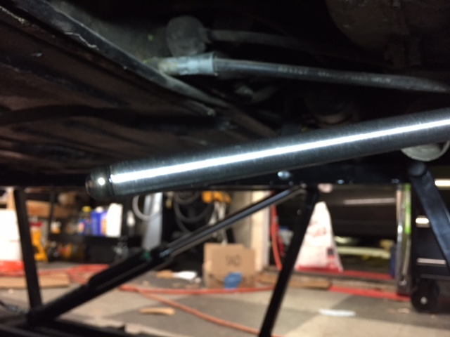

I pulled the rocker assembly and the seat and setup looks perfect. Although the adjuster nuts were incredibly tight. I mean like insanely. Had to put the assembly in a vice to crack the nuts. Clearance was zero lash before removal, which leads me to believe there may be chromoly pushrods in here?
I pulled the #2 intake pushrod (pic below) and it appears fine and true. Any way to tell if it's chromoly?
When I put the rod back in, I feel it sitting in the cup as it should. Pushing on it definitely feels "springy". If I have to pull the tube and lifter I will...but I'd like to make that a last resort since there are no leaks now, and with things being undisturbed for so long, I'm not sure what might become dislodged. Also I don't know if there's any sealant in there that would be a b***h to clean without dropping the engine. But like I said...I will if I have to.

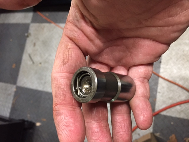

You're this deep. I would pull the tube and fish out the lifter.

iankarr
post Mar 26 2017, 01:21 PM
Posts: 2,600
Joined: 22-May 15
From: Heber City, UT
Member No.: 18,749
QUOTE(Tbrown4x4 @ Mar 26 2017, 03:08 PM) *
If some one put hydraulic lifters in our solid lifter engine, is there an oil gallery to feed them?
Of course you're right...It's always better to just rip the bandaid off and get it over with...
A picture says a thousand words. The question is...now what? switch to solid?

I would switch to solid myself. I don't have a lot of Type 4 experience, but the hydraulics pump up at higher revs. That could be your power loss at higher RPMs.
