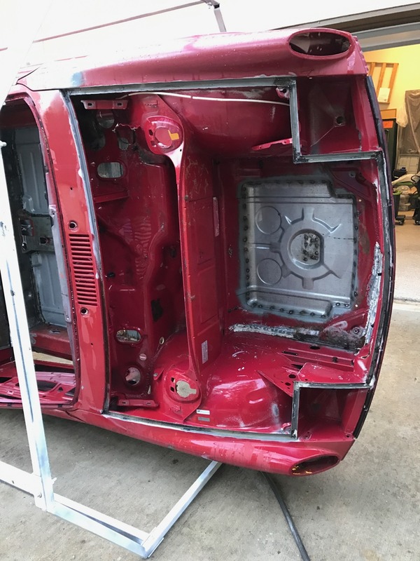

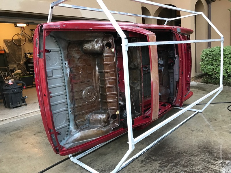

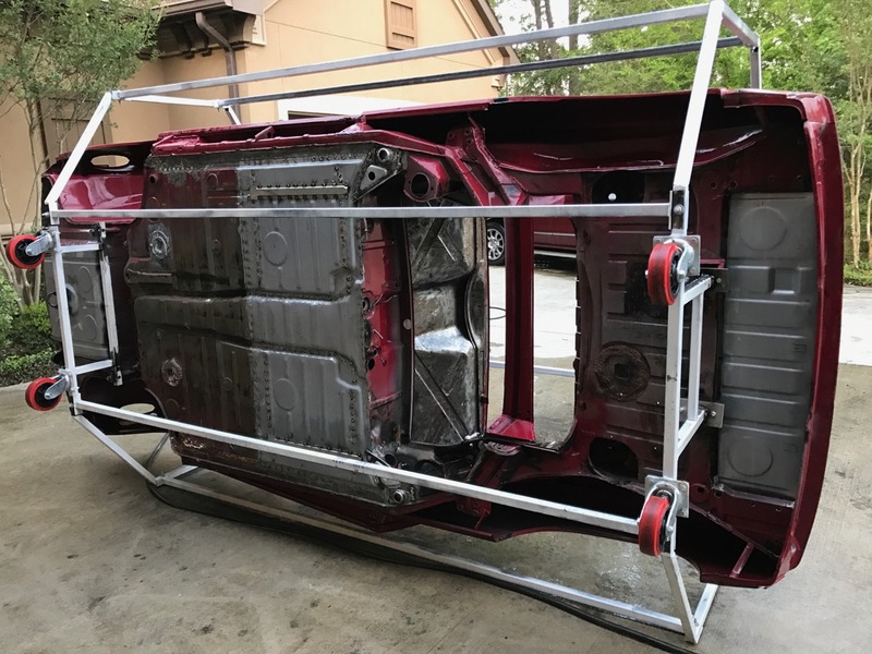

Took her out, flipped her over, and got her wet. (IMG:style_emoticons/default/beerchug.gif)
I couldn't stand the road grime and grease when crawling around getting in / out of the engine compartment. So, I soaked everything with some super clean and pressure washed. Probably the first time the underside has seen a bath since new? Also ended up washing out a few pounds of petrified rat turds.. think I got the last of them now.
(IMG:http://www.914world.com/bbs2/uploads_offsite/i120.photobucket.com-19557-1490590954.1.jpg)
(IMG:http://www.914world.com/bbs2/uploads_offsite/i120.photobucket.com-19557-1490590954.2.jpg)
(IMG:http://www.914world.com/bbs2/uploads_offsite/i120.photobucket.com-19557-1490590955.3.jpg)
