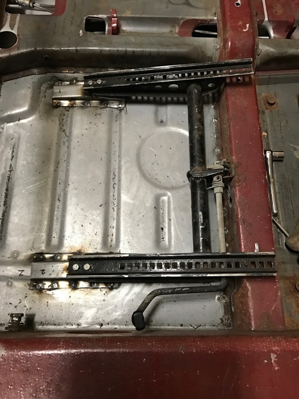

I used the seat rails to figure out where to mount the hinges back in place on the floor. These were missing since the rear floor pan half was replaced with a new panel from RD. I wanted to make sure there would be no future fitment issues, so I tacked everything with the seat frame in place, then removed to burn in.

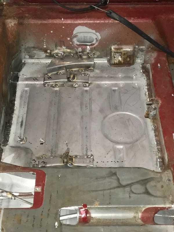

I also welded the emergency brake cable guide back in place. I was curious about the overlap of this guide and the outside, driver seat frame mount. But, after referencing the original floor pan it looks like there was some overlap from the factory.
(IMG:http://www.914world.com/bbs2/uploads_offsite/i120.photobucket.com-19557-1490676367.2.jpg)
Lastly, got the spare tire hold down back in place in the front trunk.
(IMG:http://www.914world.com/bbs2/uploads_offsite/i120.photobucket.com-19557-1490676367.3.jpg)
