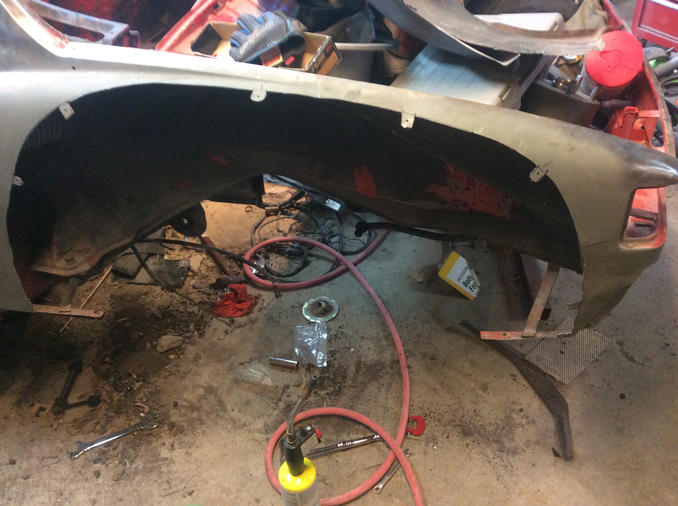

Thanks TomT. However here are the pictures that make me queasy....
There is some body work that I need to take care of. So the question is, since the areas are at the front and rear of the flare should I fix the bumps now or after welding the flare on? Enquiring mnds want to know. (IMG:style_emoticons/default/biggrin.gif)

QUOTE(AndyB @ Mar 28 2017, 10:20 AM) *
AndyB
I recall some of the pix at the start of this thread, & would say fix them first so your flares are going onto "done" clean body work & giving best fit. Just the metal work - not any bondo nor build for finish, which you'll want to do with the flares on to blend it all nicely.
Maybe Alien Rick or one of our other bodywork Pro members will weigh in on it too?
You might also want to protect your bare metal with some Wurth weld-through High Zinc primer (or similar from Eastwood, etc.) so it stays rust-free.
I've been doing that religiously whenever I wire wheel any surface rust areas on mine, since I'm on the 50-year-plan for my resto! (IMG:style_emoticons/default/dry.gif)
