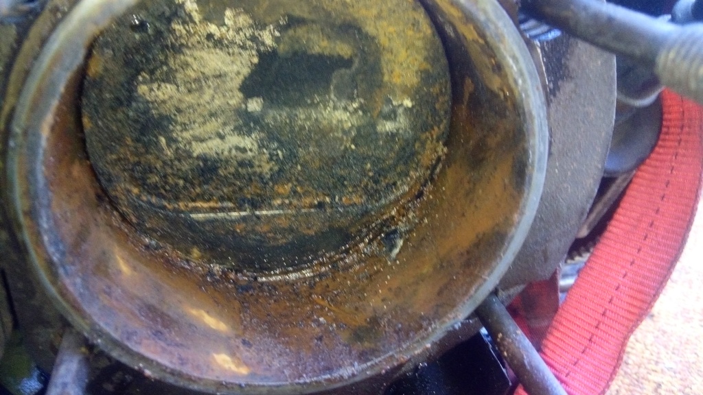

I have two cylinders with rust in them. One pretty bad. Wonder if I can hone these? Also, How the hell am I going to get my cylinders off the pistons with the rust? Here is a pic of the worst one.

cuddyk   Sorry to see this. Leave some penetrating oil on ...   Apr 3 2017, 04:57 PM
jeffdon   Sorry to see this. Leave some penetrating oil on...   Apr 3 2017, 05:12 PM
cuddyk   Tough to tell before you free the jugs ;). But th...   Apr 3 2017, 05:36 PM
jeffdon   Tough to tell before you free the jugs ;). But t...   Apr 3 2017, 09:24 PM
Mikey914   Pretty sure there will be some pitting. Good news ...   Apr 3 2017, 07:08 PM
jeffdon   Pretty sure there will be some pitting. Good news...   Apr 3 2017, 09:25 PM

The Cabinetmaker   If they are oem cylinders, bore them out and buy n...   Apr 4 2017, 10:07 AM
jeffdon   If they are oem cylinders, bore them out and buy ...   Apr 4 2017, 10:16 AM
cgnj   Hi, Probably toast from the pic. Still, if you hav...   Apr 4 2017, 10:25 AM

jeffdon   Just coaxed what I thought was the worst one off. ...   Apr 4 2017, 12:13 PM
jeffdon   one to go....   Apr 4 2017, 02:15 PM
jeffdon   All off. Phew.   Apr 4 2017, 03:30 PM
