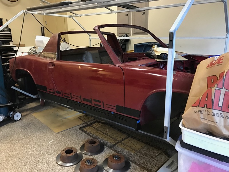

Some small updates, but first a little day-dreaming:
(IMG:http://www.914world.com/bbs2/uploads_offsite/i120.photobucket.com-19557-1491285260.1.jpg)
Loving these ABS rockers I picked up from another forum member. Going to look great when actually installed. Note the real shiny section of the door and front fender - I did a little polishing the other day. The original Malaga red shined up pretty good. It's a shame this car was taken apart and screwed with because the paint was good enough to be a survivor with a buff.

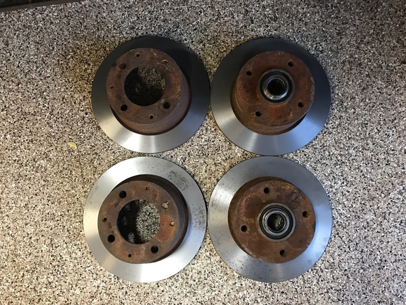

I ended up stealing the rotors off of my '72 parts car because they measured out to basically brand new thickness despite some really heavy rust. I had them turned down to within machine limits, so saved some money there vs. buying new rotors all the way around. I'm going to blast and paint the centers black once I get a chance:
(IMG:http://www.914world.com/bbs2/uploads_offsite/i120.photobucket.com-19557-1491285261.2.jpg)

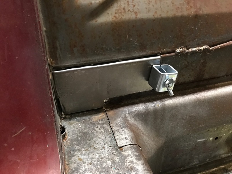

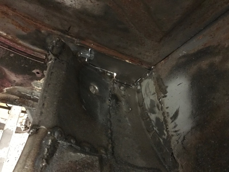

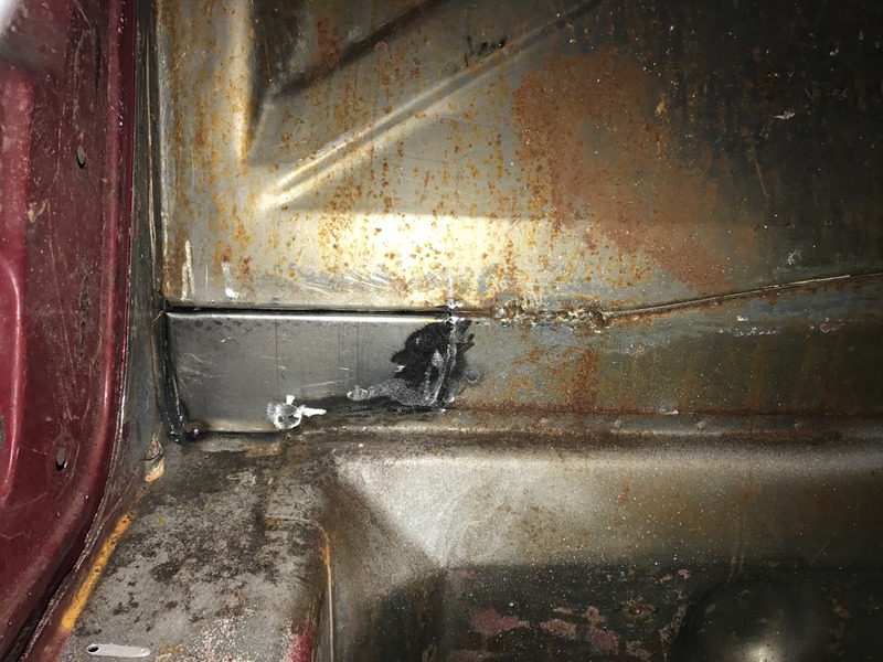

Now back to the last of the remaining hell hole repairs. I made the firewall patch and got it welded in place on the front side. I didn't feel like crawling around in the hell hole tonight but I'll have to finish the welds on the back side soon.
(IMG:http://www.914world.com/bbs2/uploads_offsite/i120.photobucket.com-19557-1491285261.3.jpg)
(IMG:http://www.914world.com/bbs2/uploads_offsite/i120.photobucket.com-19557-1491285261.4.jpg)
(IMG:http://www.914world.com/bbs2/uploads_offsite/i120.photobucket.com-19557-1491285261.5.jpg)

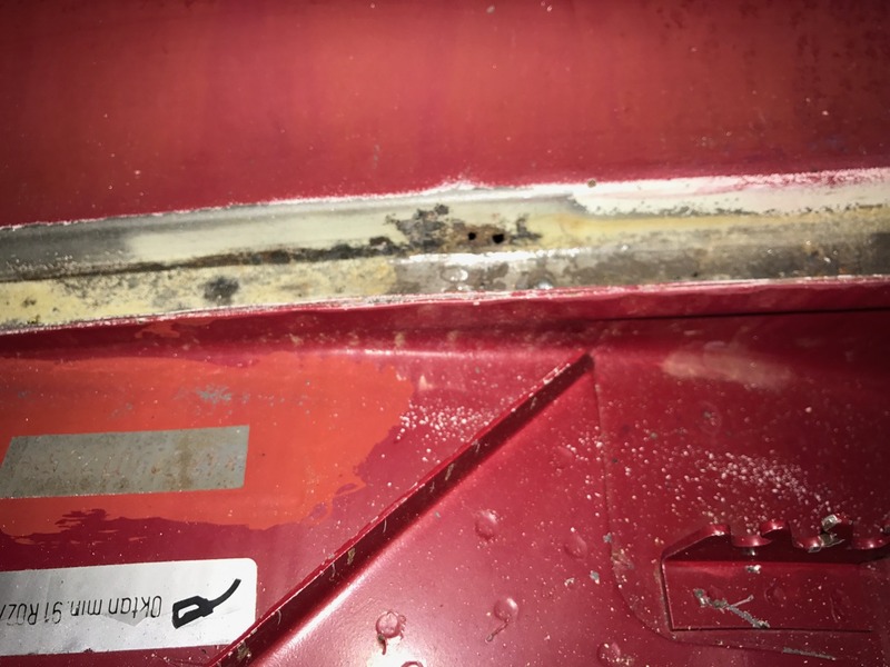

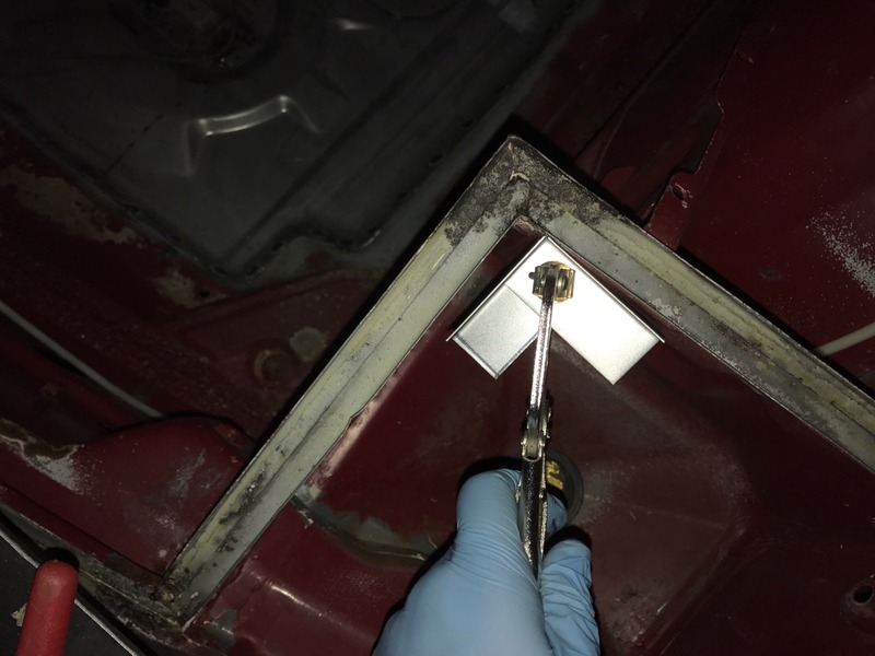

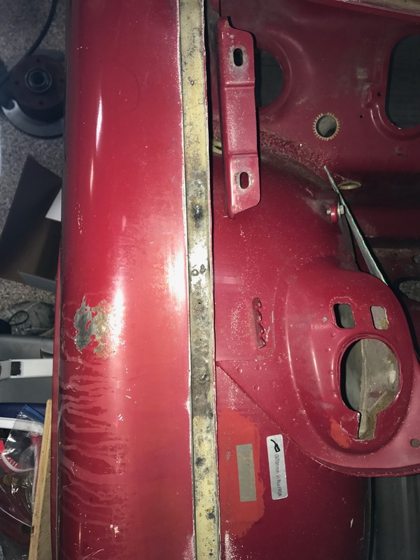

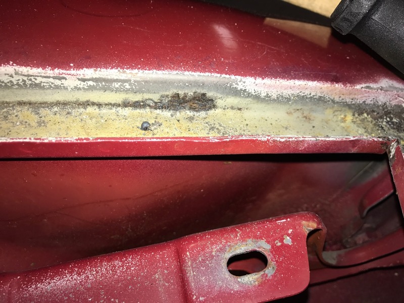

On to the front hood seal track... the more I dig the more I discover some really rotten areas under the seal. There are likely 3 corners that will have to be replaced, like this one here:
(IMG:http://www.914world.com/bbs2/uploads_offsite/i120.photobucket.com-19557-1491285262.6.jpg)

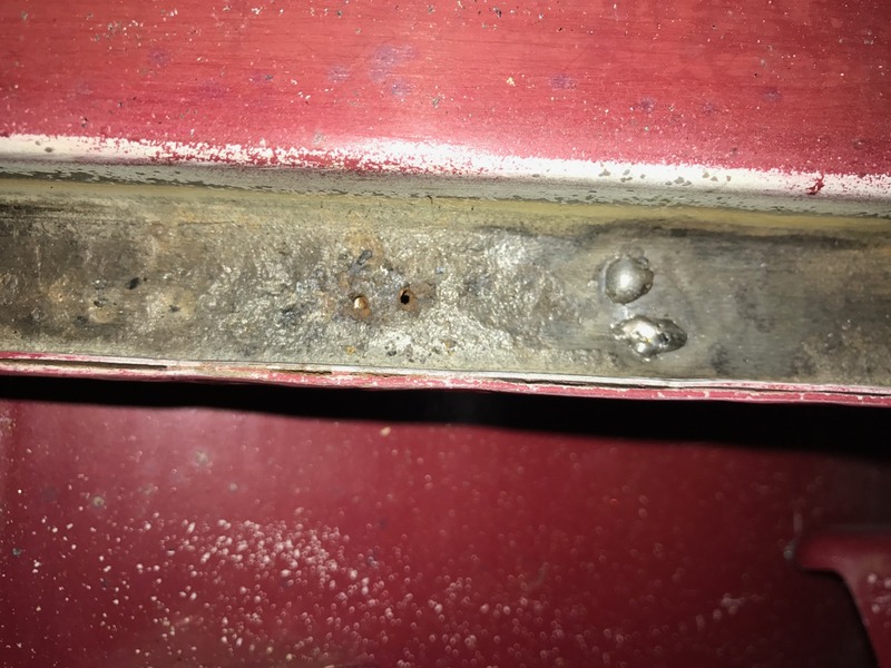

The passenger side where it meets with the fender has some areas of concern that really need to be cut out and replaced. I tried to tack weld up some of the rust holes but the more I poke around the less I trust the metal that's actually leftover. So, I think I'm going to cut it out in three sections, but it's going to be a pain in the butt to recreate some of this...
(IMG:http://www.914world.com/bbs2/uploads_offsite/i120.photobucket.com-19557-1491285262.7.jpg)
(IMG:http://www.914world.com/bbs2/uploads_offsite/i120.photobucket.com-19557-1491285262.8.jpg)
(IMG:http://www.914world.com/bbs2/uploads_offsite/i120.photobucket.com-19557-1491285262.9.jpg)
(IMG:http://www.914world.com/bbs2/uploads_offsite/i120.photobucket.com-19557-1491285263.10.jpg)
More to come once I figure out my game plan for the seal channel replacement. I'm also planning to knock out fitting the new J West hinges and Camp hood struts soon. My goal is to have all of the "metal work" done in April, so that I can strip down to bare metal and epoxy prime in May.
