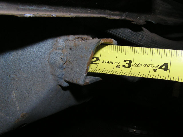

I am in the process of repairing the longs on my car, pretty straight forward, except the jack posts had been removed by the PO. I have the replacement pieces and am not sure of proper set up. How far into the support should the tube go? Do I weld the tube to the support first, then to the car? Does the tube get welded to the car or just to the support? HELP!!!!! All of the photos and illustrations I can find really don't help.

Deano Welding Jack Posts Oct 26 2004, 06:01 PM
Porsche Rescue I want to know too. Oct 26 2004, 06:07 PM
balljoint Measurements to indicate location might also be us... Oct 26 2004, 07:08 PM
ejm Best way to locate the tube is to use the hole in ... Oct 26 2004, 07:49 PM
Deano That's nice to know, I would have never though... Oct 26 2004, 08:01 PM
mercdev 1 view (both right side) Oct 26 2004, 08:37 PM
Deano Great Pix. Thanks that helps a lot. When your oute... Oct 26 2004, 09:11 PM
