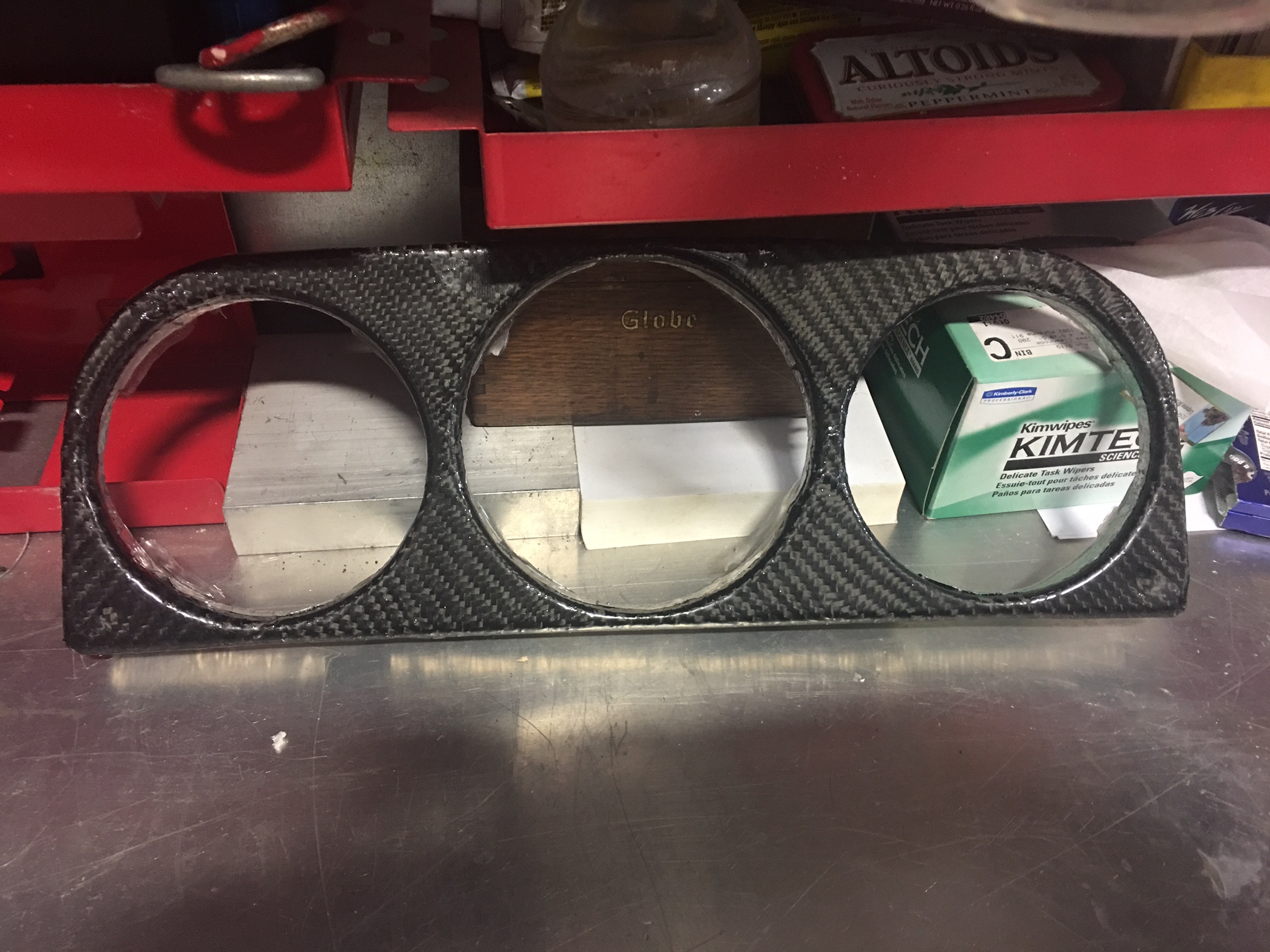

What are the bulbs being shown in the backside photo of the tach by mepstein? And a source would be helpful as well if available. Anything has to be better than the tiny squinting glinters I presently have (stock) and now is the time to try to correct that situation...... if possible... and maybe try on my CF gauge facade... (IMG:style_emoticons/default/beerchug.gif) Attached thumbnail(s) |
