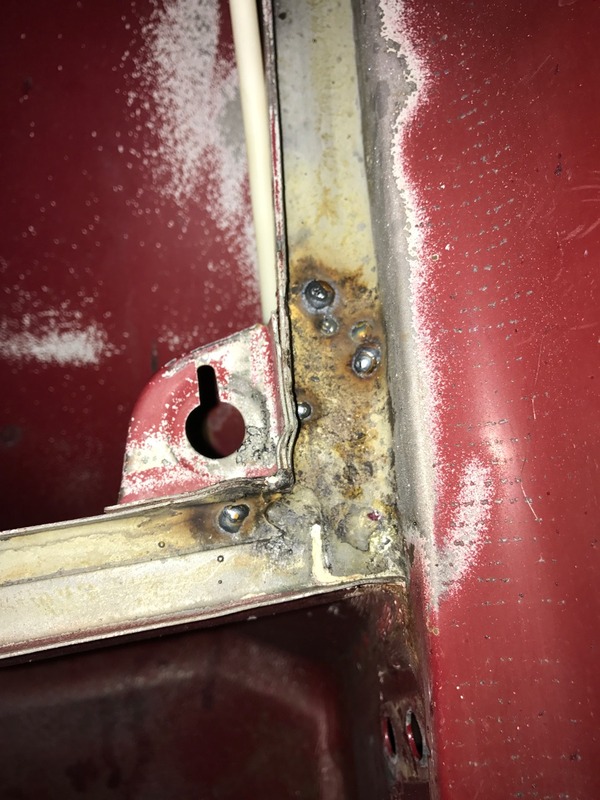

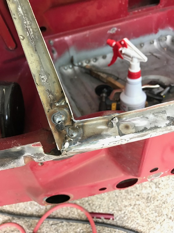

Few more repairs done...
Here is the passenger lower corner rebuilt:
(IMG:http://www.914world.com/bbs2/uploads_offsite/i120.photobucket.com-19557-1491847820.1.jpg)
I was able to drill through the pin-holes and fill with new weld at the driver's upper, outer corner. Will grind and see what I'm left with, hoping this is enough with some rust conversion and encapsulation:
(IMG:http://www.914world.com/bbs2/uploads_offsite/i120.photobucket.com-19557-1491847821.2.jpg)

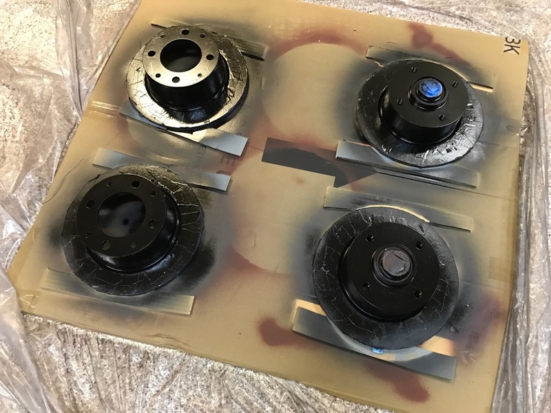

Off topic, but managed to blast and paint my rotors with some satin black. Much better:
(IMG:http://www.914world.com/bbs2/uploads_offsite/i120.photobucket.com-19557-1491847821.3.jpg)
