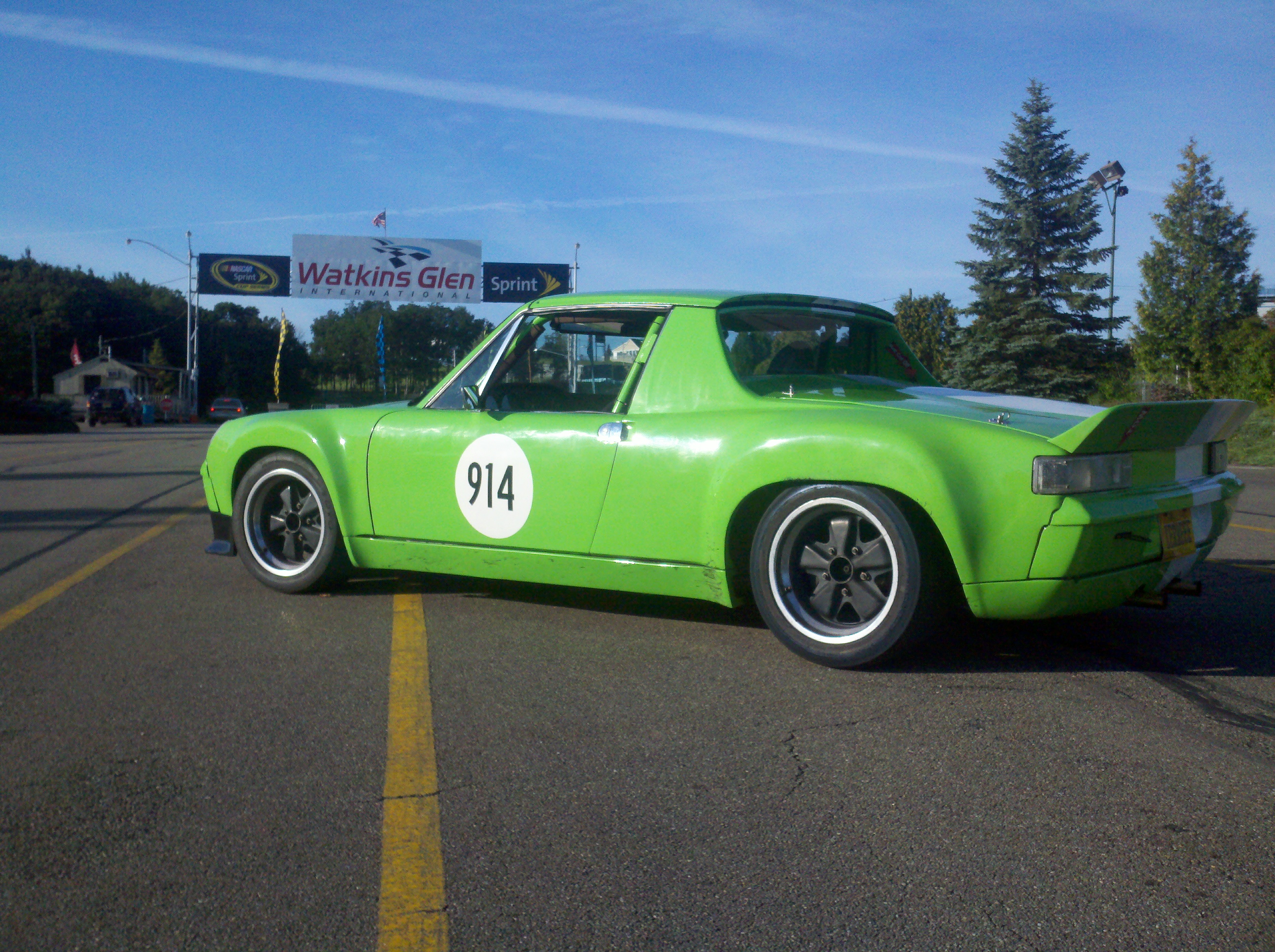

wndsrfr
post Apr 16 2017, 07:43 PM
Posts: 1,468
Joined: 30-April 09
From: Rescue, Virginia
Member No.: 10,318
Here's Lime Green on Kermeee.....Attached Image
