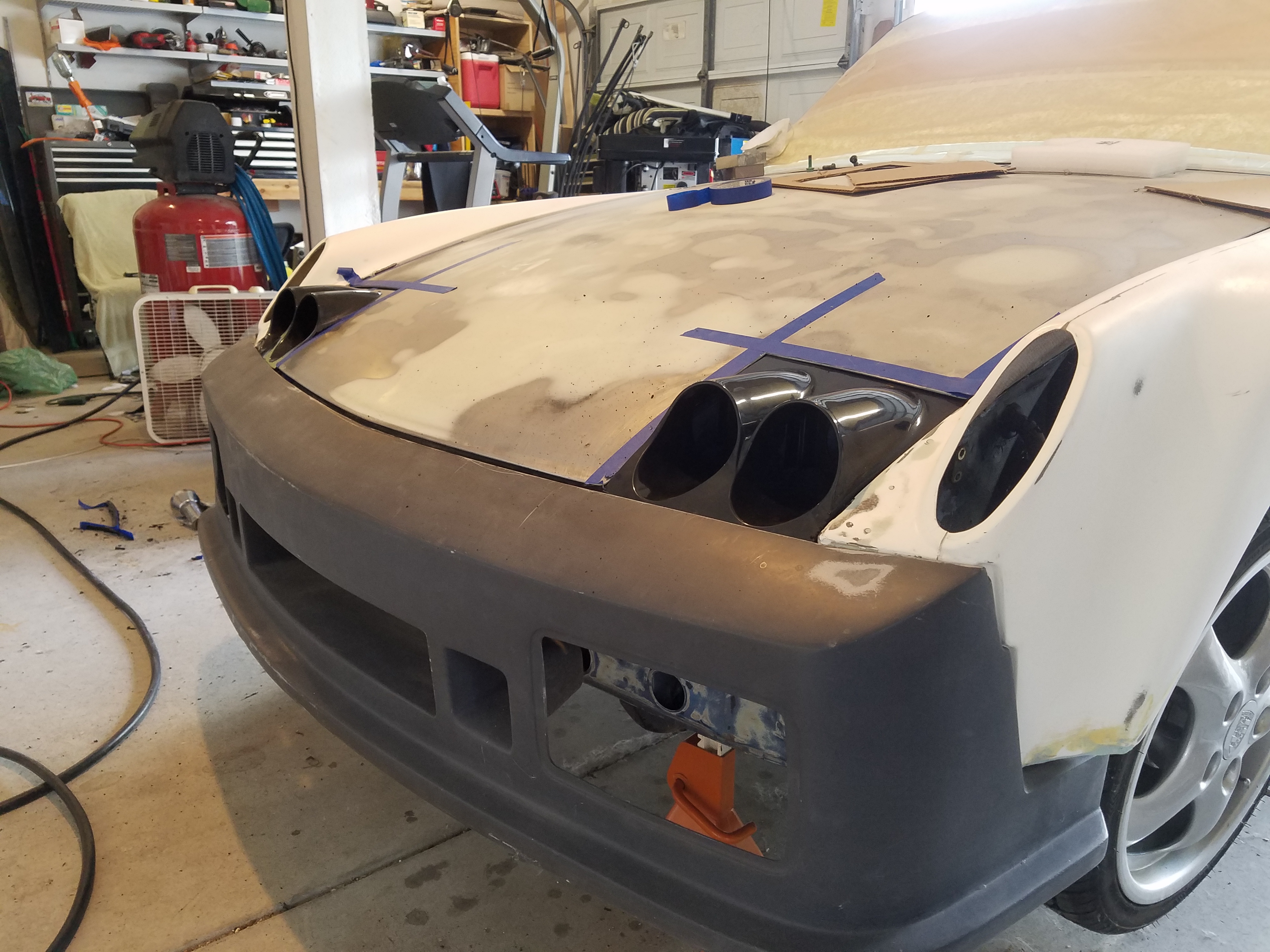

raw1298   Starting to get close.   Apr 17 2017, 05:05 PM
raw1298   Side view   Apr 17 2017, 05:07 PM
ConeDodger   Fantastic progress Randy! :headbanger:   Apr 17 2017, 05:18 PM
raw1298   Thanks Rob. Life is getting simpler, more time to ...   Apr 17 2017, 05:41 PM
raw1298   Starting to get real close.   Apr 18 2017, 05:00 PM
raw1298   Other side   Apr 18 2017, 05:02 PM
