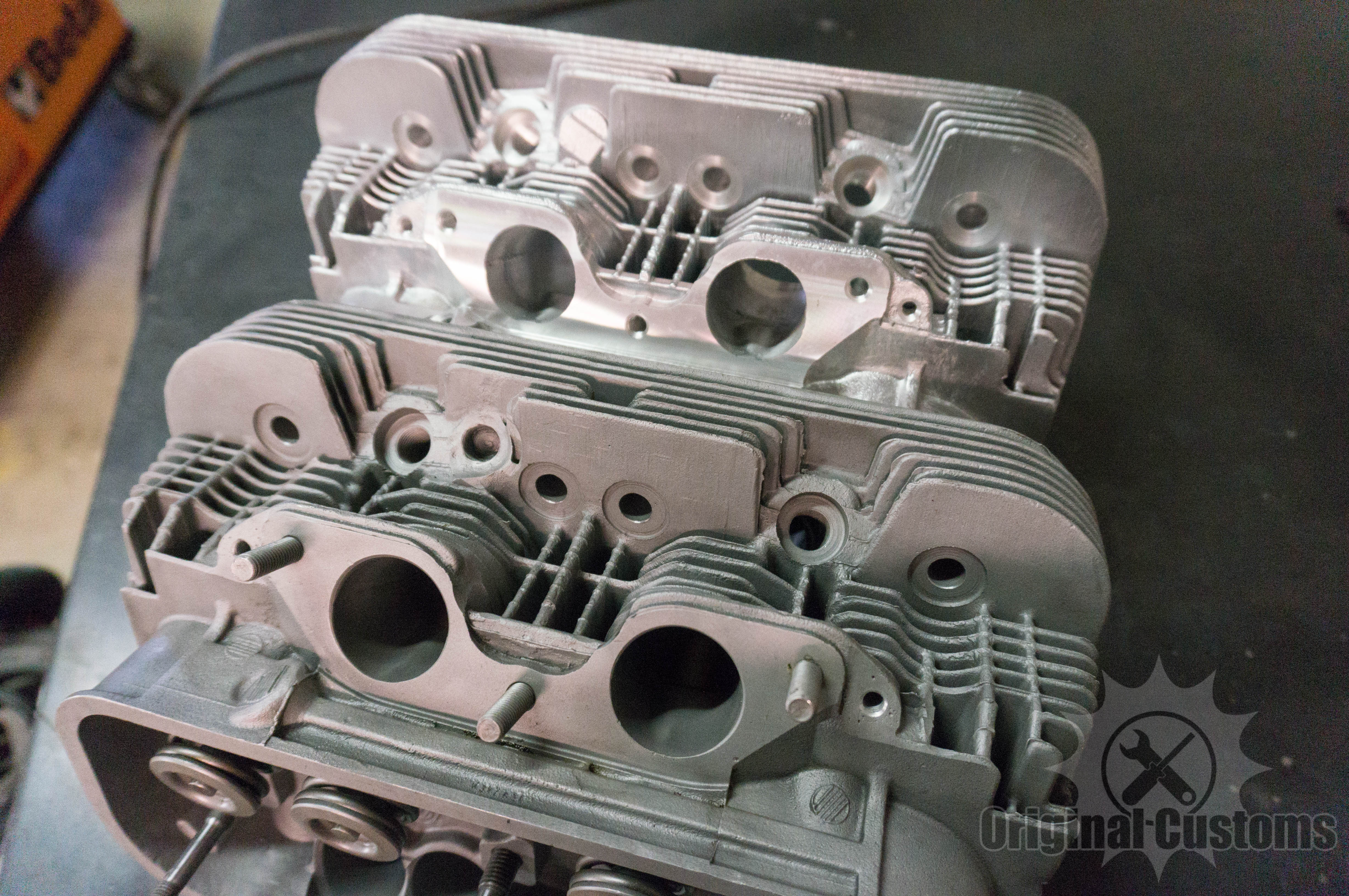

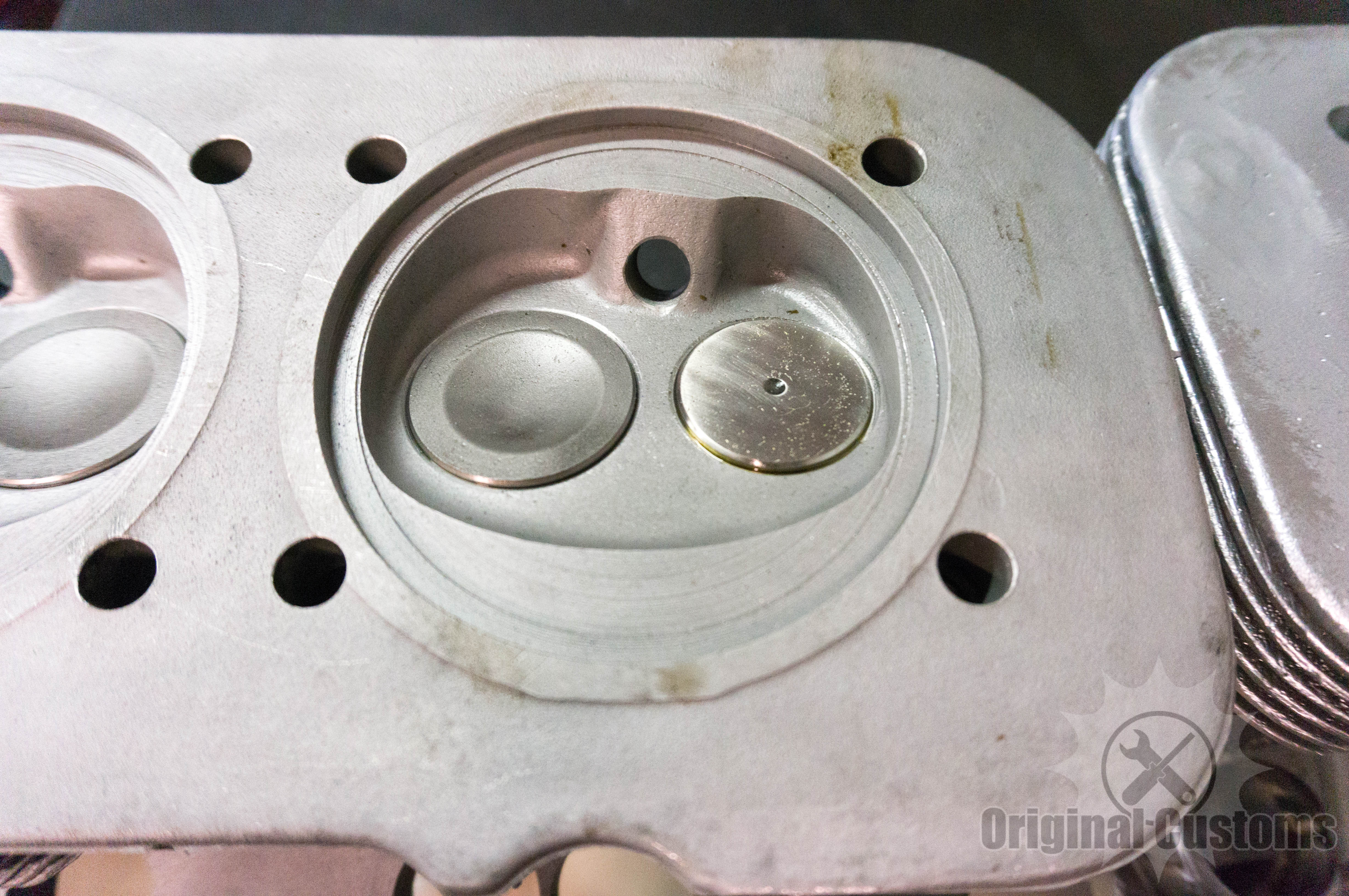

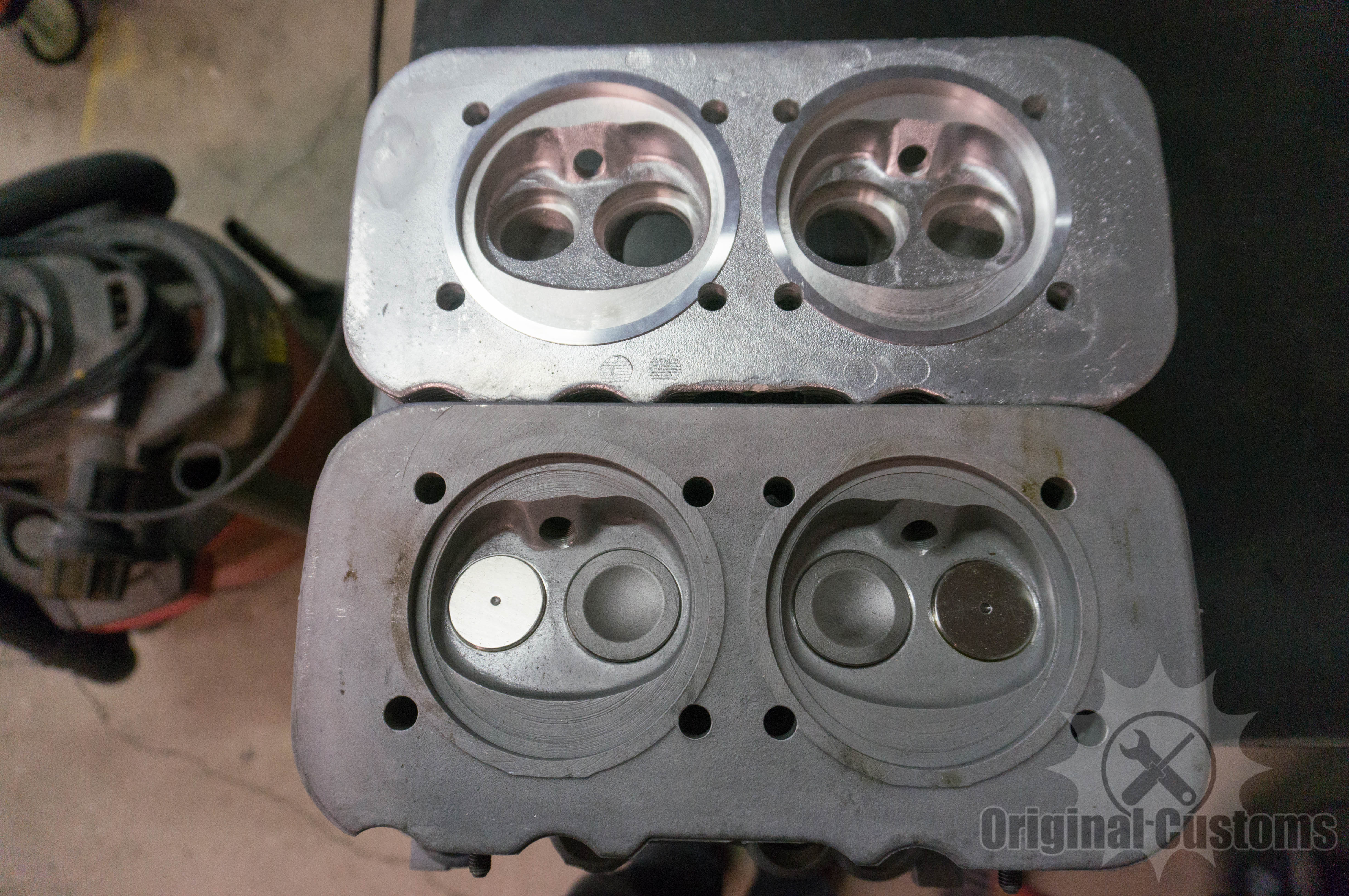

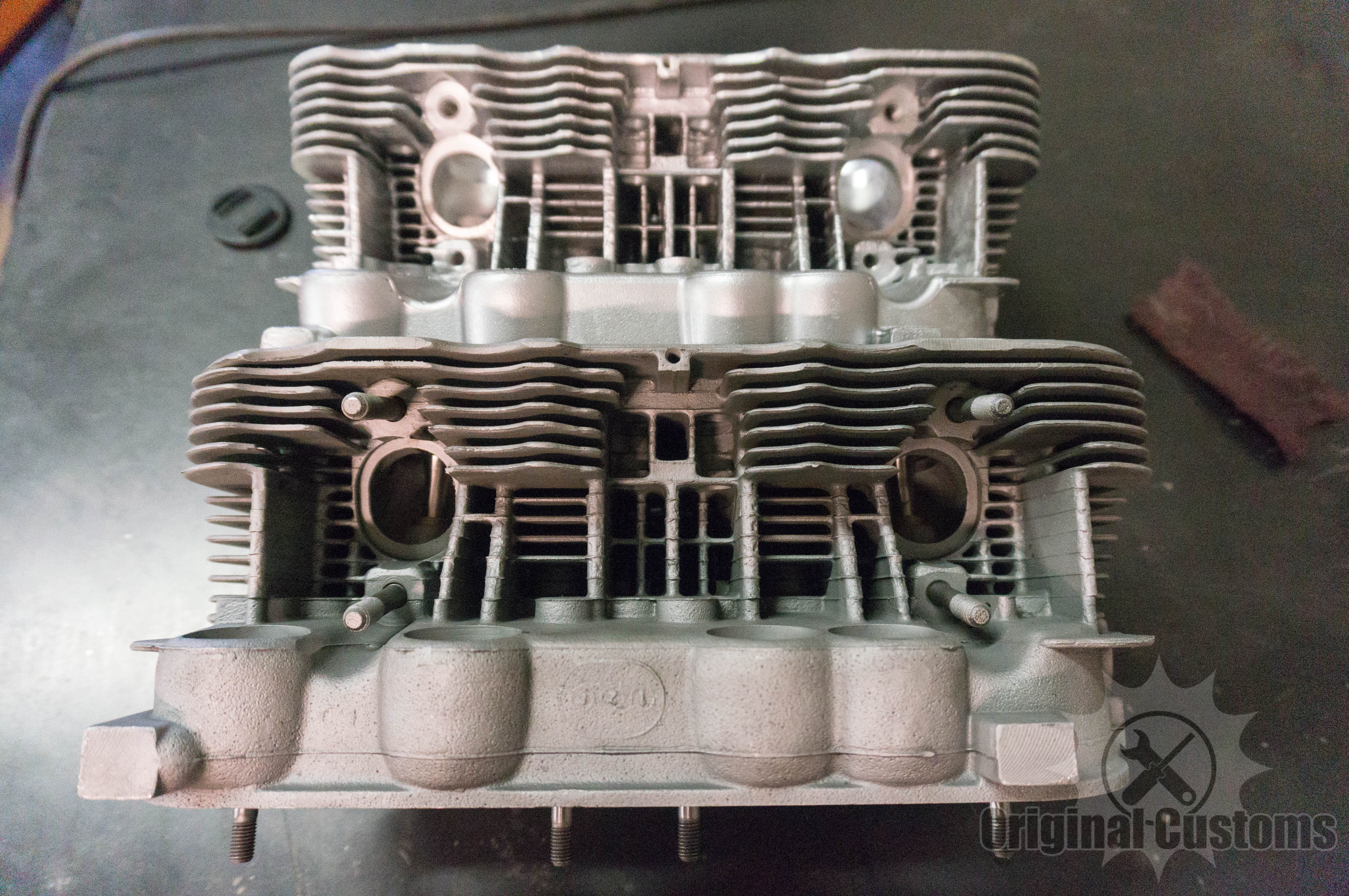

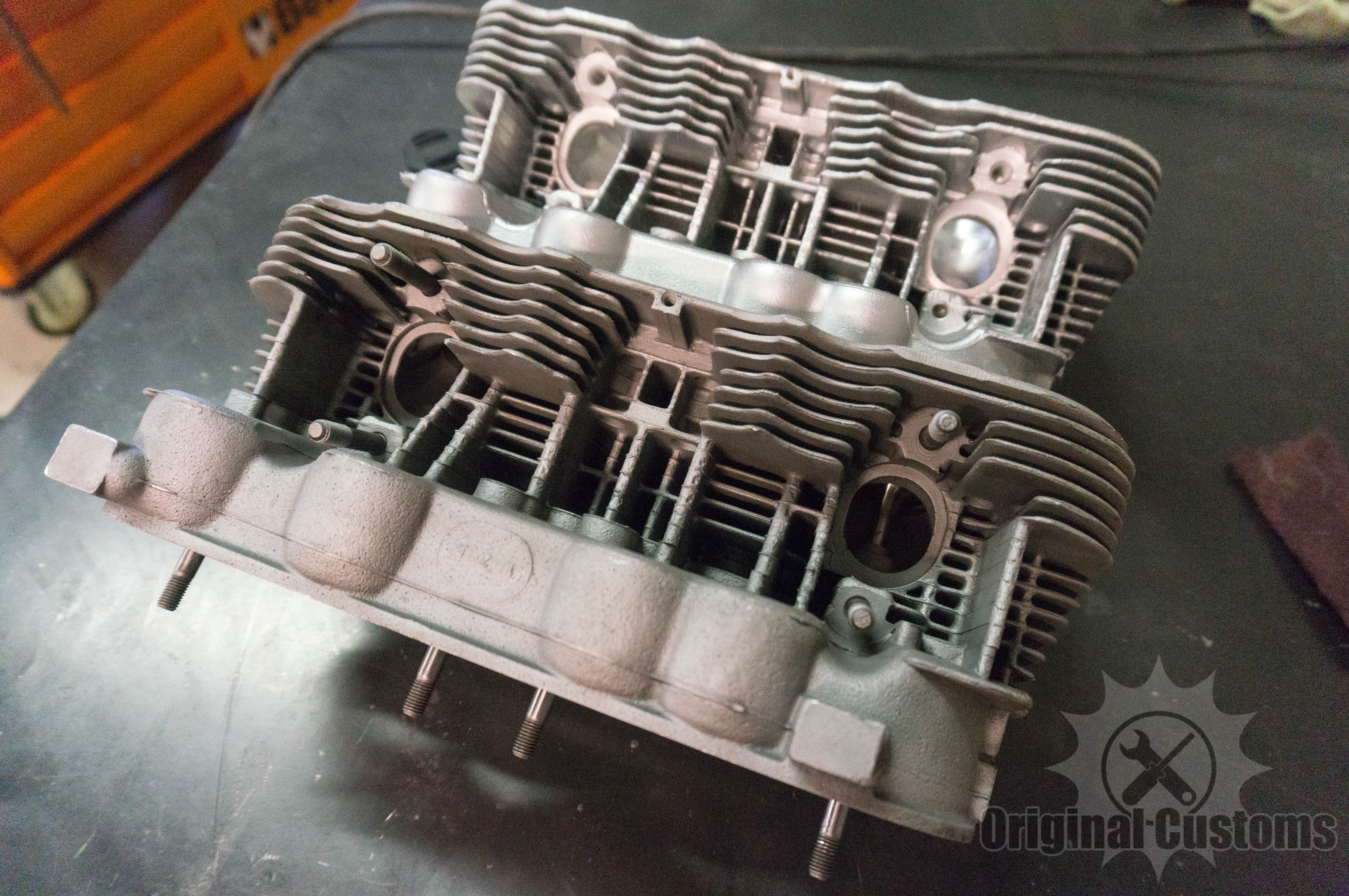

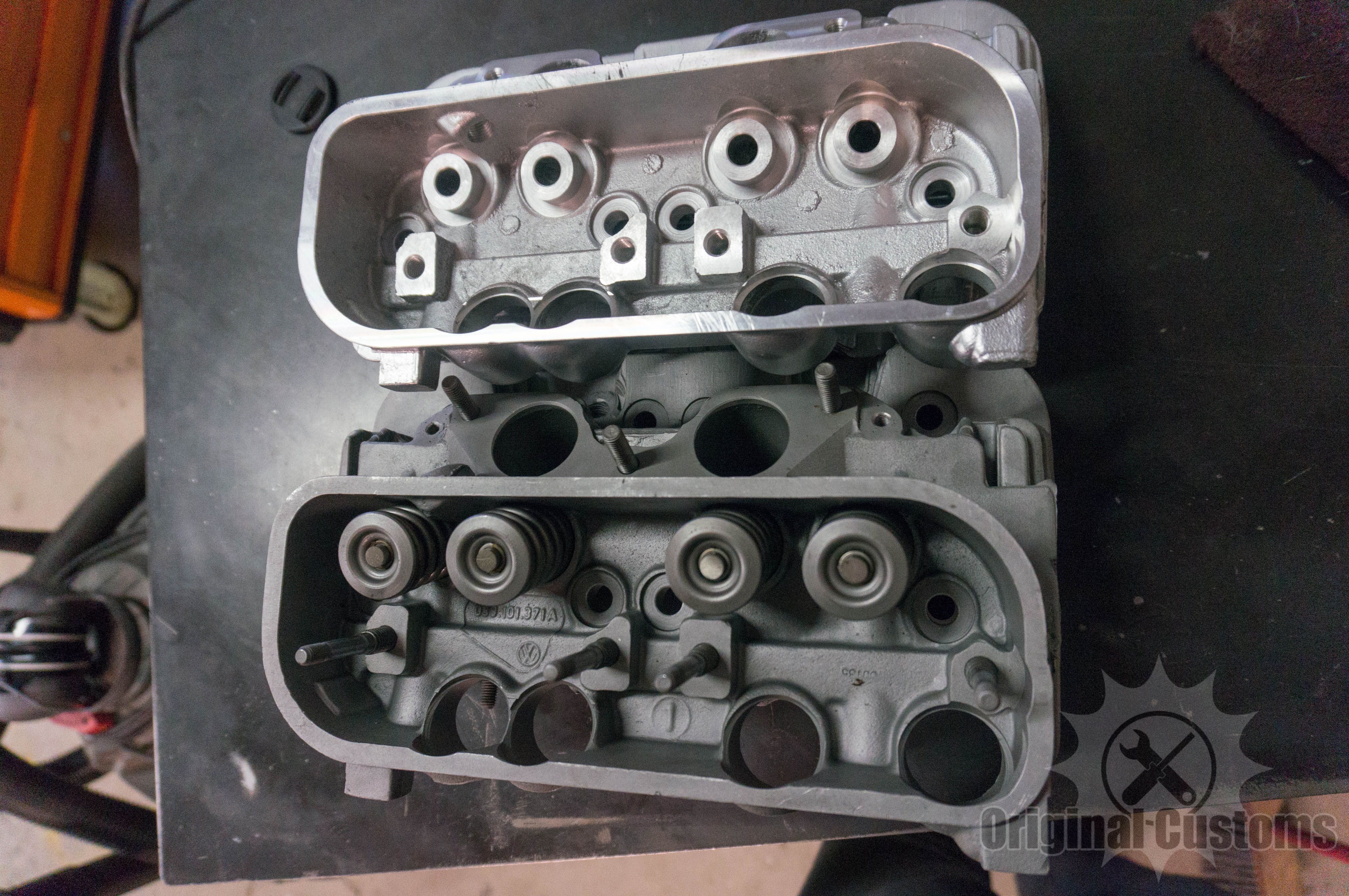

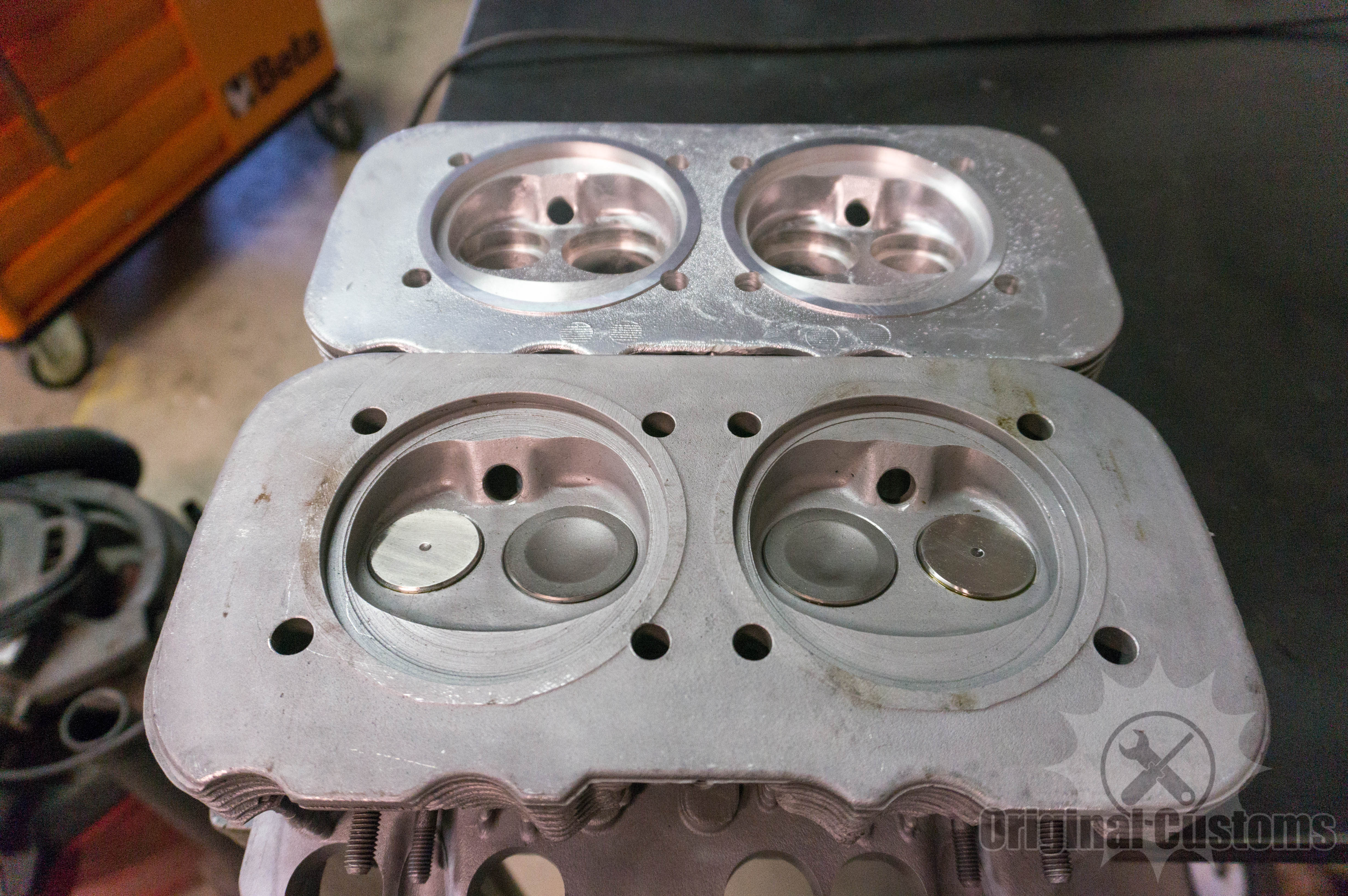

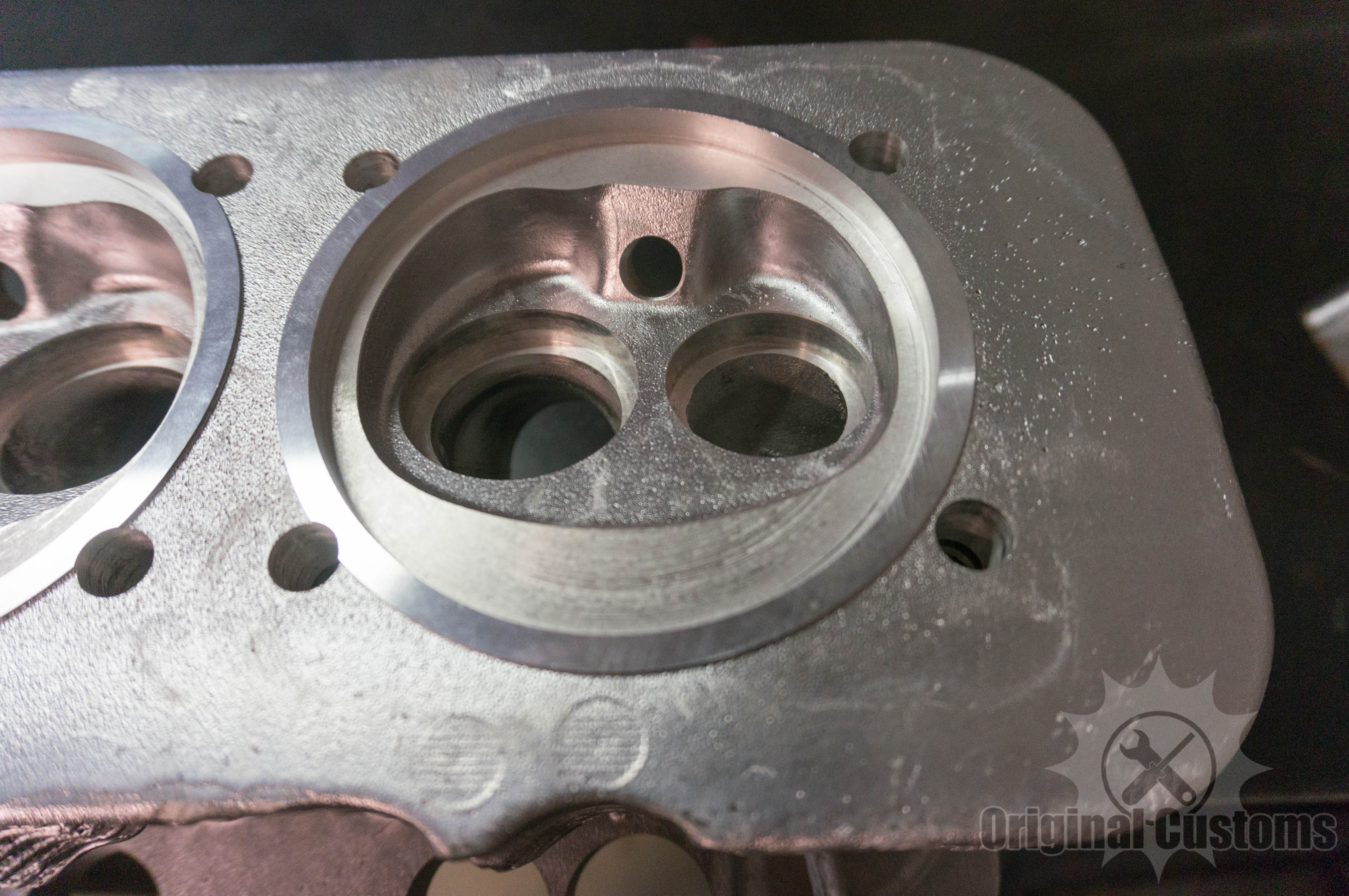

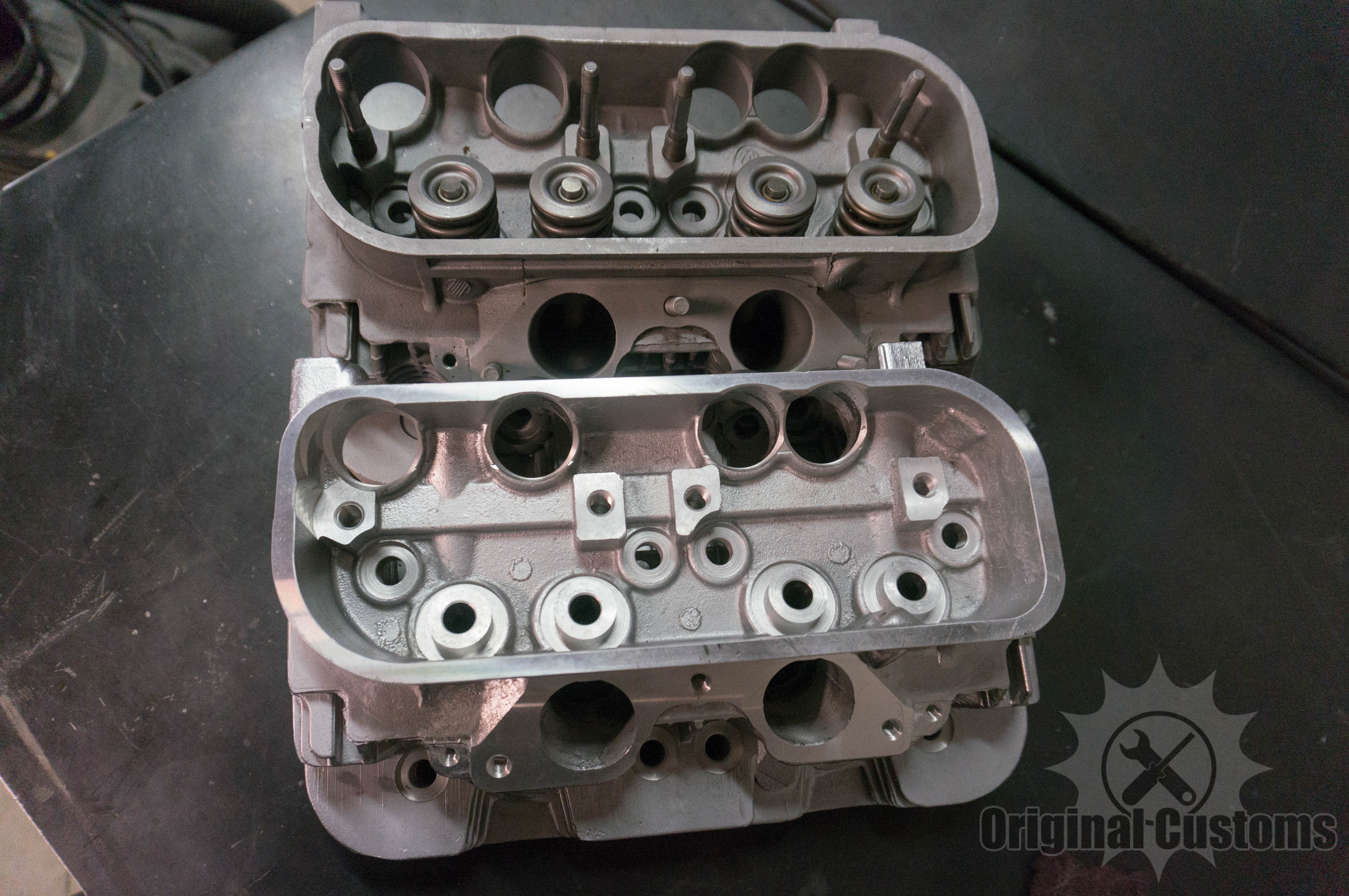

Click the pictures for the full size versions if you want a closer look.
Attached Image Attached Image Attached Image Attached Image Attached Image Attached Image Attached Image Attached Image Attached Image

McMark   Just placed mine. These aren't AMC. AA took ...   Apr 20 2017, 01:24 PM

CMONNETT   I'm curious how good these are. I'm half ...   Apr 27 2017, 12:34 PM
Kansas 914   I'm curious how good these are. I'm half...   Apr 27 2017, 12:37 PM
Mueller   I'm curious how good these are. I'm half...   Apr 27 2017, 12:38 PM
bretth   I recently saw a company selling type VW (edit typ...   Apr 27 2017, 12:56 PM
McMark   [quote name='CMONNETT' post='2480092' date='Apr 2...   Apr 27 2017, 01:12 PM
Kansas 914   This is all very encouraging. Thanks Mark.   Apr 27 2017, 01:20 PM
McMark   Click the pictures for the full size versions if y...   Apr 27 2017, 01:24 PM
Mueller   Nice, thanks for posting. Are you going to instal...   Apr 27 2017, 01:31 PM
Mark Henry   I think I'm going to have to get a set. Nice...   Apr 27 2017, 02:48 PM
rdauenhauer   notice the CHT location isnt drilled/tapped either...   Apr 27 2017, 02:55 PM
HAM Inc   Overall they don't look bad at all for a first...   Apr 27 2017, 03:42 PM
Kansas 914   Overall they don't look bad at all for a firs...   Apr 27 2017, 03:45 PM
914werke   Agreed thanks Len! and a question.. Ive been d...   Apr 27 2017, 04:35 PM
HAM Inc   Agreed thanks Len! and a question.. Ive been ...   Apr 27 2017, 06:17 PM
