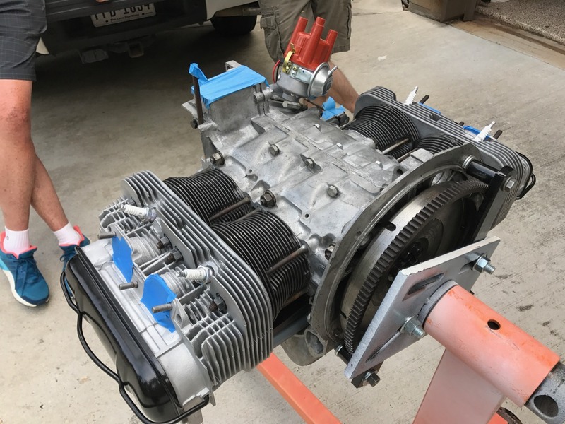

Here's a nice break from all the metal work... I picked up my "new" engine longblock this weekend. This project ended up costing quite a bit more than I had planned once we discovered some of the parts that came with the car were not worth using in the rebuild. I'm taking a nice break from grinding and welding to get the top end assembled so I can hear this thing roar to life.
Here are some specs for the 2056:
-Factory GC Case, align-bored .020" Over
-New DRD C/W Forged 71mm Crankshaft
-New Connecting Rods
-New AA 96MM Pistons
-New Webcam 86a & Lifters
-Original, stock oil pump
-Original, lightened flywheel
-Rebuilt 2.0L Heads
-New Webcam HD single springs
-OE 911 Swivel Adjusters
-9.1:1 Static Compression
Will be adding a pertronix flamethrower III distributor and a set of Empi HPMX IDF 40 dual carbs shortly.

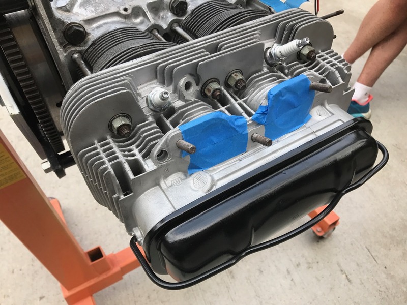

Still amazed by how clean these heads came out after bead blasting:

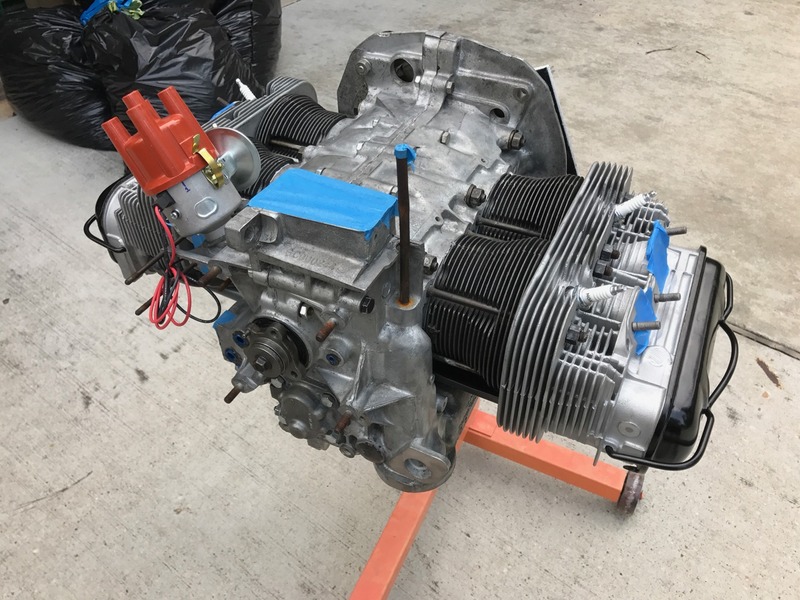

I spent some time test-fitting cooling tin this afternoon. I will get this cleaned up and powder-coated for final assembly:
