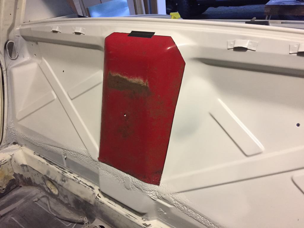

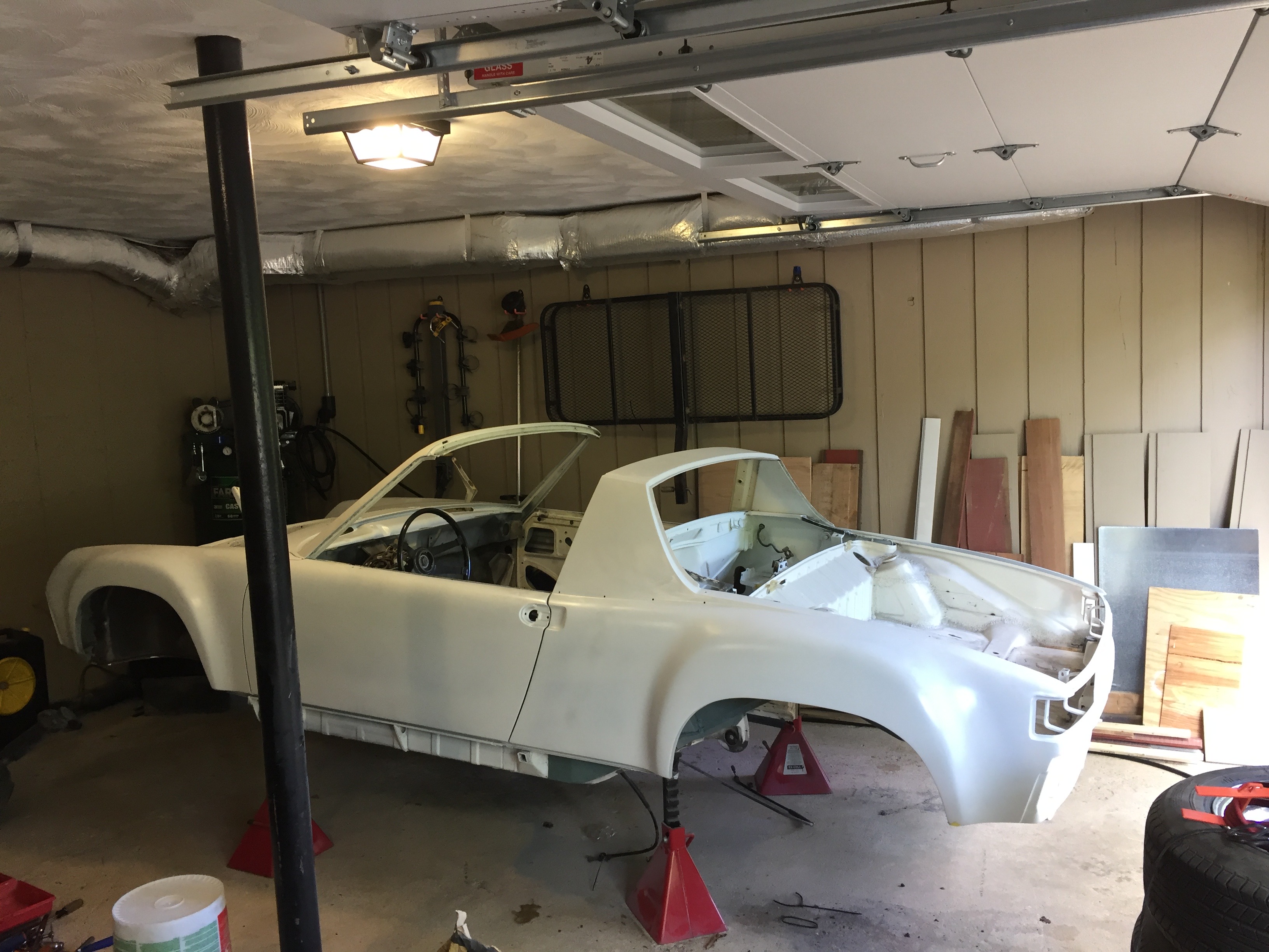

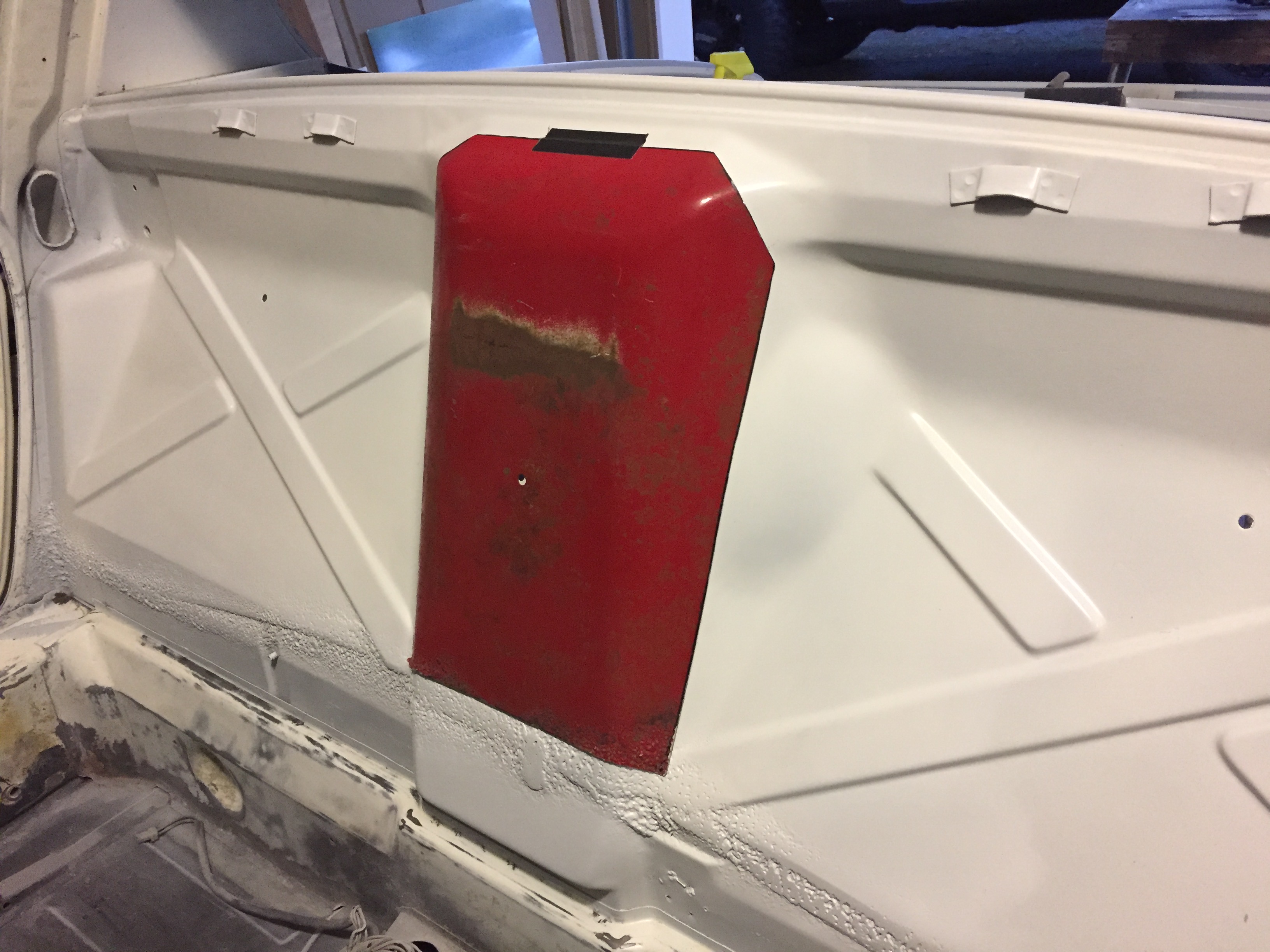

Worked on the metamorphosing 914 most of the day today. Removing the rear suspension was easier than expected; three bolts and three nuts per side. I also removed the hood and rear trunk lid, so now to get it in the air for attaching it to the rotisserie.
I've decided to add an access panel on the firewall. The cover will be made from a section I purchased from 914 Ecology a few days ago. I've completed the rough trim on the cover; real happy with how it turned out.
