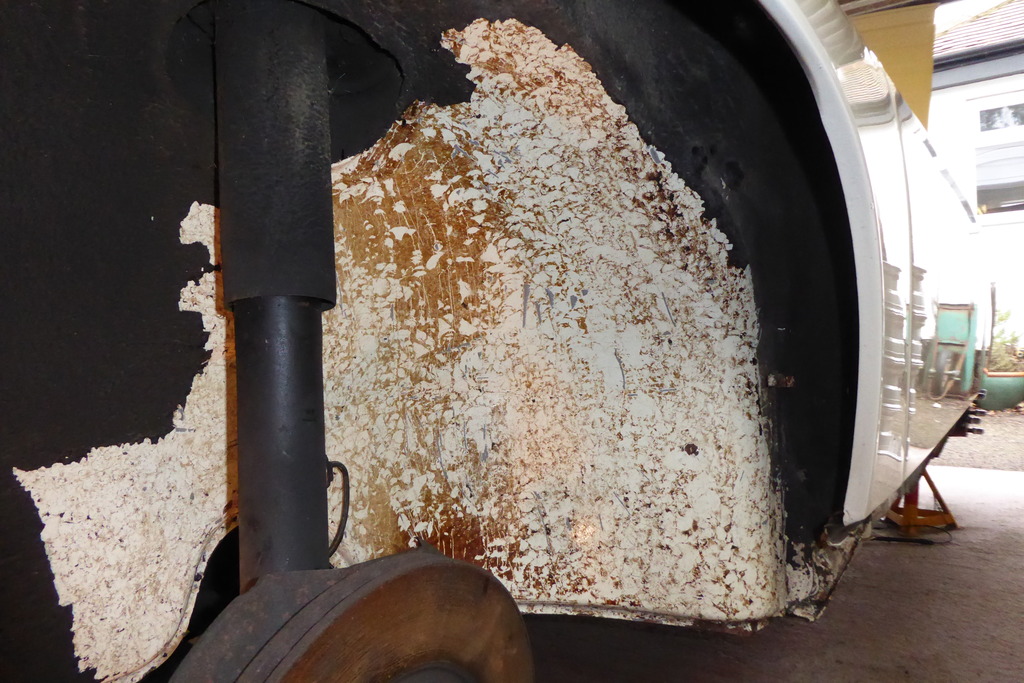

I've been stripping and cataloguing the car for sometime now and I'm finally at the stage where it's just one piece of metal albeit with doors, boot lid and bonnet still attached for safe keeping. No ones tells you just how much space a car takes up when you strip it. Car parts everywhere! :shock:
Overall I'm really impressed with the condition of the car. The excessive amount of underseal that was applied to the car years ago has really done its job thankfully. Removing the stuff has been the bane of my life though, it's everywhere and I mean everywhere. The control arms are covered, the struts, brake lines, cables - it's f£$*ing everywhere :evil:
Getting there...

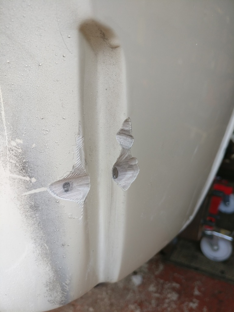

It's never all good news though, I had always suspected the offside rear wing had had a knock in the past. A poke around the other day revealed this.
(IMG:http://www.914world.com/bbs2/uploads_offsite/i176.photobucket.com-6621-1495877447.3.jpg)
:shock: Lovely, but it's what I expected. Fortunately I picked up a nice used rear wing a few months ago so it'll all be replaced and made good.

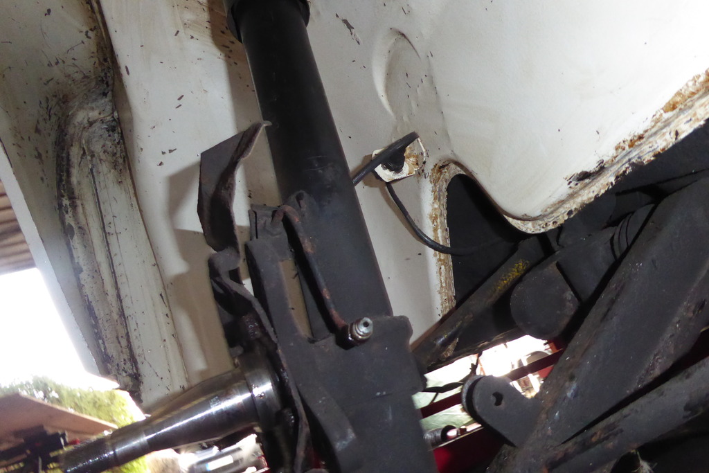

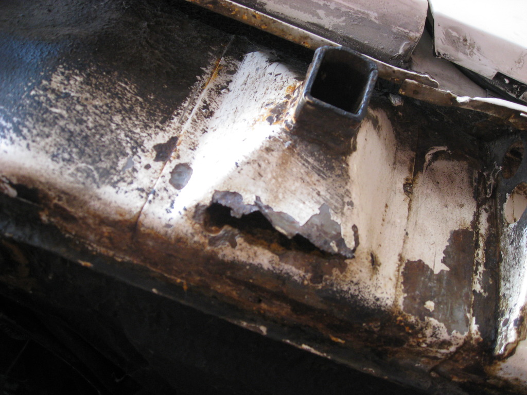

Corrosion wise I think I got away lightly, just a few areas that need attention. The sills were both full of crud around the jacking points. The drainage hole just aren't big enough and it's a common problem with 914's used in the rain frequently and not cleaned properly.
(IMG:http://www.914world.com/bbs2/uploads_offsite/i176.photobucket.com-6621-1495877448.4.jpg)
They'll both be removed and replaced with new.
There's a small amount of rust in the hell hole which is easily sorted and a large patch on the firewall due to a soggy sound pad. Usual 914 stuff. Other than a small patch at the base of the windscreen on the scuttle that's it, so not bad at all.
