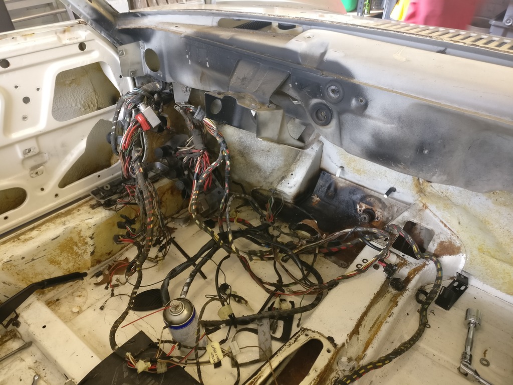

I've been held up for a few weeks as the powder coater was on holiday and I only dropped parts off to him last week. And despite dropping off all the parts to be plated three weeks ago to the platers, it's all still sitting there in the bucket I delivered it in. Slightly frustrating but they did explain restoration projects take a back seat to their mainstream work.
Last week Rich (abzadams) came down for the day to lend a hand and help pull out the wiring loom. Definitely a two man job, and not one I was looking forward too. It's surprising though after spending so much time on the car I can almost identify any wire and name where it goes. All of a sudden the wiring doesn't look as daunting as I first thought. The fun though, will be mating up with the SC harness several months down the line; a job I'm really not relishing.
Almost there...

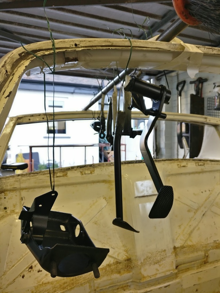

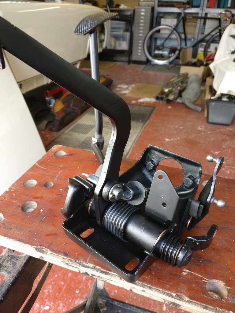

Rather than just strip the car and pack it away I decided to restore parts along the way, it was nice to be able to jump back and forwards and also rewarding to see parts being refreshed.
I won't go in to any detail and most of these have been covered in detail many times before.

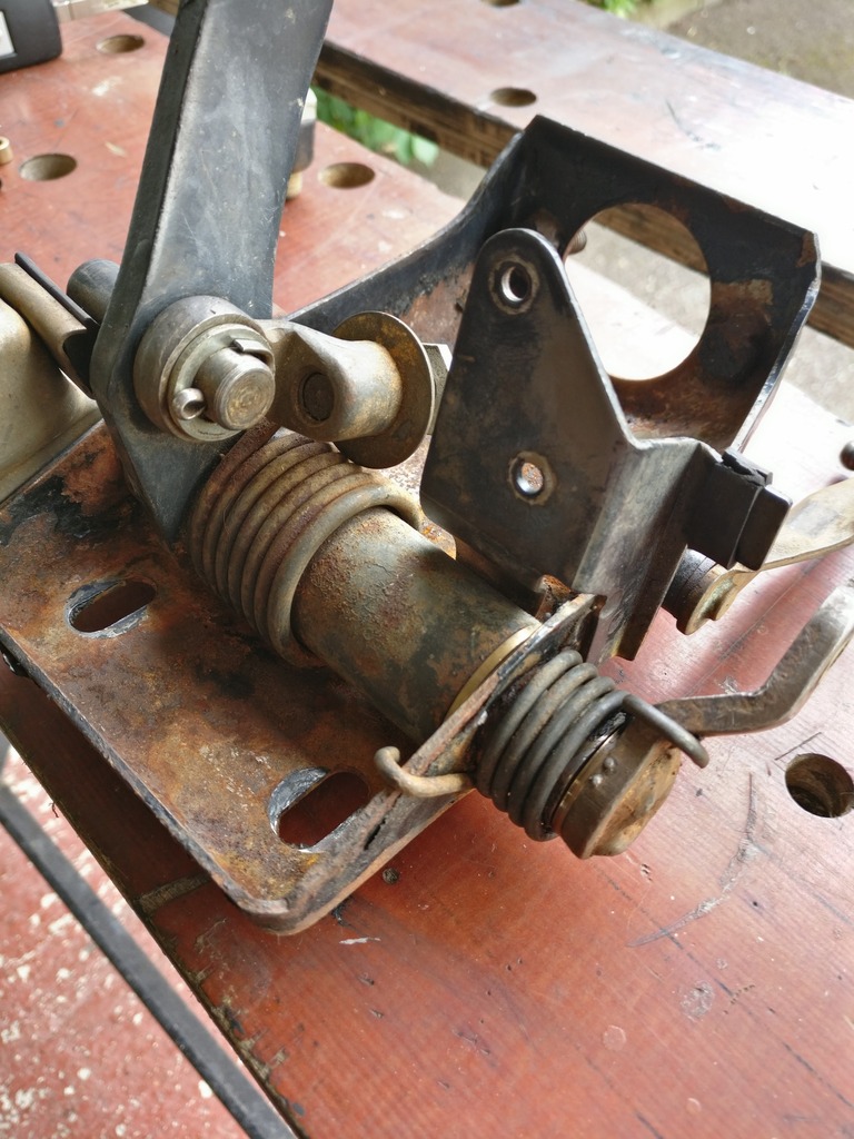

Despite being upgraded with bronze bushes at some time in its past the pedal cluster was looking a little rough so I set about stripping and repainting. I also added a new set of bronze bushes for good measure.
Before

After - Much nicer.
(IMG:http://www.914world.com/bbs2/uploads_offsite/i176.photobucket.com-6621-1495877605.4.jpg)
