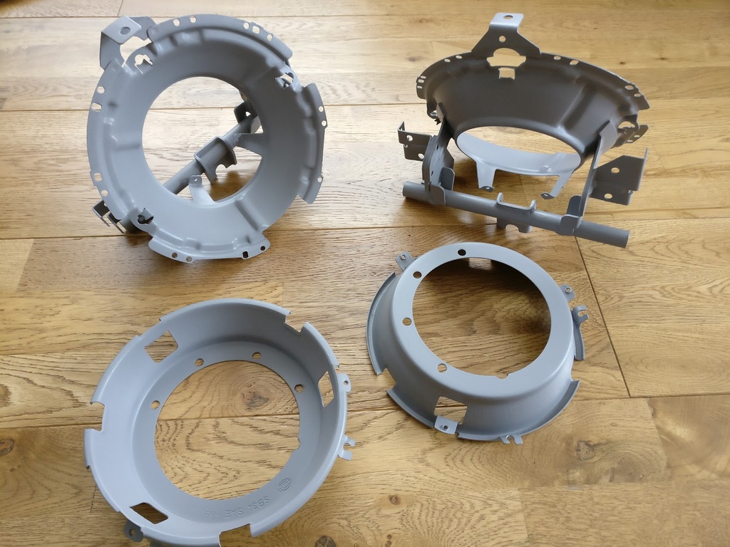

Not much work has happened on the shell the last couple of weeks. I decided it was time to upgrade my compressor and stupidly sold the old one before it's replacement arrived. And when it did arrive it was DOA. Long boring story but I finally got another one yesterday and I'm in business again.
Whilst that was going on I got to restoring a few other bits and pieces.

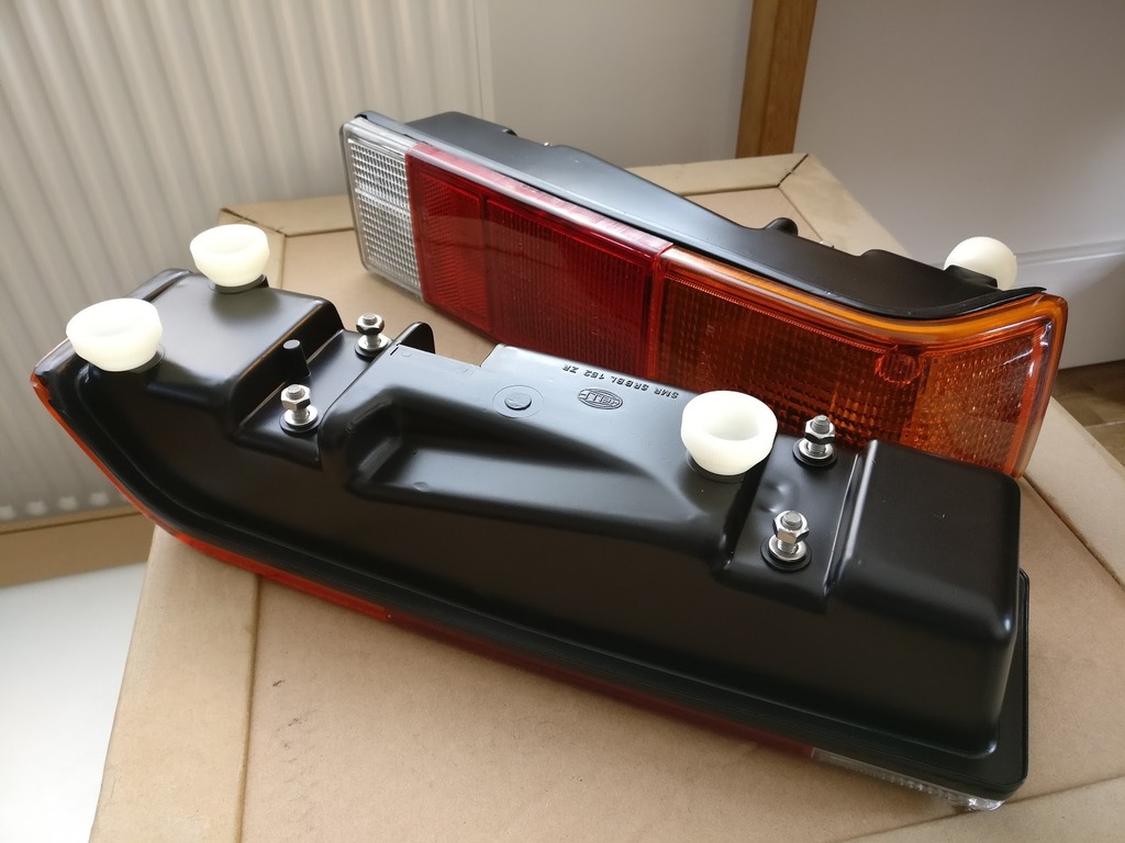

Starting with these.
(IMG:http://www.914world.com/bbs2/uploads_offsite/i176.photobucket.com-6621-1495877720.1.jpg)
They were in a shocking condition and despite trying the method Darren used to restore his, painting them was going to be the only solution. The internals were all revamped too. Those white thumbscrews had yellowed significantly over the years but a bath in bleach and Vanish for a week brought them back to life (IMG:style_emoticons/default/laugh.gif)
So with the back lights done it was on to the front.

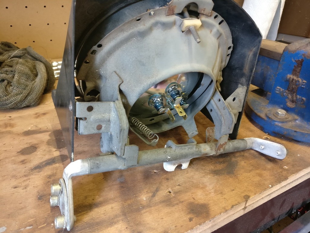

(IMG:http://www.914world.com/bbs2/uploads_offsite/i176.photobucket.com-6621-1495877720.2.jpg)
Yes they needed work and it was time to replace the old sealed units with some H4's

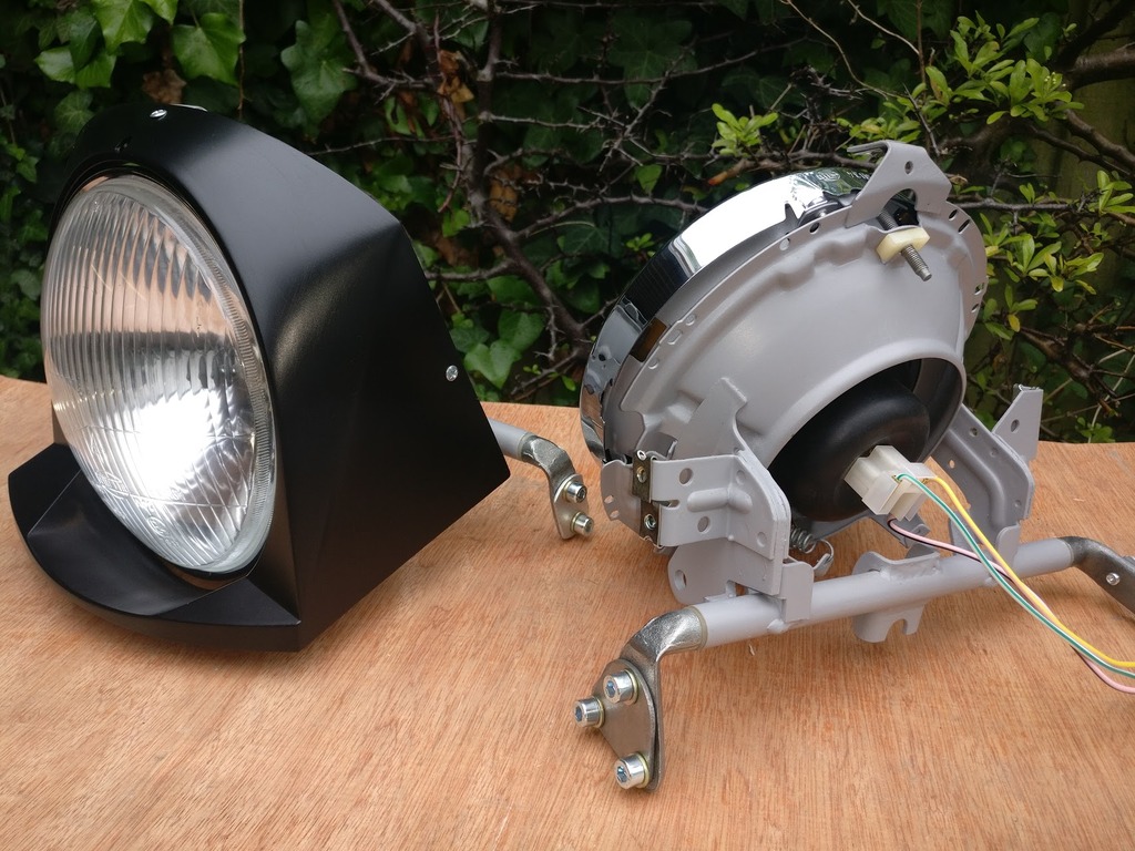

Fully stripped and repainted. I found that RAL 7046 Telegray 2 was a fairly good match to the original and ordered an aerosol from an online supplier.
(IMG:http://www.914world.com/bbs2/uploads_offsite/i176.photobucket.com-6621-1495877721.3.jpg)
And finished with all new fittings and H4 connector as the originals shattered when I touched them.
(IMG:http://www.914world.com/bbs2/uploads_offsite/i176.photobucket.com-6621-1495877721.4.jpg)
