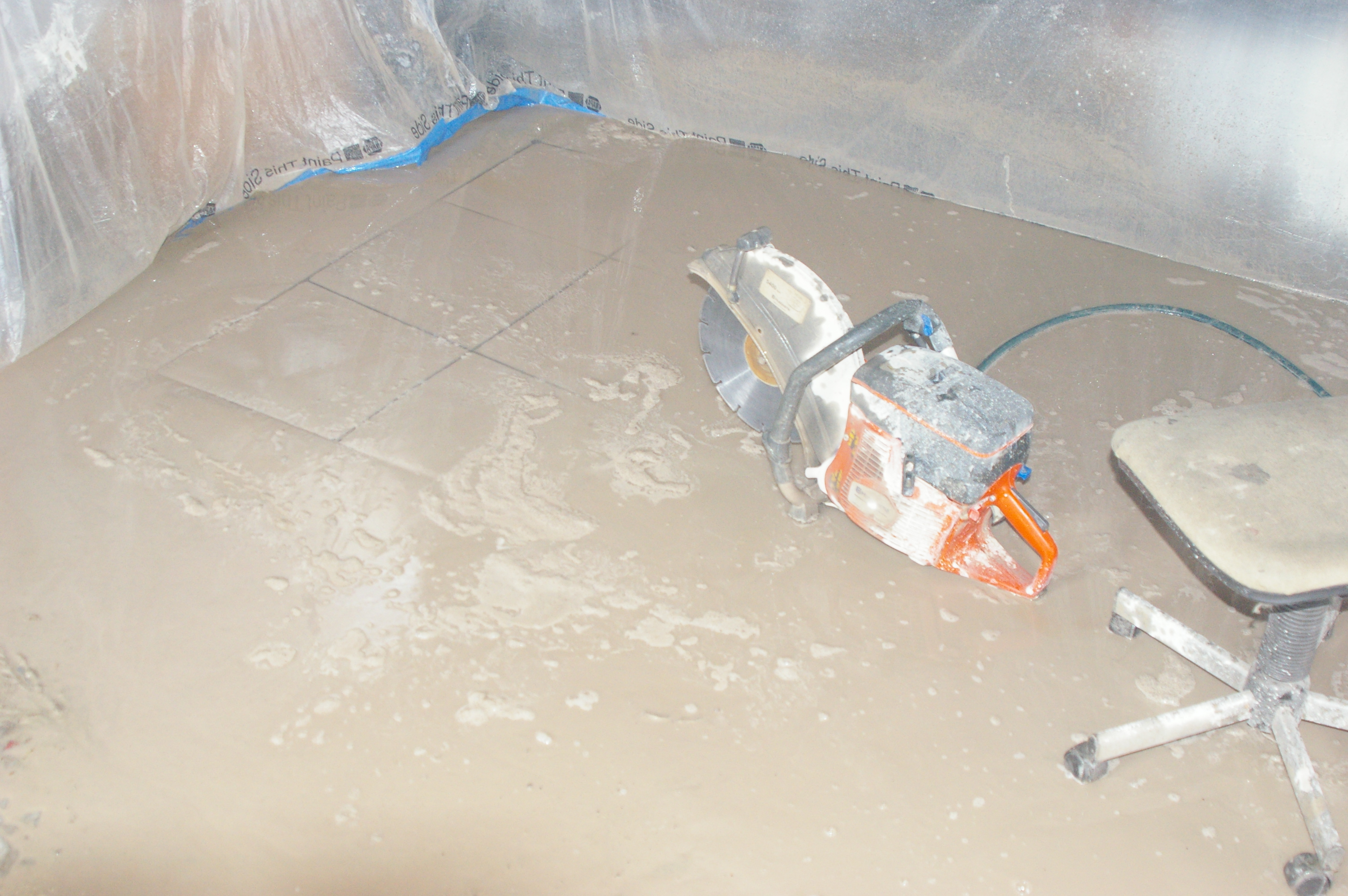

when I cut the floor for a thicker pads I used a concrete saw with water, made a mess but didn't create any dust. I used floor anchors that were epoxied in, they are not going to pull out
