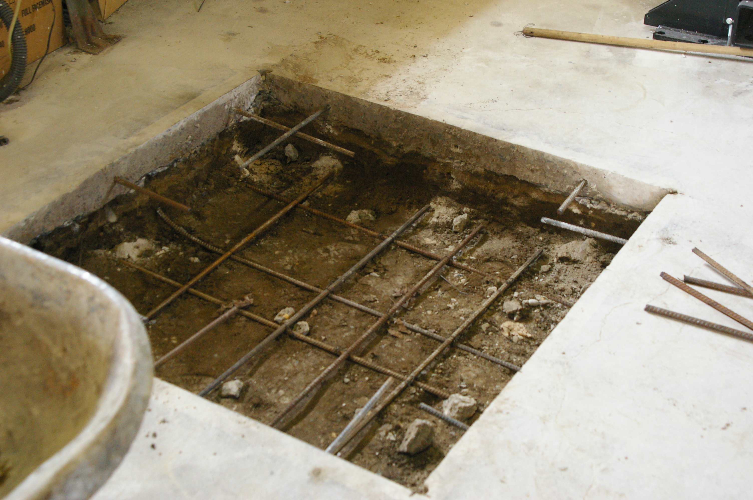

my floor was also only about 4", IFIR they recommend at least 6". I poured 4' x 4' pad about 8" to 10" thick of high psi cement

Phoenix-MN   when I cut the floor for a thicker pads I used a c...   Jun 1 2017, 02:45 PM
Vacca Rabite   when I cut the floor for a thicker pads I used a ...   Jun 1 2017, 08:04 PM
Phoenix-MN   my floor was also only about 4", IFIR they re...   Jun 2 2017, 08:33 PM
