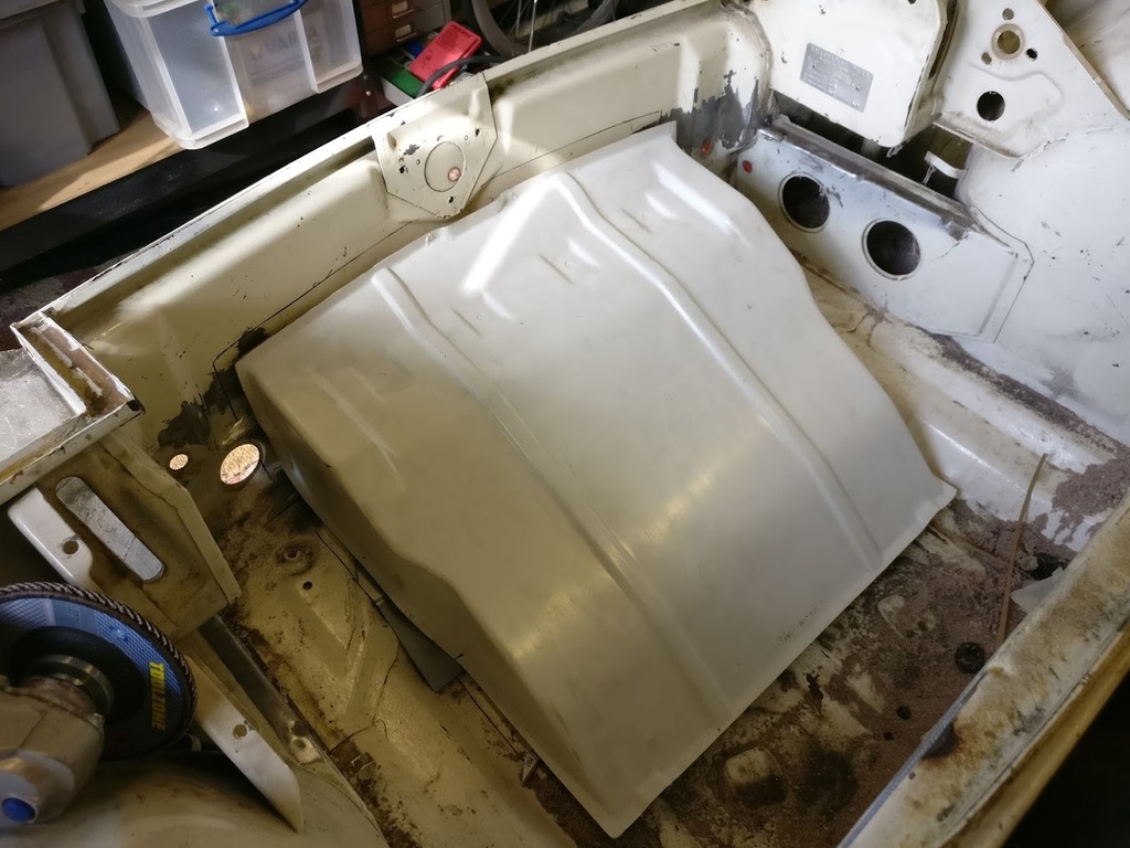

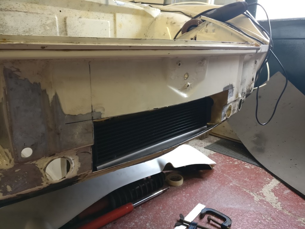

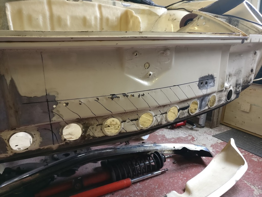

A job I've been wanting to make a start on for a while was the front oil cooler. Because I don't intend on building an exact GT replica there was no need for the expensive of a original Behr oil cooler - fortunately.
A while back I got a GRP copy of the GT cooler shroud, with this came a piece that went under the cooler itself. I didn't like the fit of this so wanted to do something else. Fortunately from following 23heure's build the guys who built his car came up with a better solution and I adapted mine from that.
Cooler Shroud in Place.

Measure twice - cut once!
(IMG:http://www.914world.com/bbs2/uploads_offsite/i176.photobucket.com-6621-1497038202.2.jpg)
Phew!
(IMG:http://www.914world.com/bbs2/uploads_offsite/i176.photobucket.com-6621-1497038202.3.jpg)

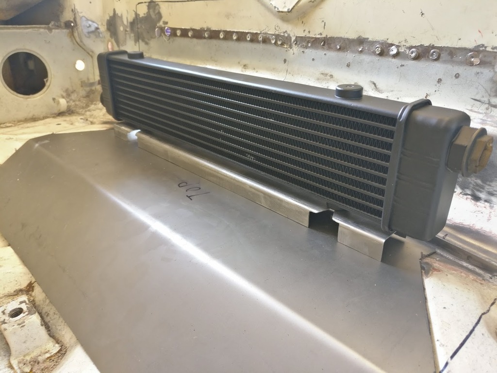

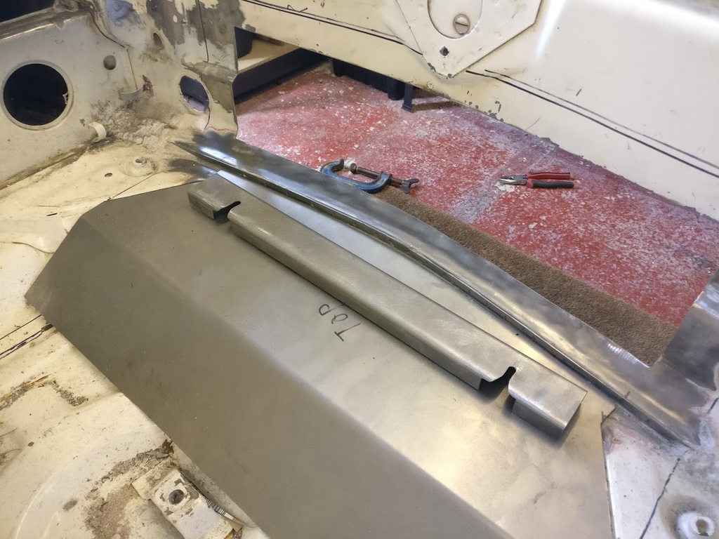

Fabricated lower panel and oil cooler mount. These need welding together.
(IMG:http://www.914world.com/bbs2/uploads_offsite/i176.photobucket.com-6621-1497038202.4.jpg)
Oil cooler in place.
(IMG:http://www.914world.com/bbs2/uploads_offsite/i176.photobucket.com-6621-1497038202.5.jpg)
