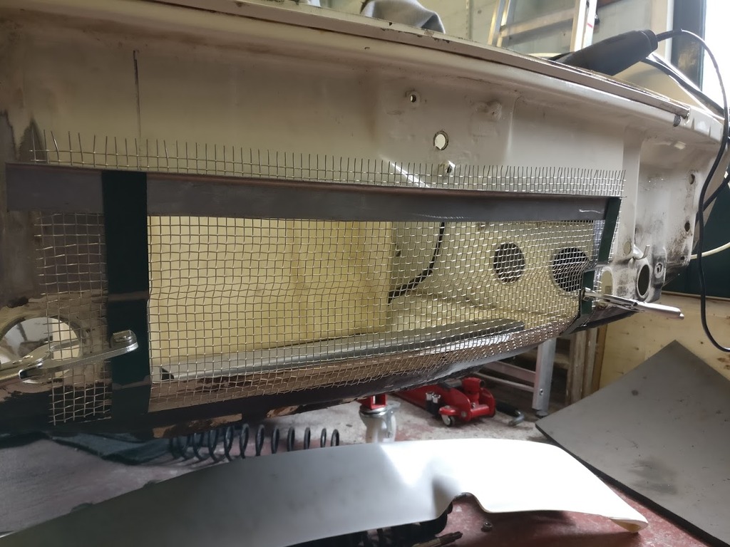

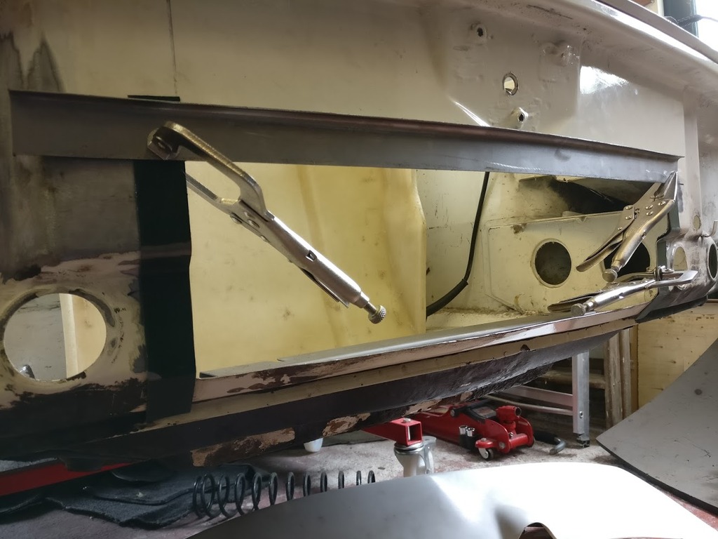

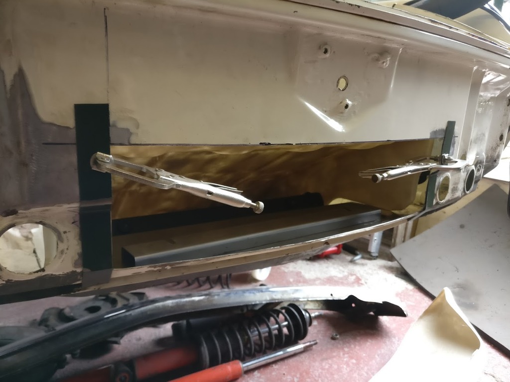

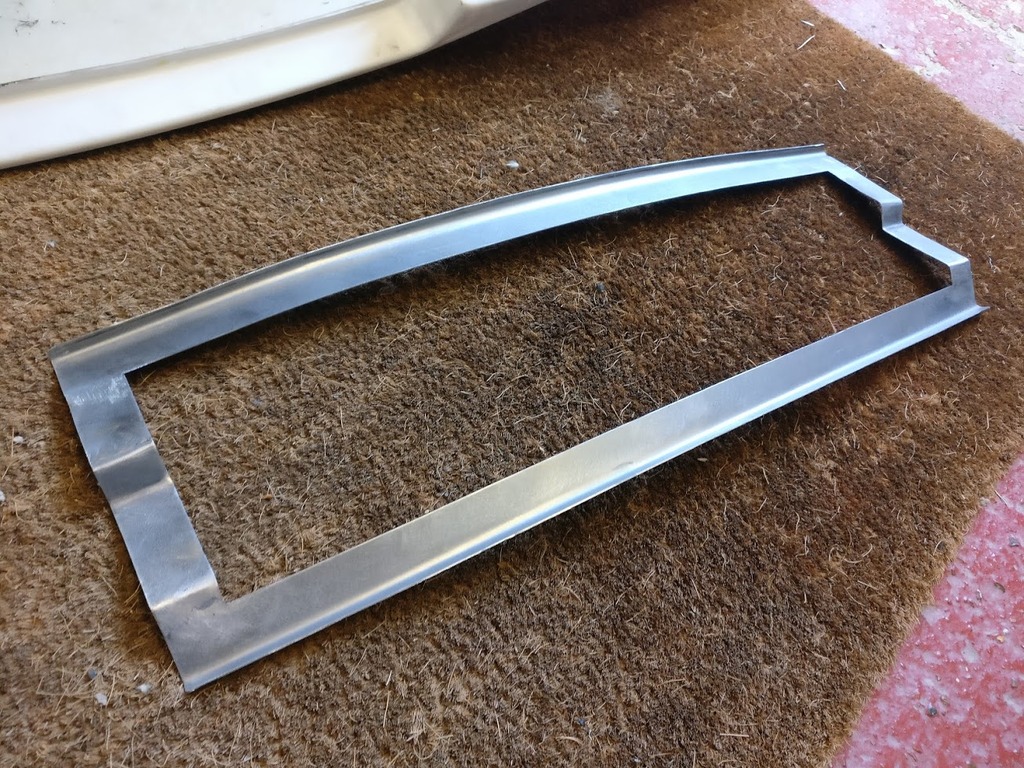

I wanted to fabricate a GT style grill - this is what I came up with.
Starting with the side parts - Metal used here was for a 914 engine lid I used to make my GT lid.
(IMG:http://www.914world.com/bbs2/uploads_offsite/i176.photobucket.com-6621-1497038277.1.jpg)
Top part...
(IMG:http://www.914world.com/bbs2/uploads_offsite/i176.photobucket.com-6621-1497038277.2.jpg)
Trying the grill for size. I used the cut out piece to help form the shape.
(IMG:http://www.914world.com/bbs2/uploads_offsite/i176.photobucket.com-6621-1497038277.3.jpg)

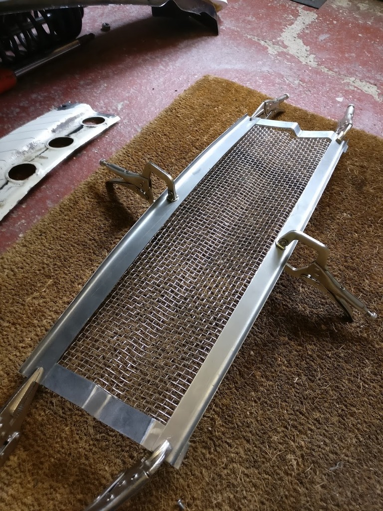

Bottom piece fabricated, cleaned and ready to weld up.
(IMG:http://www.914world.com/bbs2/uploads_offsite/i176.photobucket.com-6621-1497038277.4.jpg)

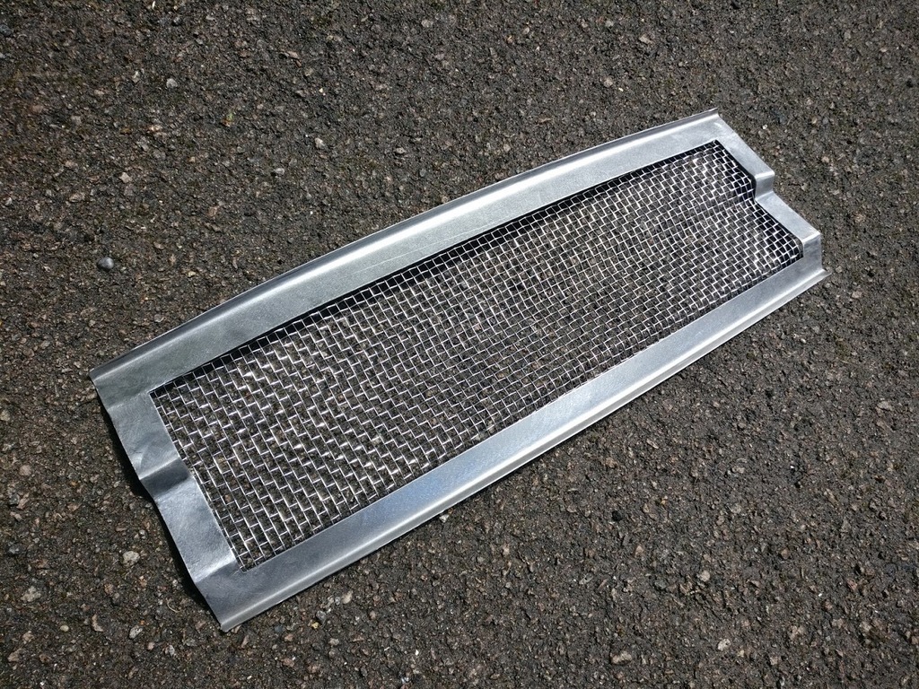

Frame welded and finished.
(IMG:http://www.914world.com/bbs2/uploads_offsite/i176.photobucket.com-6621-1497038278.5.jpg)
The finished piece...
(IMG:http://www.914world.com/bbs2/uploads_offsite/i176.photobucket.com-6621-1497038278.6.jpg)

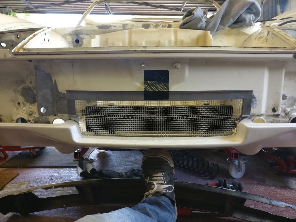

Held in place along with GT valance.
(IMG:http://www.914world.com/bbs2/uploads_offsite/i176.photobucket.com-6621-1497038278.7.jpg)
I'm happy with that. Now to test fit with the bumper once the relevant fittings arrive.
