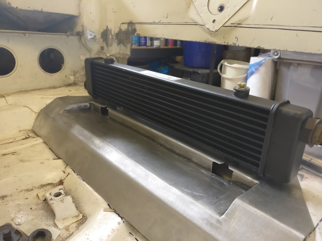

It was my initial plan to use the original oil cooler fixing holes on the oil cooler shroud to fix on to my oil cooler with an adaptor plate. This was completely unnecessary but would look more correct. After going over what I'd done previously I found the oil cooler was sitting just a bit too high. So I set about modifying it all to enable me to lower it.
After a few hours I came up with this. I think it's a much better solution and I now have the room above for the adaptor plate.
(IMG:http://www.914world.com/bbs2/uploads_offsite/i176.photobucket.com-6621-1497284104.1.jpg)
