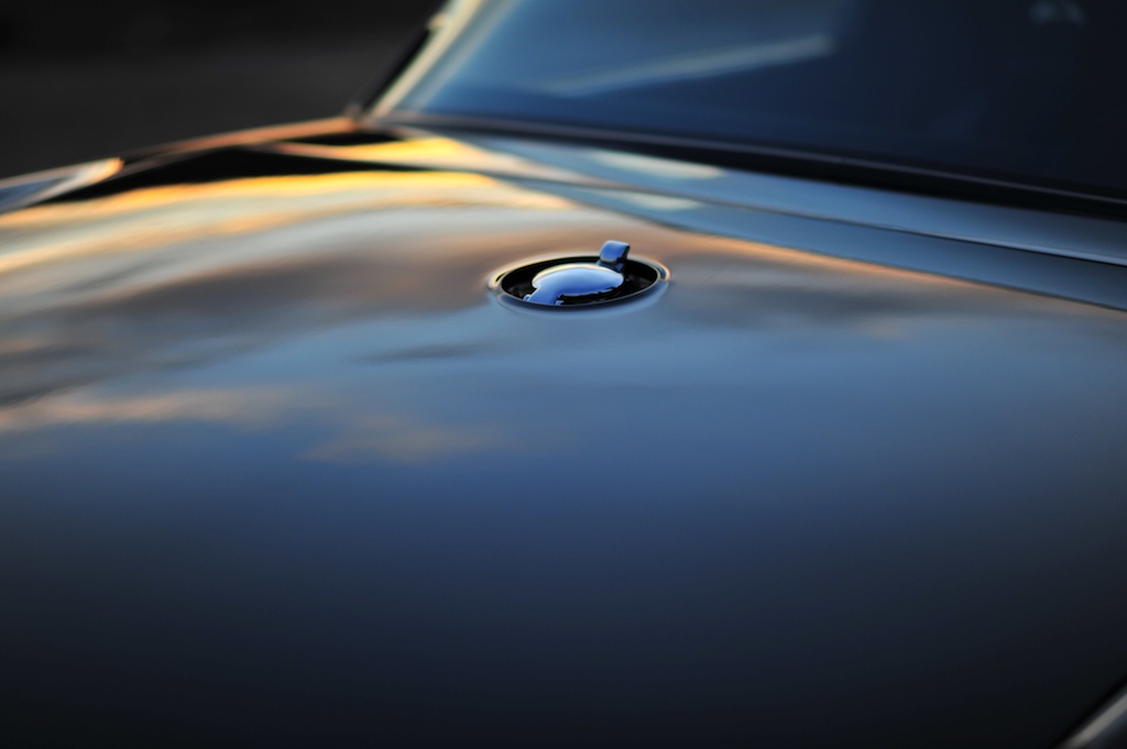

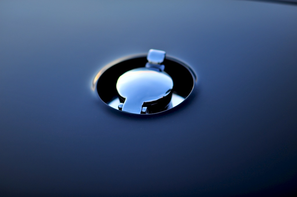

I not only like the look of this mod but adds simplicity to gas fill ups the only negative from my perspective is now gas entry is not protected?

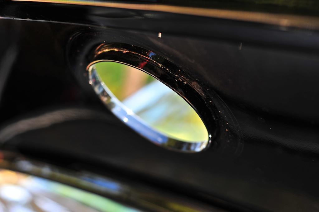

so any one have measurements and close up pics? I am assuming that it is more than just a hole. also probably a ring is welded on hood so as to give a relief even added seal? I think Patrick motorsports has pics in their gallery?

Hood filler on Blackulla. Craig at CAMP

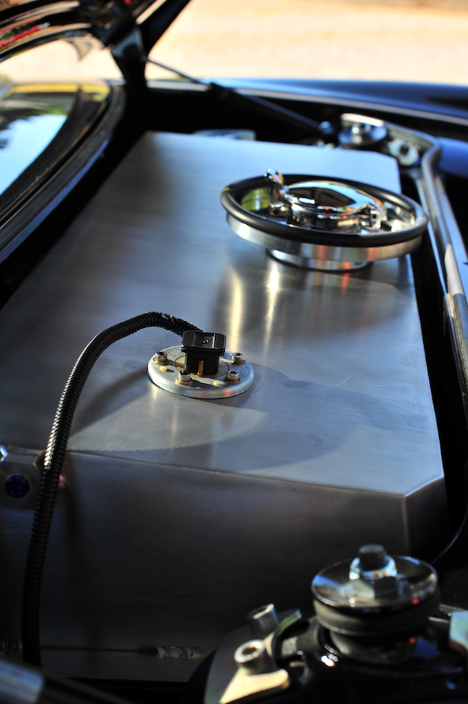

Chief   This is how I tackled the job. I modified the tank...   Jun 13 2017, 06:24 AM
ValcoOscar   This is how I tackled the job. I modified the tan...   Jun 13 2017, 08:37 AM
ValcoOscar   Here's my set up...from GT Werk http://www.gt...   Jun 13 2017, 08:26 AM
Retroracer   To answer your "gas security" question, ...   Nov 11 2017, 11:00 AM
