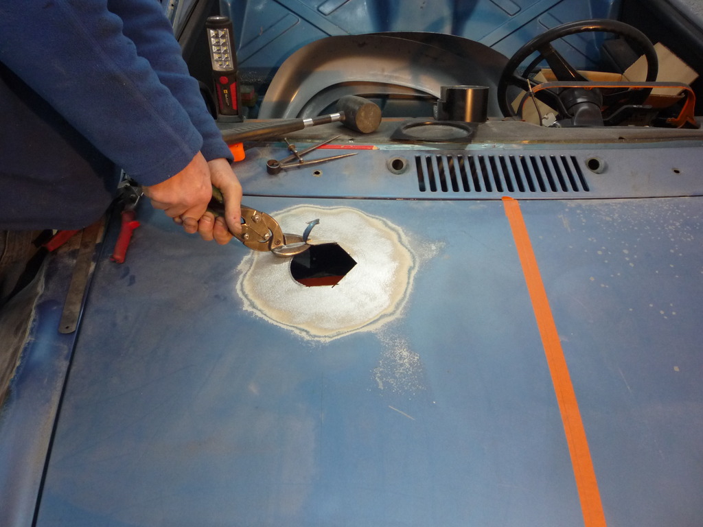

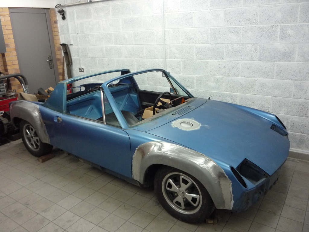

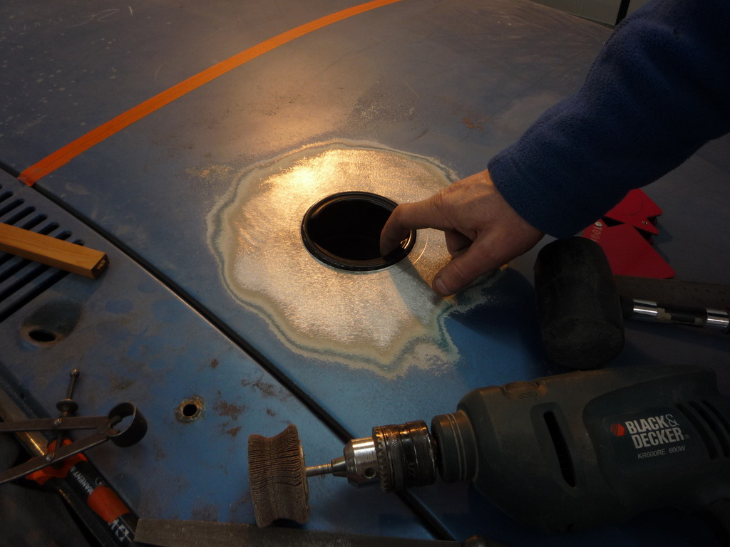

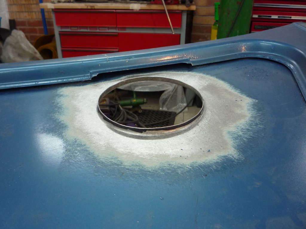

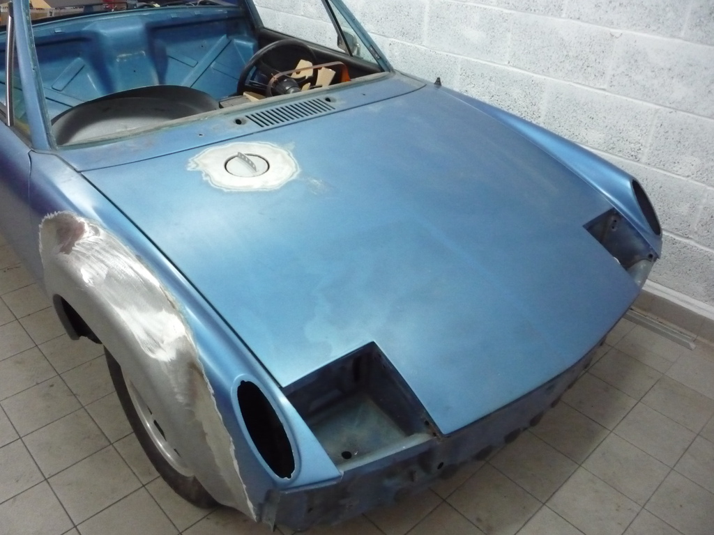

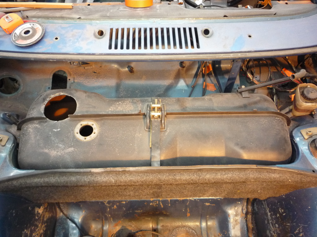

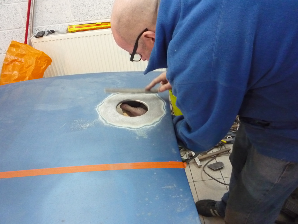

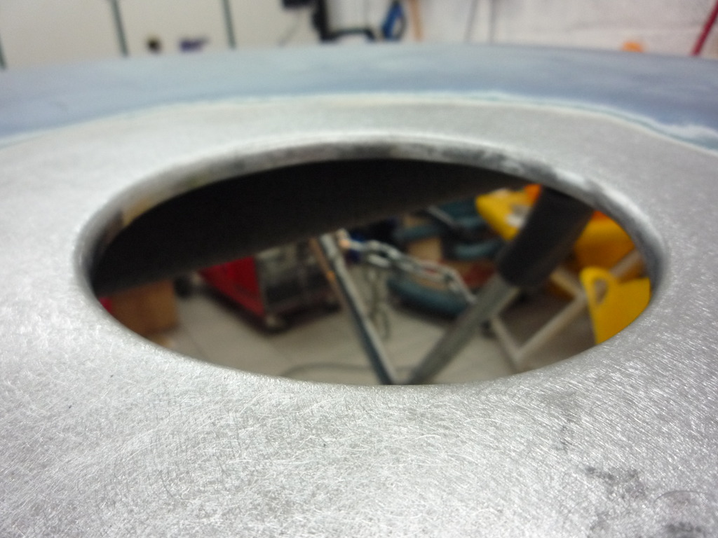

This is how I tackled the job.
I modified the tank to give me the chance to move the filler towards the center line of the bonnet more. The metal was so good to work with we just beat it into submission. I didn't want to weld anything onto such a big flat panel and warp it.
(IMG:http://www.914world.com/bbs2/uploads_offsite/i50.photobucket.com-20751-1497356675.1.jpg)
(IMG:http://www.914world.com/bbs2/uploads_offsite/i50.photobucket.com-20751-1497356675.2.jpg)
(IMG:http://www.914world.com/bbs2/uploads_offsite/i50.photobucket.com-20751-1497356675.3.jpg)
(IMG:http://www.914world.com/bbs2/uploads_offsite/i50.photobucket.com-20751-1497356676.4.jpg)
(IMG:http://www.914world.com/bbs2/uploads_offsite/i50.photobucket.com-20751-1497356676.5.jpg)
(IMG:http://www.914world.com/bbs2/uploads_offsite/i50.photobucket.com-20751-1497356676.6.jpg)
(IMG:http://www.914world.com/bbs2/uploads_offsite/i50.photobucket.com-20751-1497356676.7.jpg)
(IMG:http://www.914world.com/bbs2/uploads_offsite/i50.photobucket.com-20751-1497356676.8.jpg)

QUOTE(Chief @ Jun 13 2017, 05:24 AM) *
I like the way you finished your opening CHIEF....Nice job...
Keep up the good work.
