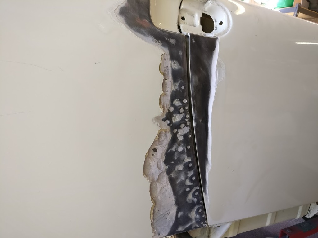

Ever had the sick in your stomach feeling?
(IMG:http://www.914world.com/bbs2/uploads_offsite/i176.photobucket.com-6621-1497597464.1.jpg)

defianty   Ever had the sick in your stomach feeling? http:/...   Jun 16 2017, 01:17 AM
914dave   Nice fab work! From the looks of your skills,...   Jun 16 2017, 06:31 AM
defianty   Nice fab work! From the looks of your skills...   Jun 16 2017, 10:09 AM
914dave   Nice fab work! From the looks of your skill...   Jun 16 2017, 11:00 AM

pete000   That's a lot of plastic on that quarter !   Jun 17 2017, 09:42 AM
defianty   That's a lot of plastic on that quarter ...   Jun 17 2017, 11:14 AM
