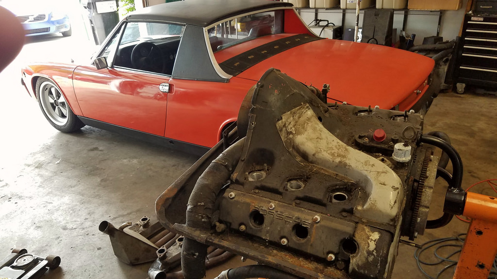

Started the teardown and did some much needed garage cleaning.
(IMG:http://www.914world.com/bbs2/uploads_offsite/c1.staticflickr.com-19709-1497729296.1.jpg)

Optimusglen   Tore down a bit more. #4/5/6 pistons, cylinders, a...   Jul 14 2017, 08:37 AM
