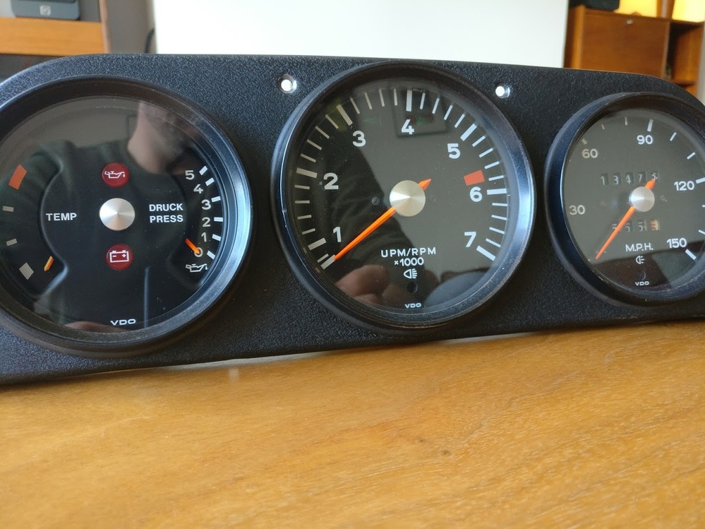

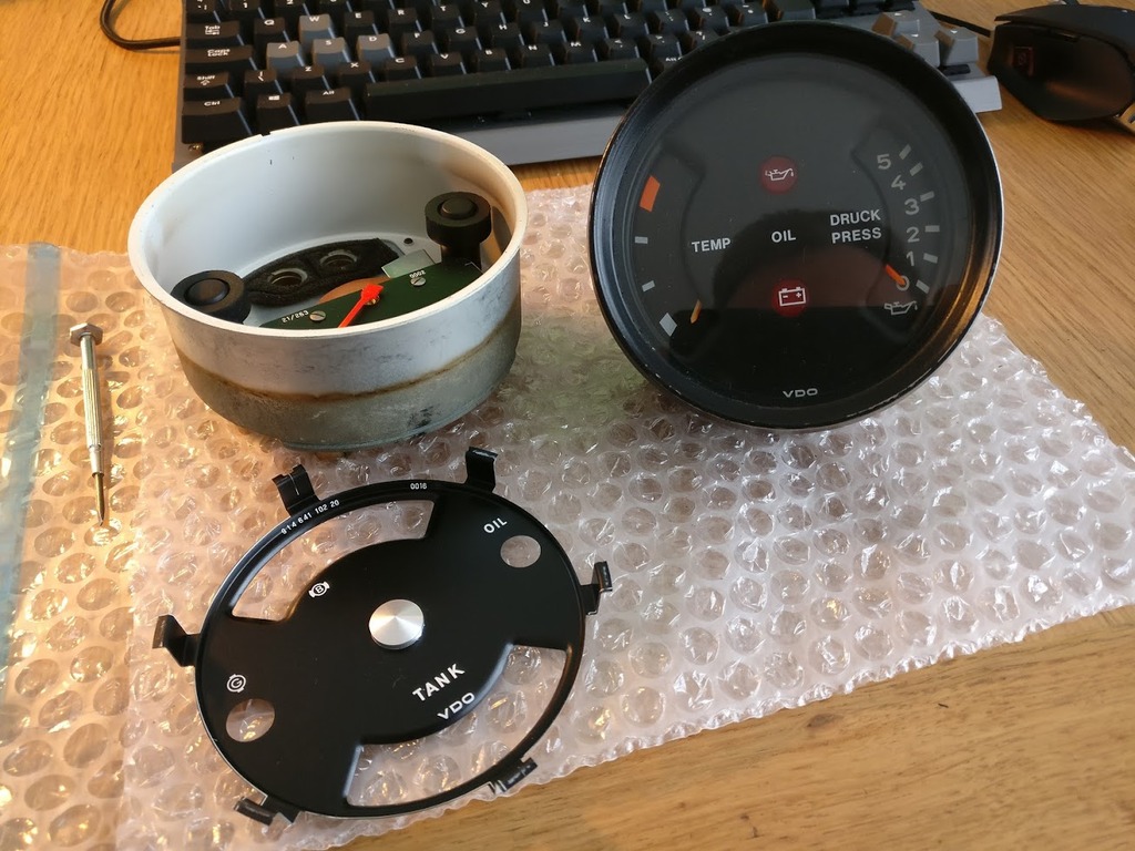

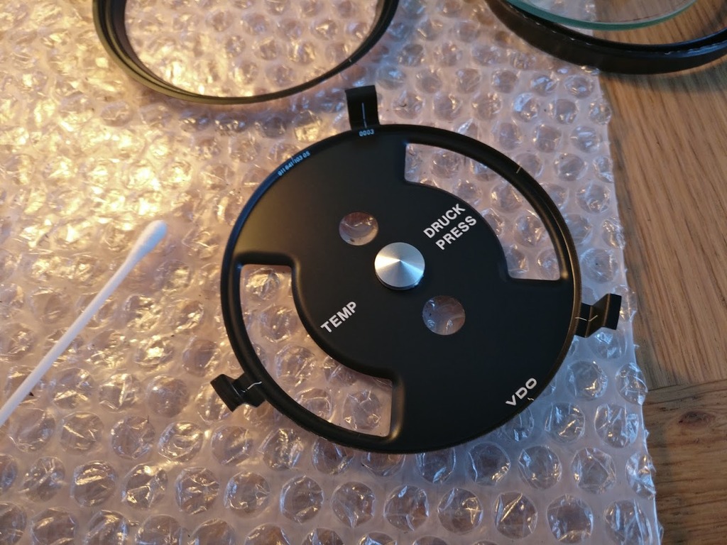

Whilst hiding from the car and it's filler problems I turned to another little project.
I plan on having a very stock interior in my car, most of what was in the car was already in great condition and the few parts the weren't, have been replaced.
The dash and gauges were in a lovely original condition and fortunately didn't need refurbishment. However now having a six cylinder engine I wanted more information on the dashboard.
Being an early 914 the car had silver dot gauges. It's common with six conversions to swap out the large 914 fuel gauge and replace it with an oil temp and pressure gauge from a 911. Unfortunately those gauges are expensive now and I really wanted a cheaper solution.
My engine is a '83 3.0l and more by luck than anything else I managed to get hold of a reasonably priced gauge from the same era. The lucky part being my sender units on the engine were a perfect match to the gauge. The only problem with these gauges is the lack of a silver dot. But not for long.
911 oil gauge on the right and partially torn down 914 fuel gauge.
(IMG:http://www.914world.com/bbs2/uploads_offsite/i176.photobucket.com-6621-1497895097.1.jpg)
Silver Dot from the 914 gauge not stuck on to the 911 oil gauge.
(IMG:http://www.914world.com/bbs2/uploads_offsite/i176.photobucket.com-6621-1497895098.2.jpg)
Reassembled - A trio of silver dot gauges.
(IMG:http://www.914world.com/bbs2/uploads_offsite/i176.photobucket.com-6621-1497895098.3.jpg)
