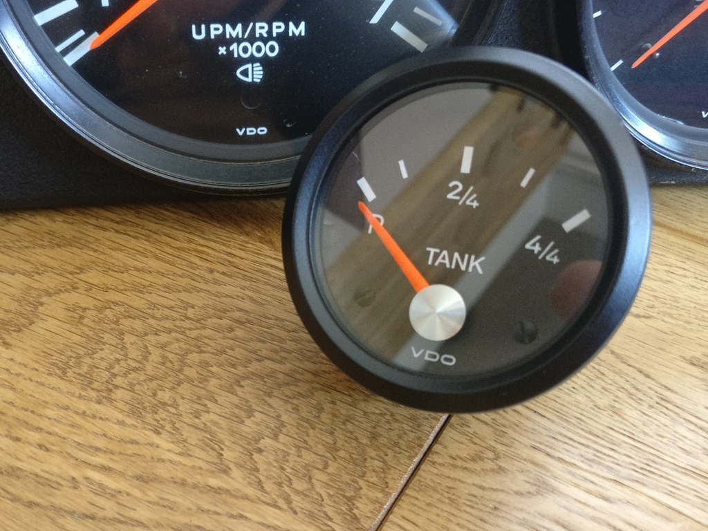

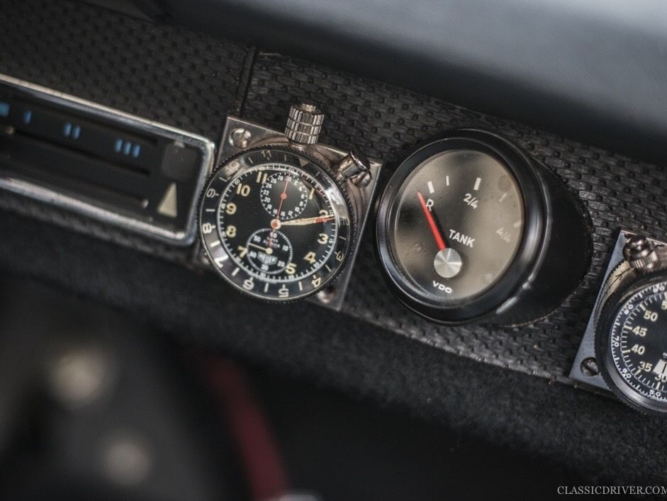

All very well but you may have noticed that I no longer have a fuel gauge!
Some of the GT cars had a gauge mounted on the dash in place of the radio. Here's a picture here you can see it's mounted at an angle to face the driver.
(IMG:http://www.914world.com/bbs2/uploads_offsite/i176.photobucket.com-6621-1497895120.1.jpg)
The last time I saw one for sale it was for an eyewatering amount. Again I had to get creative.

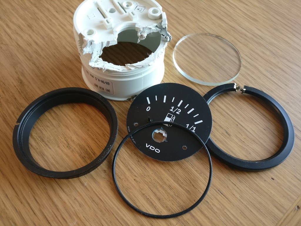

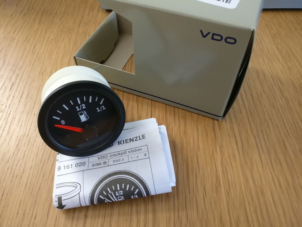

The case of these gauges had a 60mm circumference todays VDO gauges are just 52mm and all have a rather modern look. My first task was to find a 60mm case. VDO has made gauges for many manufactures and in the mid 60's they made this for SAAB.
And look... a lovely silver dot too.

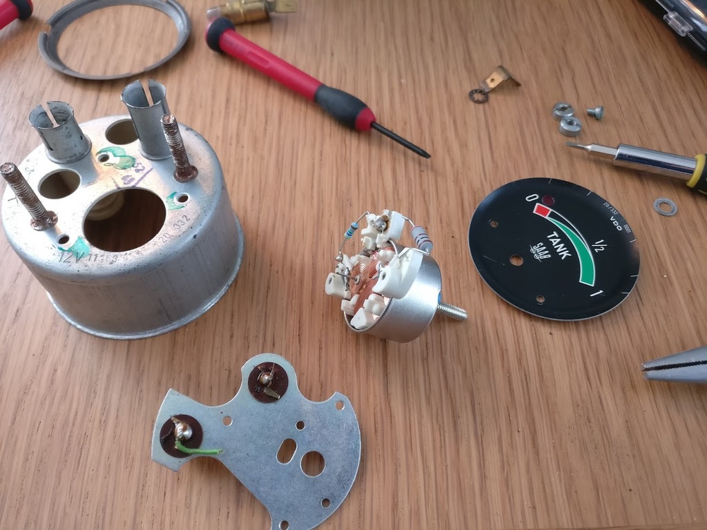

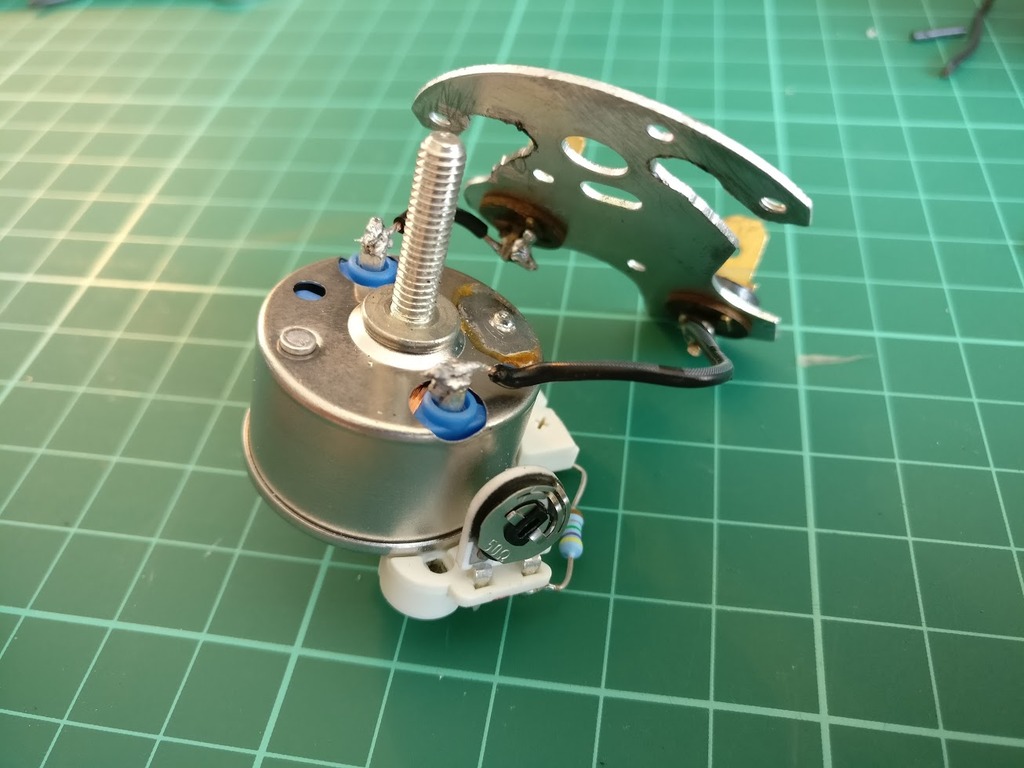

Unfortunately the internals weren't compatible with the 914 sender unit, so for compatibility I got this.
(IMG:http://www.914world.com/bbs2/uploads_offsite/i176.photobucket.com-6621-1497895120.3.jpg)
Now it was just a simple case of merging the two together. :shock:
The really didn't want to come apart!

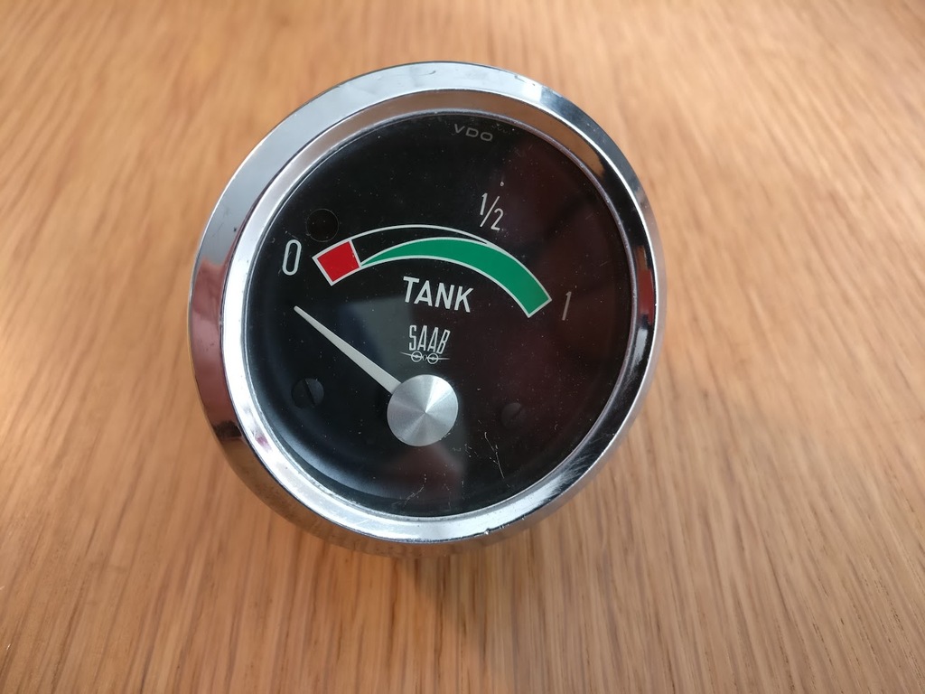

(IMG:http://www.914world.com/bbs2/uploads_offsite/i176.photobucket.com-6621-1497895120.4.jpg)
Saab gauge in pieces with the new gauge internals pictured.
(IMG:http://www.914world.com/bbs2/uploads_offsite/i176.photobucket.com-6621-1497895120.5.jpg)
I wanted to use the original spade connectors on the back of the Saab gauge so that meant modifying the new VDO gauge to suit.
(IMG:http://www.914world.com/bbs2/uploads_offsite/i176.photobucket.com-6621-1497895121.6.jpg)

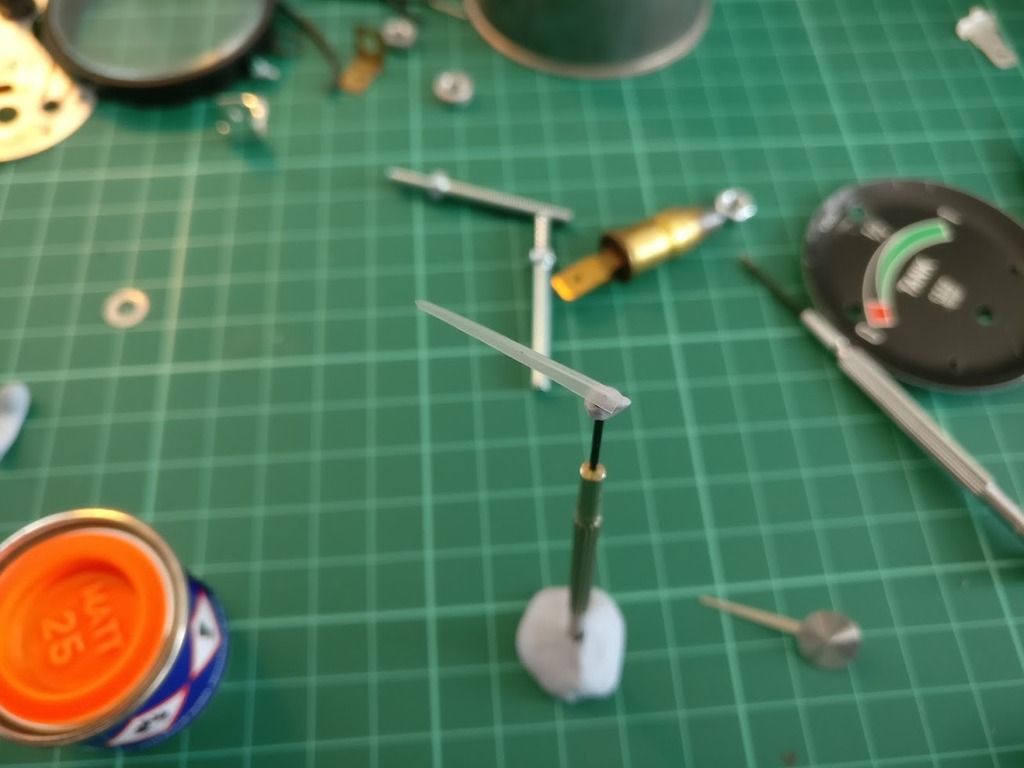

The needle on the Saab gauge wasn't quite Porsche enough for me and it wasn't quite long enough either, so I went about creating a new needle. This was the final version and it was made from a milk jug (IMG:style_emoticons/default/laugh.gif) Yes and milk jug!
(IMG:http://www.914world.com/bbs2/uploads_offsite/i176.photobucket.com-6621-1497895121.7.jpg)
It turns out Revell enamel Matt 25 is a great match for a faded Porsche needle.

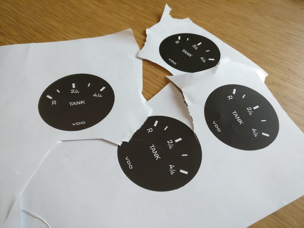

To create the dial I used several images of GT gauges to create a new artwork I could print. These are just some of the early printouts.
(IMG:http://www.914world.com/bbs2/uploads_offsite/i176.photobucket.com-6621-1497895121.9.jpg)
