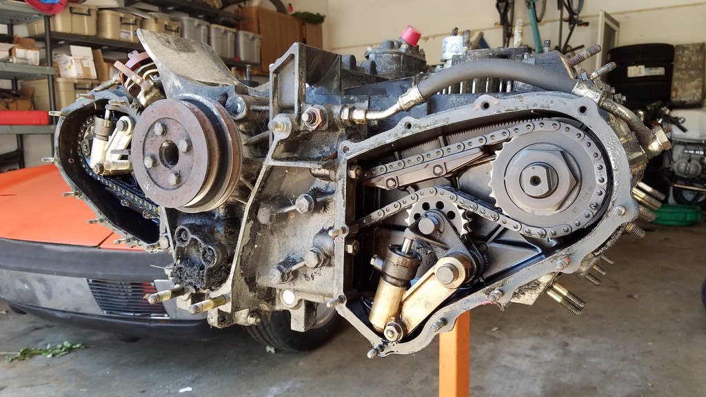

Started a little bit of the tear down. Head studs are all solid, doesn't seem like any have pulled but I'll know for sure once a new tool comes in and I can proceed further.
Chains and tensioners look ok-ish, of course they'll get replaced but I'm thinking there wasn't any catastrophic damage.
All matching spark plugs, good sign. Gasket sealant on the chain covers, someone has been in here before. Port matched heads to intake gaskets and presumably the carbs.
Lots of gunk and build up in the cylinder cooling vanes. Overall it's just very dirty. My cup-o-tea.
Been bagging and marking all of the fasteners, should make reassembly a breeze.
