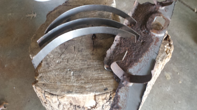

These dang spring clips... Someone suggested that I cut the ones out of my bad long and just weld them into the new long. Problem being that two of them were completely gone, rusted away entirely- just sad little stumps.

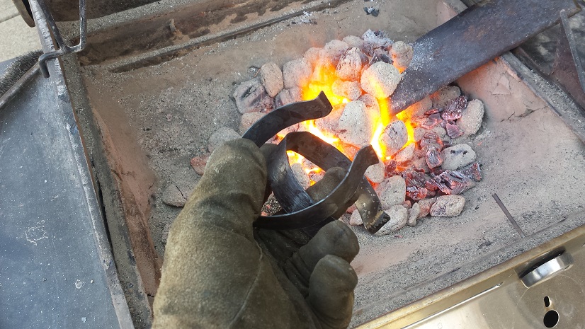

They look like they would be easy to make, but as I'm checking out the one remaining one, I see it is spring tempered. I have a buddy with a forge and talked to him about making these... cave-man garage work.
Made the pieces out of basic cold-rolled, there's the one remaining clip from what's left of the original long:
Here's the clips, cut and shaped but not yet tempered. If you squeeze them a little, they just stay bent, they are not springy at all.

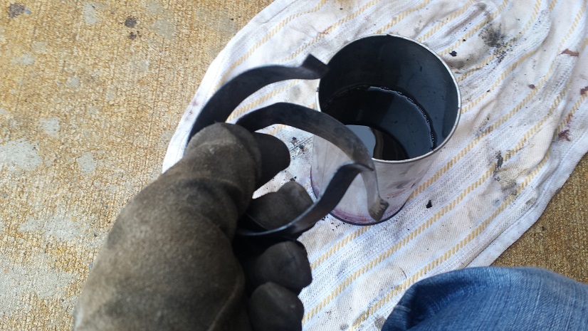

Into the forge they go. Heated to cherry, quenched in old motor oil:
The annealing process, per an old book I have, says burn off the oil, then dip in oil again and burn it off again, then do that one more time and you have a spring temper.

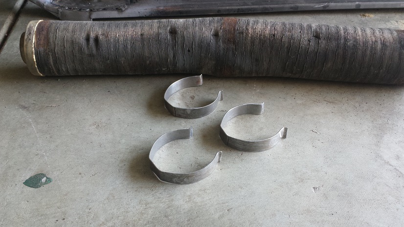

Worked like a charm, you can snap them and they vibrate like a tuning fork. Test fit everything with the tube, the long, and the elbows on either end. Hit them with a little weld-through primer and tacked them on.
