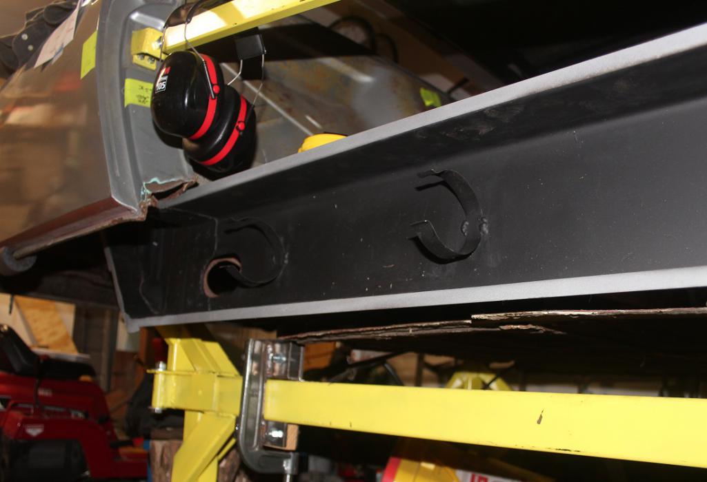

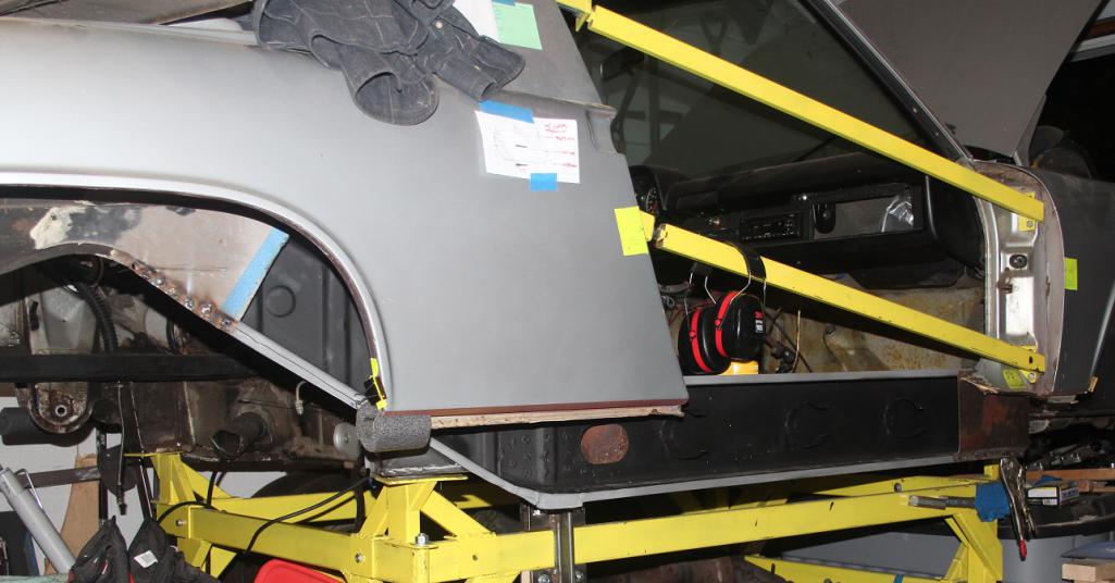

The new long is tacked in place. I keep measuring the door gaps over and over, I feel like a nervous mom. I'd be lying if I said I wasn't more than a little excited about this, it feels like a pretty big step forward. The next couple pieces from RD to close it up will go quick I think. Then we'll flip it around and do the other side. Less to do over there, but then it will have good bones again.

Sweet, They look great,
Im about* to rivet mine on one side, maybe I will just tack them like that.
