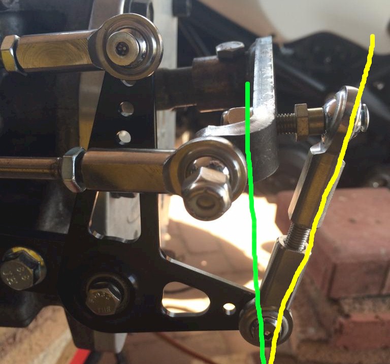

someone mentioned they thought this angle might make shifting less smooth.

jimkelly ian's pic placed here Jul 1 2017, 05:00 AM
jimkelly more Jul 1 2017, 05:00 AM
