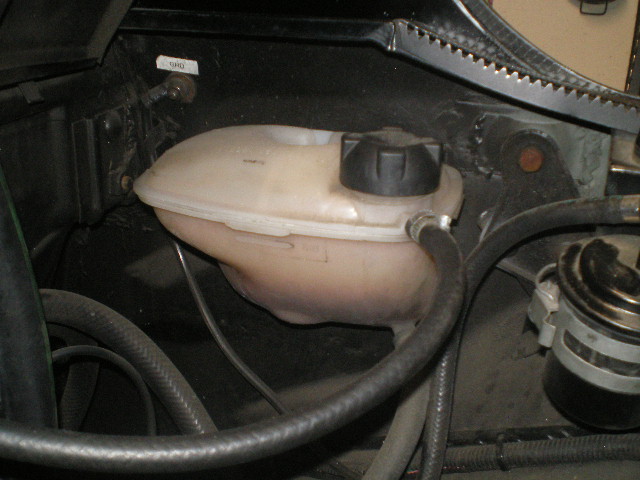

For cooling I purchased the renegade "kit" which consisted of a radiator and some metal shrouds. When the car comes back from the electrician this is my next job to install. Which brings me to question 2. Does anybody have any pictures of their install for the coolant expansion tank? I am thinking of mounting this where the old fuel injection relay/fuse box was as it's probably the highest point in the car and should make bleeding easier.
Also is anybody running their coolant piping along the old heater ducts? is it possible to feed the hose through there?

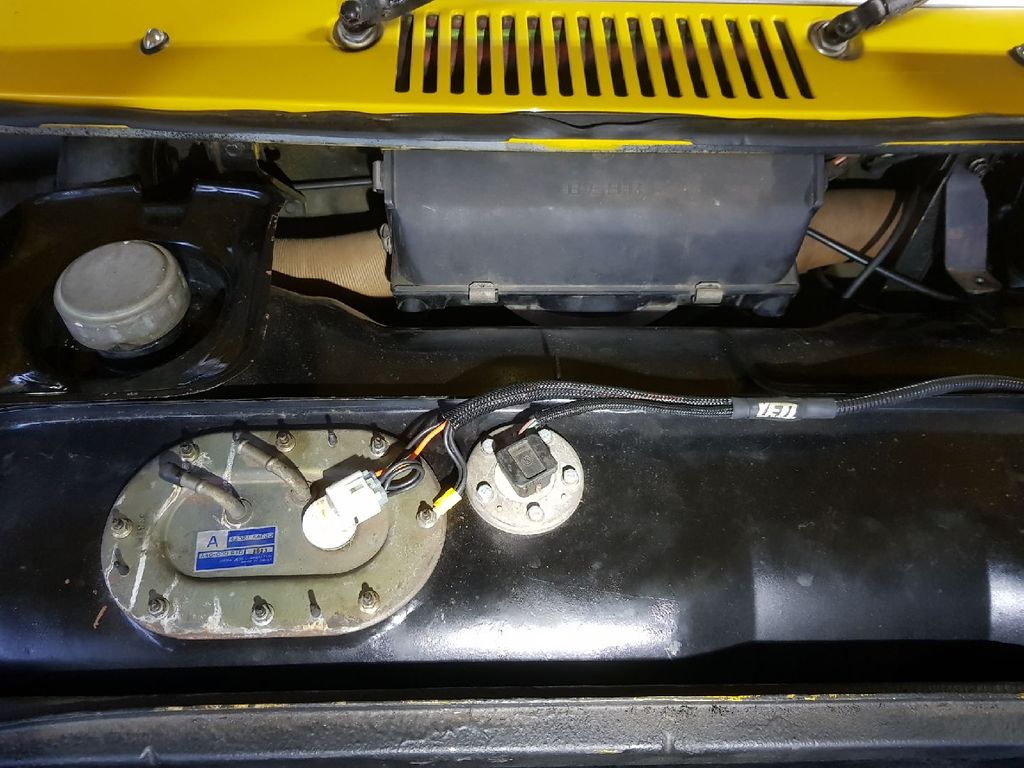

The fuel tank has a Subaru pump assembly with a Walbro pump. I had one of the local Subaru specialists cut out the section that holds the pump and then graft it into the 914 tank. This way it looks like OE but also should keep the fume at bay!

Yes you can feed the coolant lines thru the heater tubes. Look at my build thread ( http://www.914world.com/bbs2/index.php?showtopic=201776 )currently on this page. It details how to run them. Also there is a pic of the exp tank mount. beerchug.gif

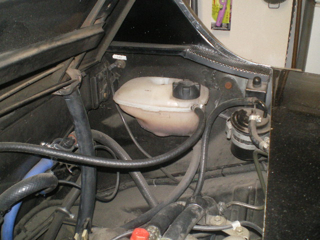

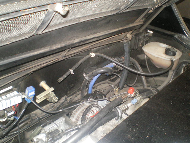

Kent your thread is a fantastic. Your fabrication work puts me to shame. I'm only about half way through as my internet is playing up. It looks like putting the piping through the ducts works well. Is there anything you'd do different?
Can you take some pics of all the piping that goes to the expansion tank. In your pics it looks like it sits beside the fuel tank but i can't work out how that plumbs to the system.

Here you go Ian. I'm currently changing things up. The filler neck and cap are dead center on the firewall when installed. That 5/16" goes from the filler neck blow off to the exp tank. You can see it hanging there in the pics. The bottom of the exp tank has a 1/2" line that goes to a T on the intake line about 6" from the thermostat. beerchug.gif Kent

A quick update. The front harness is coming along nicely.
I'm using the 914 sender and gauge but the Subaru pump.
IPB Image
jimkelly
