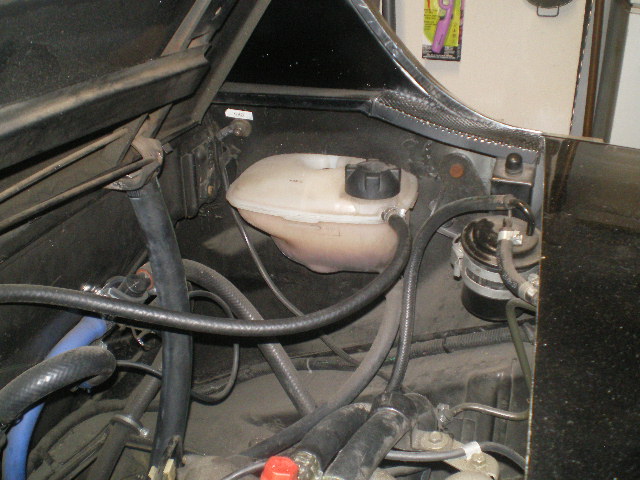

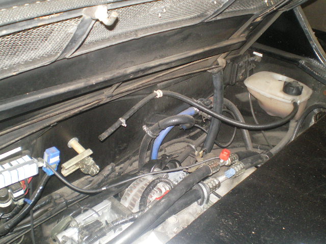

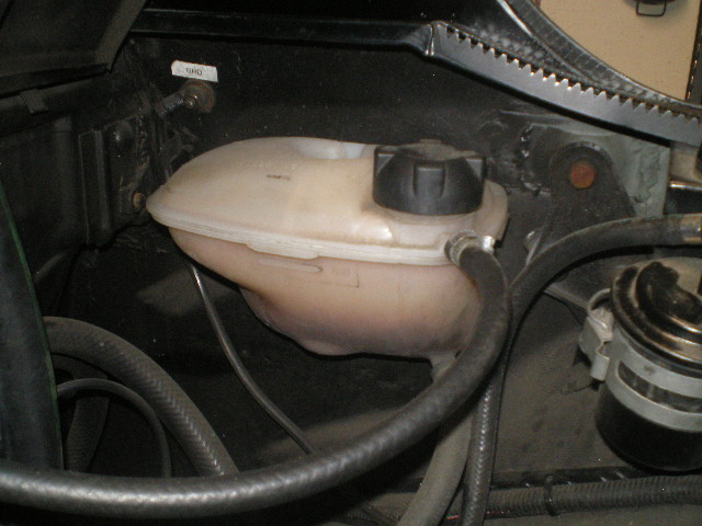

Here you go Ian. I'm currently changing things up. The filler neck and cap are dead center on the firewall when installed. That 5/16" goes from the filler neck blow off to the exp tank. You can see it hanging there in the pics. The bottom of the exp tank has a 1/2" line that goes to a T on the intake line about 6" from the thermostat. (IMG:style_emoticons/default/beerchug.gif) Kent

Thanks Kent. It looks almost factory with the OE fuel filter sitting alongside it.
Looking at your location I think your climate is similar to mine. My major paranoia is overheating. I'm thinking of putting the water to air intercooler on the firewall in the engine bay to minimise air flow blockage up front. I figure if some folks can run their main cooling radiator there with minimal problems then it should be enough to keep my charge temps ok. I'll hopefully get the car back next week so I can start cutting up front and measuring all the pipes. |

Thanks Kent. It looks almost factory with the OE fuel filter sitting alongside it. Looking at your location I think your climate is similar to mine. My major paranoia is overheating. I'm thinking of putting the water to air intercooler on the firewall in the engine bay to minimise air flow blockage up front. I figure if some folks can run their main cooling radiator there with minimal problems then it should be enough to keep my charge temps ok. I'll hopefully get the car back next week so I can start cutting up front and measuring all the pipes. Now that I'm gutting everything, if you were State Side I would send you all of my 2 year old pre-cut lengths of hose pieces for the cost of shipping. The Subaru is a very efficient engine, cooling wise. You won't have the overheat issues that many of the SBC crowd experience. Looking forward to seeing your conversion come to life. (IMG:style_emoticons/default/beerchug.gif) |
